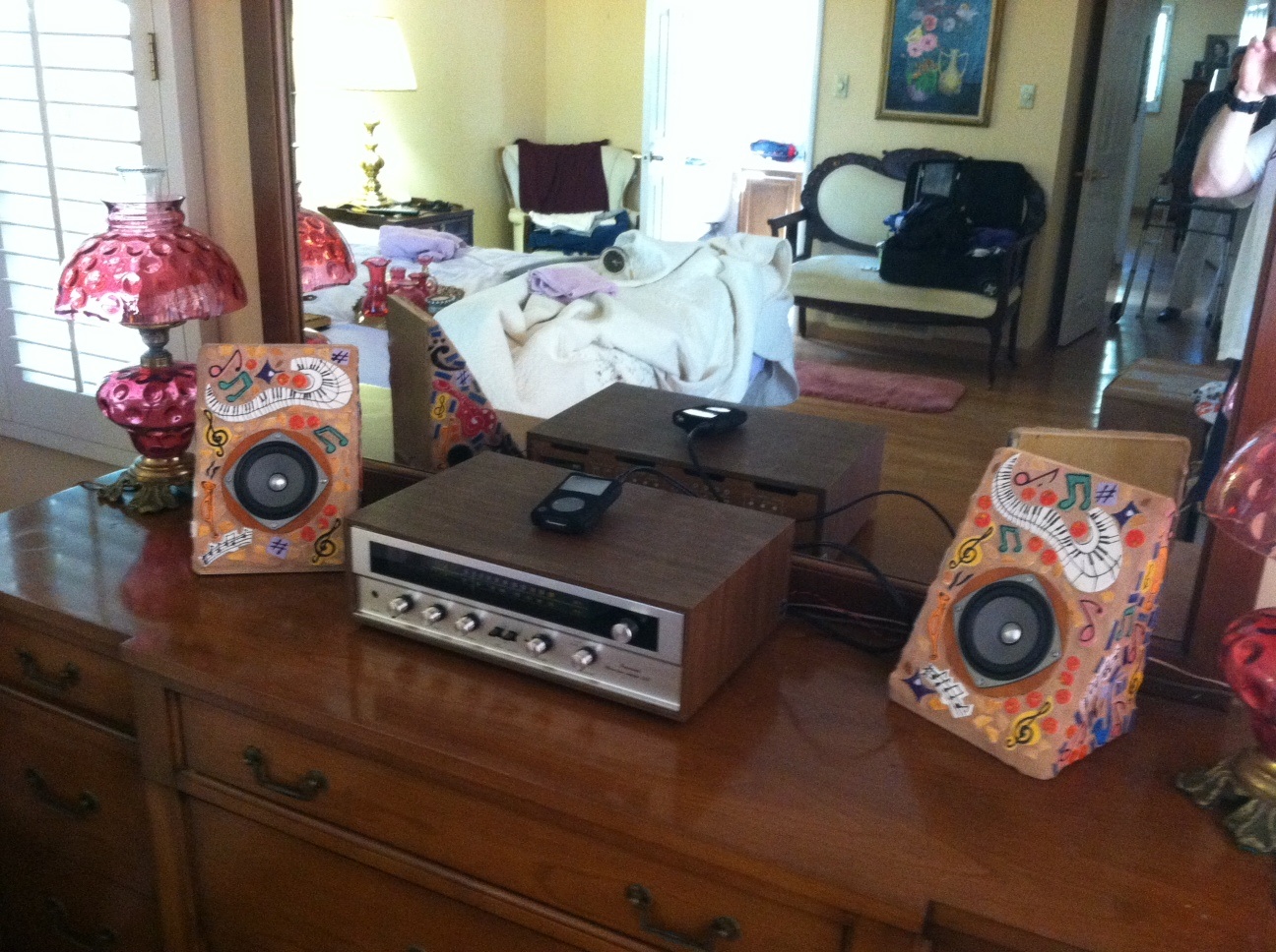

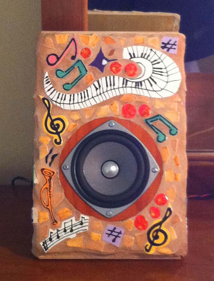

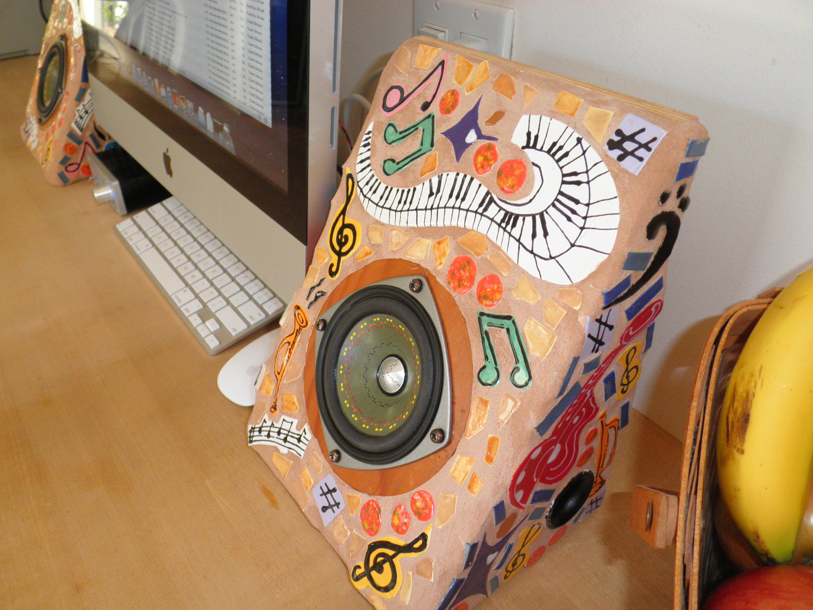

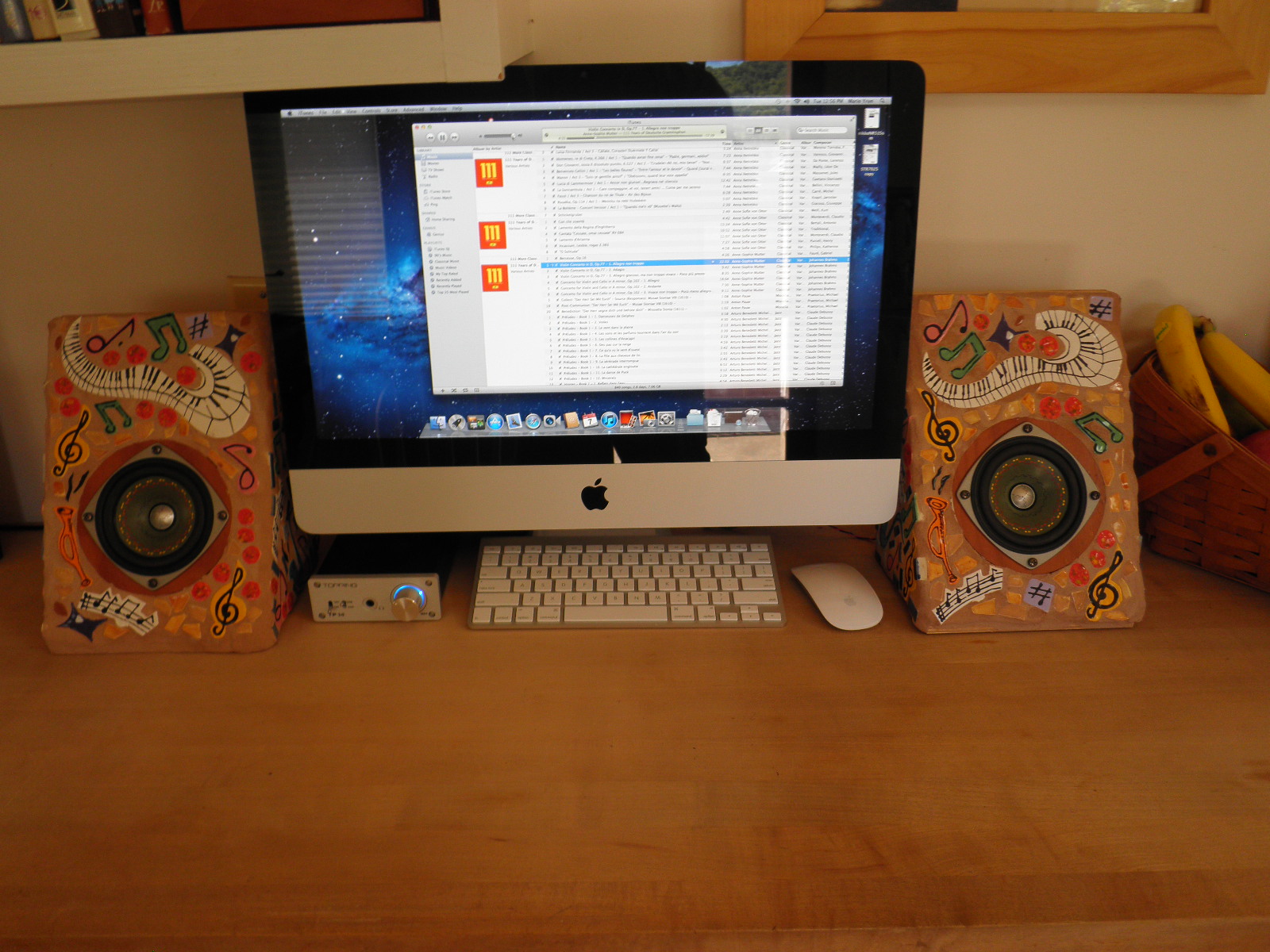

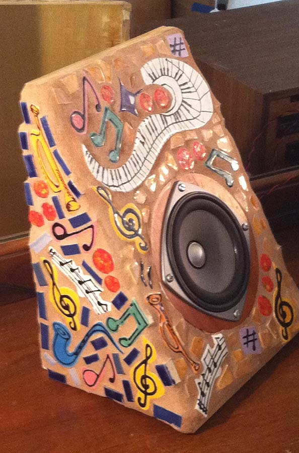

The primary design objective was to have a pair of FR speakers for either side of a computer screen that would look cool, fun and unique. As the home already has several quality audio systems, audio quality priority ranked below aesthetics.

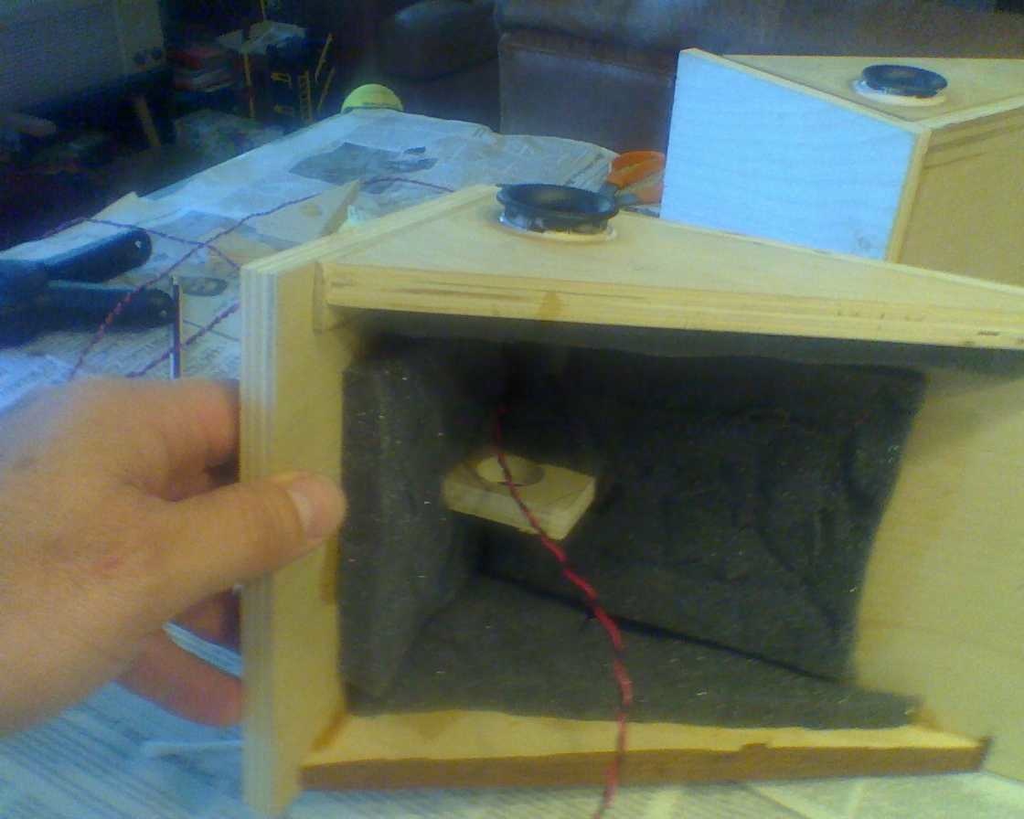

To be powered by a USB DAC/T-amp from a Mac, these triangle cabinets are made from 1/2" BB ply and are little under 3 liters, aprx 10" hi in back, 7" deep and 7" wide and use fostex 103wk's. The mirror-image pair have an inward facing 1" x 2-3" port which if I remember correctly was tuned to around 100hz.
They have a 1/4" baffle ring on which to mount the drivers to allow a surrounding 1/4" - 3/8" ceramic mosaic tile. I asked my sister Cindy, an accomplished ceramics/tile artist, if she would indulge this pair with something "fun, musicky and lots of colors" and from my perspective, she absolutely nailed it!

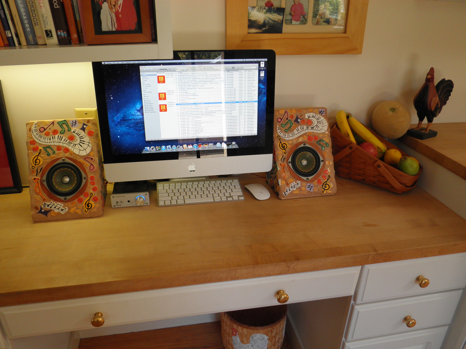

They sound much better than I expected; I believed going in that ceramic tile mosaics aren't known for their acoustic properties. They aren't home yet but there is a photo with a restored Sansui receiver to provide size perspective. This was great fun and these will be gracing our Mac on a butcher-block counter up against the wall. As usual, these were much more work than I or Cindy had expected but I'm ecstatic with the results!

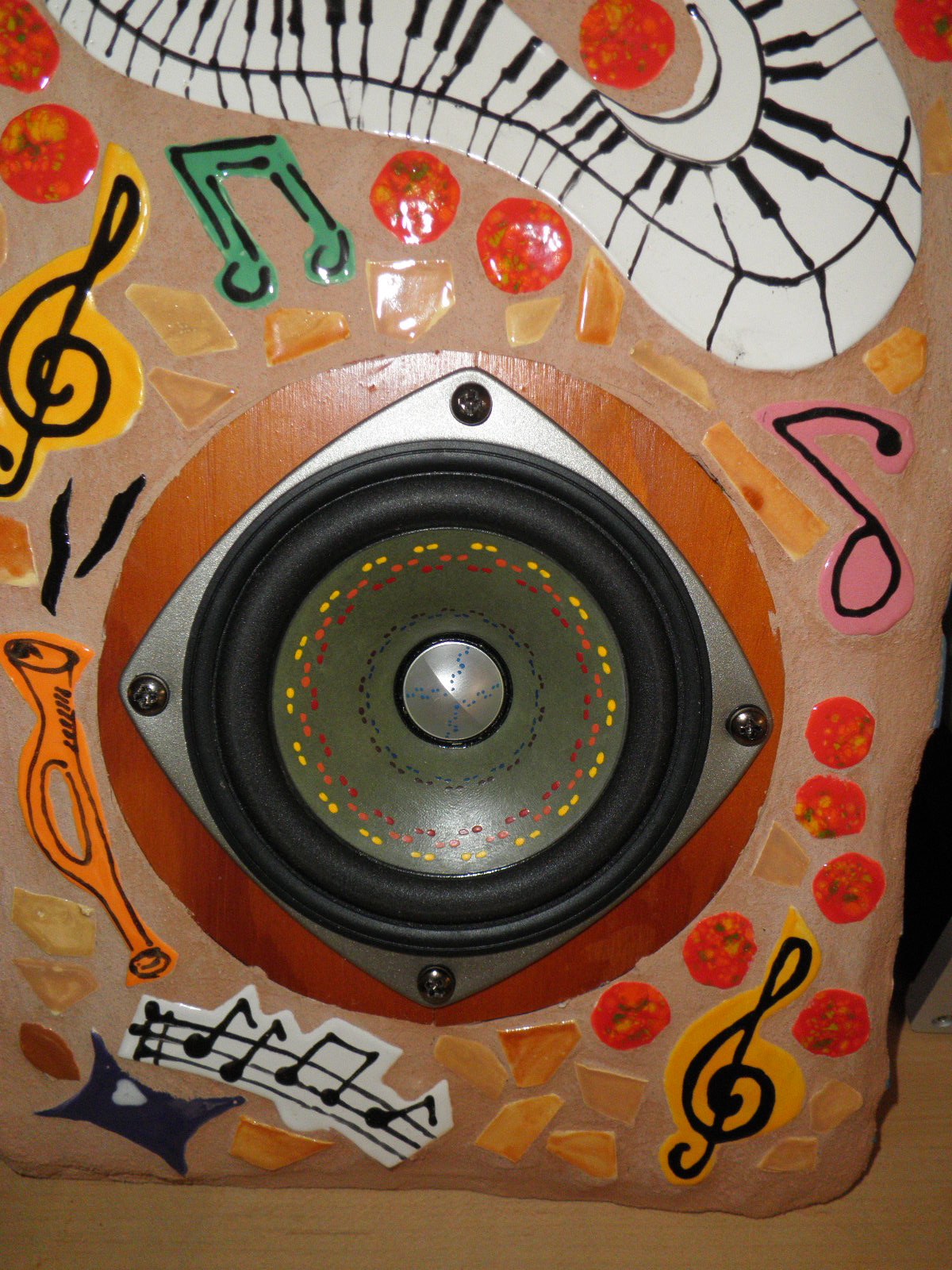

Those are very cute Mario.
I corrected the title, the driver is FF105wk.
It should also be noted that the ridge is supposed to be vertical, your "diamond" mounting will be counter to this.

Thanks Dave, I appreciate your comments. I mounted "diamond" to better hide the vertical split between the two semicircles that make up the raised baffle circle.

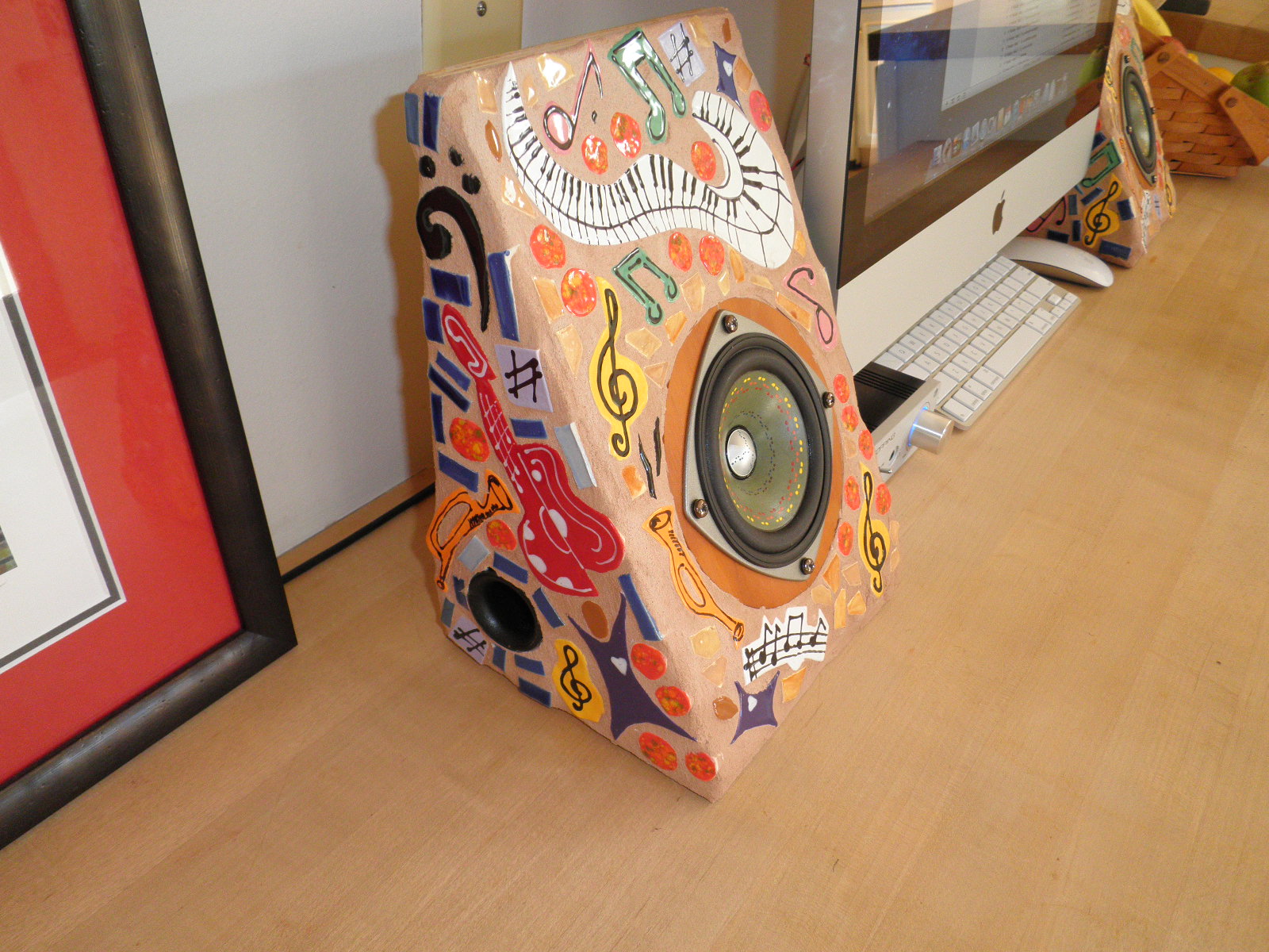

Despite my initial trepidation of colour on the FFs, it turns out that, as long as you don't want something real bright, they can take colour really well. My favorite so far are the dusty orange in my uFonkenSET with the burgandy/marroon not far behind. I suspect blues, greens, and other primary colours should work well too.

these photo's don't quite do justice to the depth of the color attainable - it was certainly not on Fostex's list, but I think the grey surface of the new dual layered cones WK series make for some very interesting colors

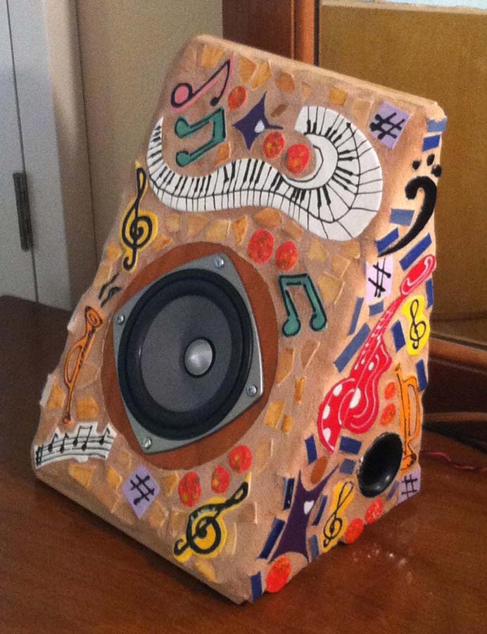

Ceramic wedges w/ P-10 FF105wKeN
P-10 did a great job of customizing a pair of FF105wKeN for my wacky ceramic wedges. While I didn't A/B vs the original FF105wK seen above, these sound surprisingly great in this location and they're really cranking old Miles Davis as I type..... Thanks Dave!

PS: I plan to mount the drivers horizontal instead of current diamond mount as soon as I refinish the small circular wooden baffle to hide both the current screw holes and the vertical split in the baffle.
