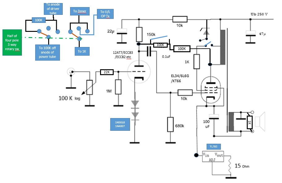

This is how it stands now..
Switch positions..
The UL position now has no RH feedback so,
Position 1 is RH with 2X100K for 7025/83/82/12AX7 etc
Position 2 is U/L with no RH feedback running all tubes..
Position 3 is RH with 100K for ECC81/12AT7
Cathode F/B and + CCS with diode bias for driver..it seems to work well at the moment..more playing to do..some 22K Tantalums on order for the input resistors and a Silmic 2 cap for the cathode FB just to test..
1K fitted across output for family plug and play protection.
Regards
M. Gregg

Just for interest,
I changed the 1K resistor across the speaker output connectors to a thick film 5W and I am convinced it sounds better..Yes I know..It doesn't need to be high wattage..and the type??
I have had the same thing in the past...it looks like this..I just soldered some solid core onto them and connected.
