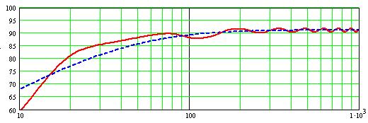

this looks pretty smooth
The design so far has its acoustic impedance at around 20Hz, and the attached file (FField TL SPL Response) shows the sloooooow rolloff.
There are a few design problems left, but if I stopped modeling right now, I'd end up with a heck of a T-Line system.
That is, unless I'm completely blind to something obviously wrong with the idea.
Thanks Martin,
Dave
Hi Dave,
Couple of points :
1) My goal is to take the risk out of TL design using the MathCad worksheets. So far I have always had very good correlation between calculated design and finished speaker. Since a TL has an number of configurations that will yield a similar reponse you can be more creative, hopefully that is what you ment to say.
2) You have tuned your TL very low, which is OK assuming that you have measured your driver's T/S parameters. If you are using spec sheet parameters you might want to hedge your bet and tune a little higher. Most manufacturers seem to tilt the specs a little towards lower fs values. I would probably tune your TL a little higher anyway, but that is just my taste.
3) It looks like you are using the "TL Open End" worksheet. If you try the "TL Offset Driver" worksheet you can further smooth the ripple by placing the driver at about 1/3 of the length from the closed end, assuming a straight pipe. Your ripple looks very small but you might do a little bit better.
But overall the design looks good based on the plot you have posted. I'll be interested in hearing how it turns out.

Martin,
You're correct. 20Hz is a little ambitious, I think, and unecessary. The manufacturer's fs is at 35, and I doubt it actually resonates that low in "real" life.
But I always get confused at that point. The joy of all this is the "relativity" of the whole thing. Thanks to the mathcad production you have for us, I can get a fantastic design even if it turns out not to be dead-on accurate for me, an amateur.
I'll only tantalize you by saying that I'm going to use some ideas I got for other resonating objects to design this creature.
Stay tuned!
Dave
