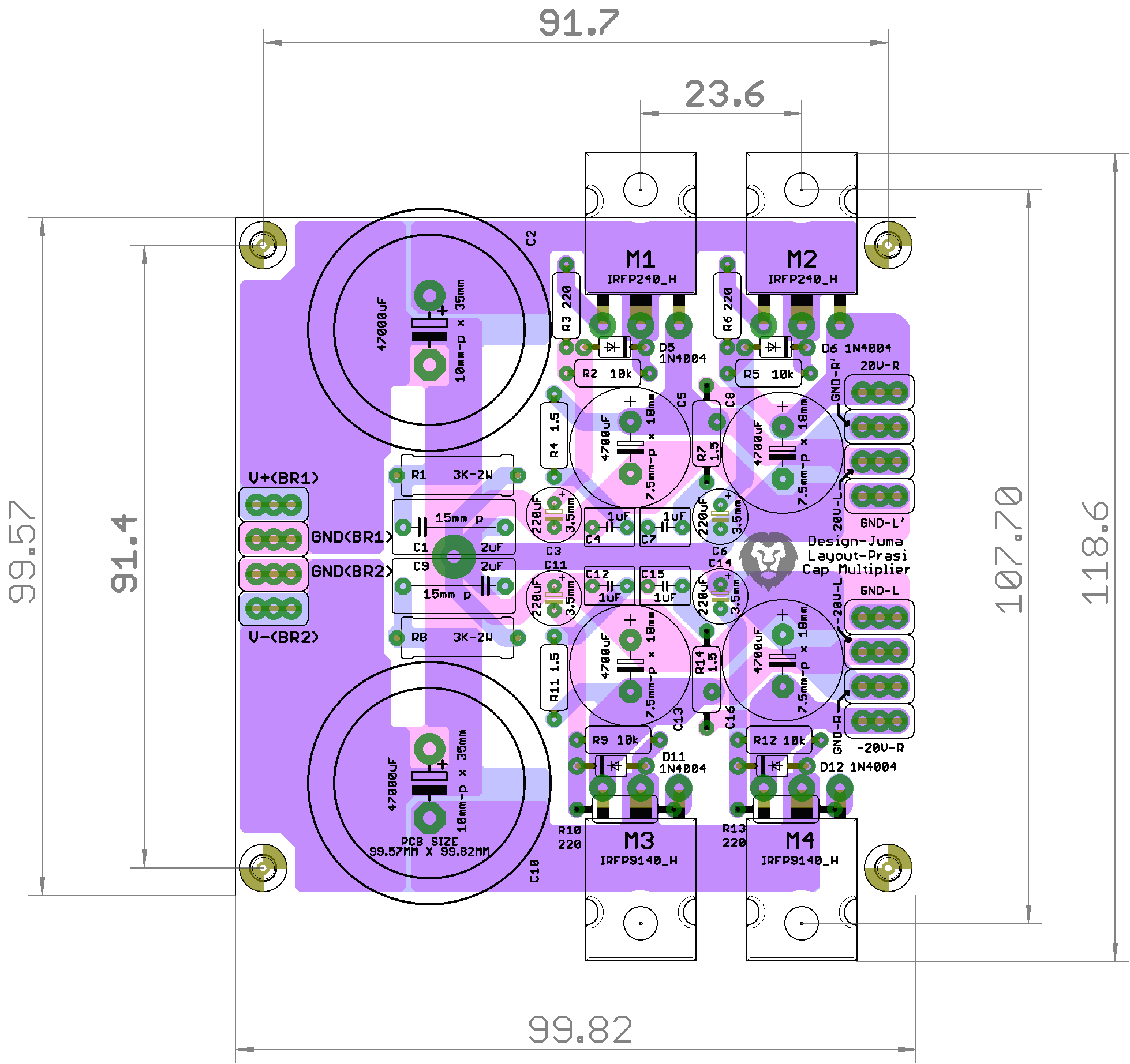

One option is to use an external monolithic bridge (center bolt with 4 spades), in which case we could add some clever jumpers at the appropriate diode holes and connect the DC input to the AC spades. But for Class AB operation, the setup as is will be just fine.
Here is an option with just removing the diode bridge and keeping everything same. As you mentioned, the diode bridge can be external '35A chassis mount' ones. Although this arrangement can be made with earlier layout as suggested by you.

Very neatly done, Prasi - and all inside 16 sq inches!
I wonder what "ammel'" has in mind regarding some changes?
Maybe next time, move the central ground point to the output away from the charging caps and their 'noise', particularly for the filter caps - this then becomes the new 'central ground point', not near to the diode/ripple cap point - a bit of a contentious point in some circles, I think
Maybe also, could shift a couple components to mount underneath (or 'piggyback' a couple [ie, R1 and C1], or SMD some larger size resistors) to free up enough room for the return of the AC snubbers, and maybe leds for 'working' indicators ...
Just saying, no criticism

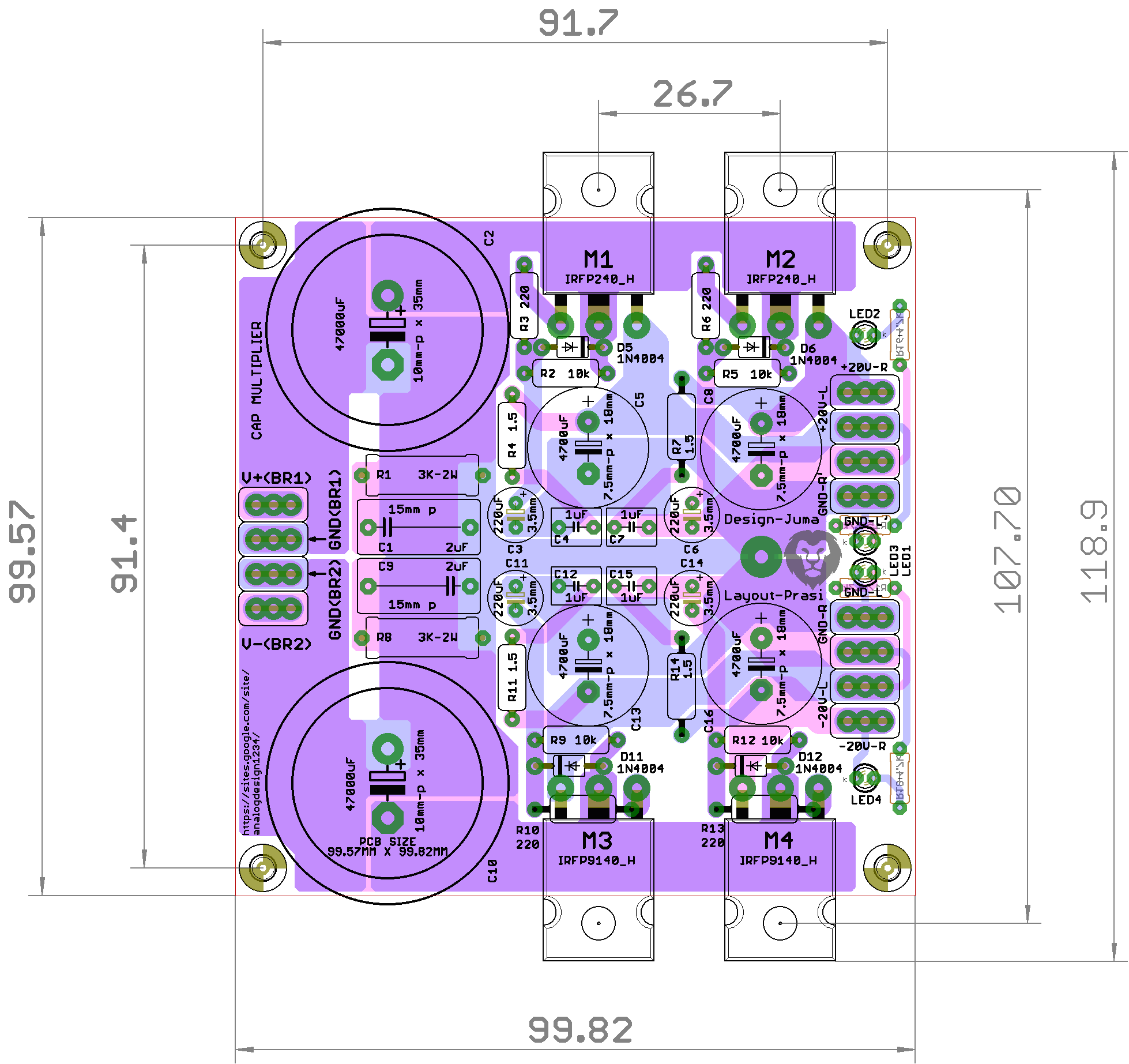

HI James,
Thank you for your suggestions. Reworked the layout, see attached. Is this what you are suggesting when you say 'move central gnd to output'. By moving to o/p side, It now almost looks like a proper layout for LM317/337 type ckt. Should cap multipliers too should get their ground reference from o/p?
Added 3mm LED indicators, with smd resistor on bottom. I am trying to avoid SMD especially high power components (R1/R8) as they are not easily available locally.

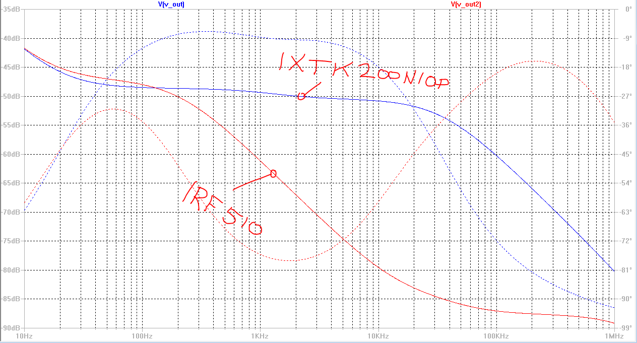

MOSFETs with low RdsON always have higher parasitic capacitances than FETs with higher RdsON. Since you are not operating with the MOSFET in the 'ON' state, but rather linearly, the RdsON is pointless to use when selecting FETs.
Tho this is a follower, the high capacitance of a powerful FET such as IXTK200N10P will give poorer attenuation with frequency than a light-weight FET such as IRF510.
Todays FETs are unfortunately made to switch fast in SMPS service and are not as good in linear circuits (such as for pass duty in regulators). Even todays IRF610s or IRF240s are probably not as robust as same parts 10years ago. But they switch better.
I'd look for low capacitances and large package when selecting FETs for this duty.

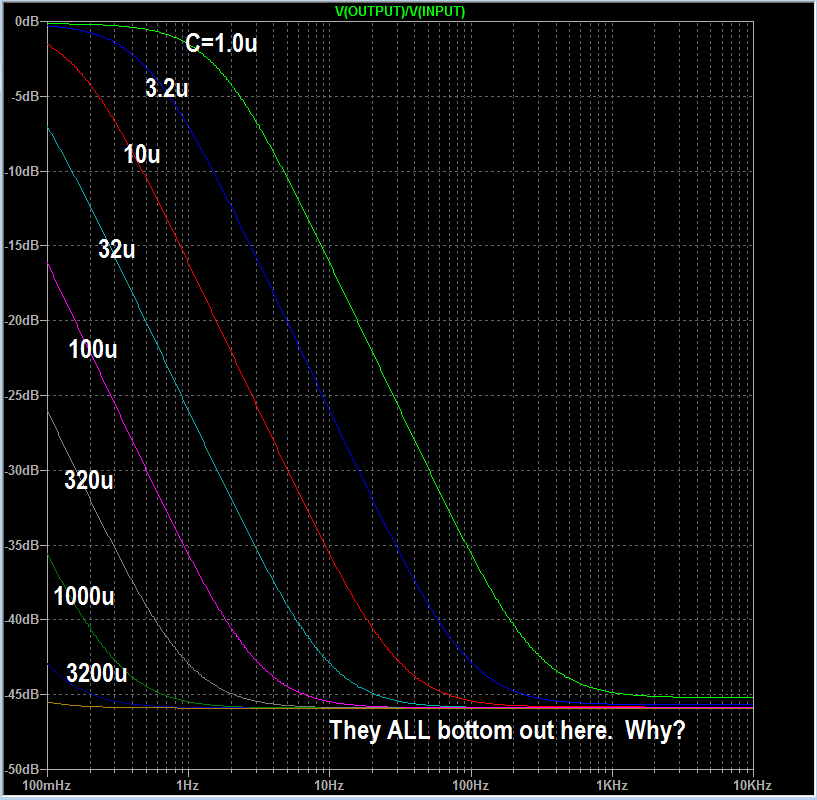

First do an analysis and discover why some of the sinusoidal input, finds its way onto the output; why isn't there infinite attenuation?
You might determine that infinite amounts of bypass capacitance on the MOSFET gate, does not translate into infinite amounts of attenuation (figure 1). Or, you might discover that I am completely misguided and totally wrong. If so then my claim "cascodes make it better" becomes highly dubious.

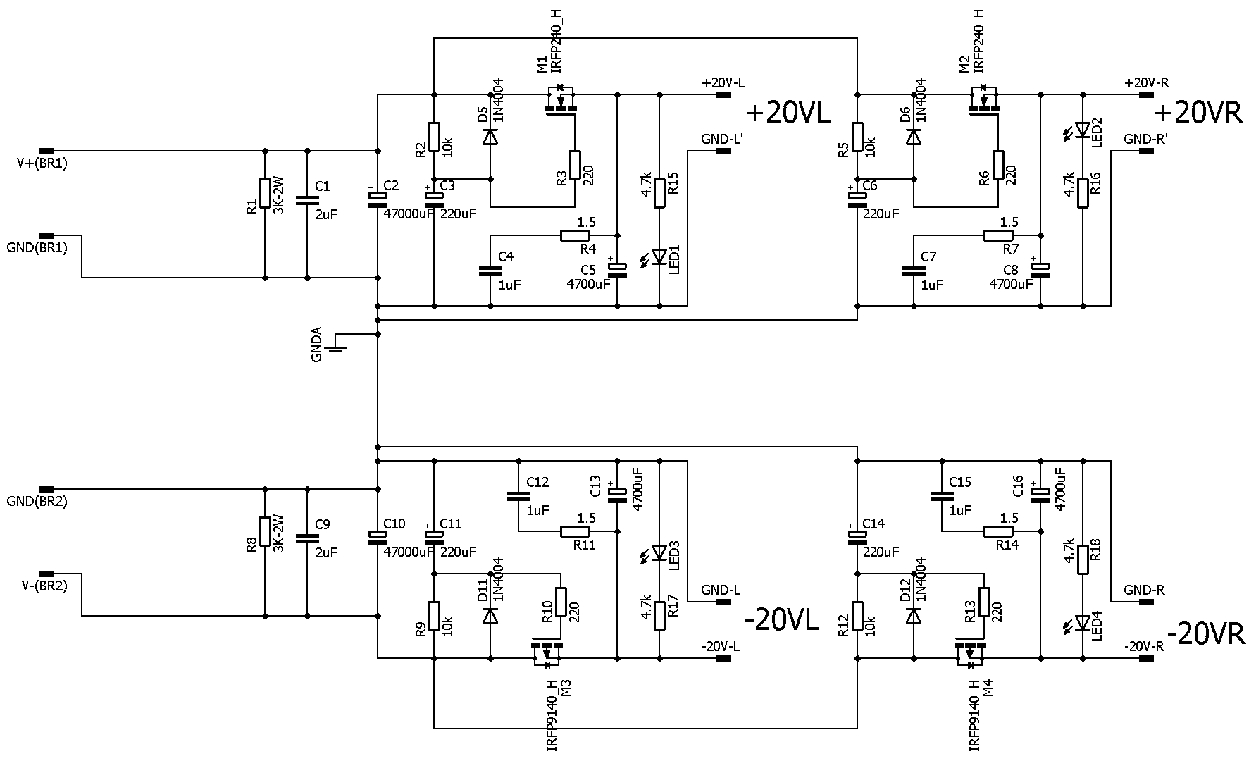

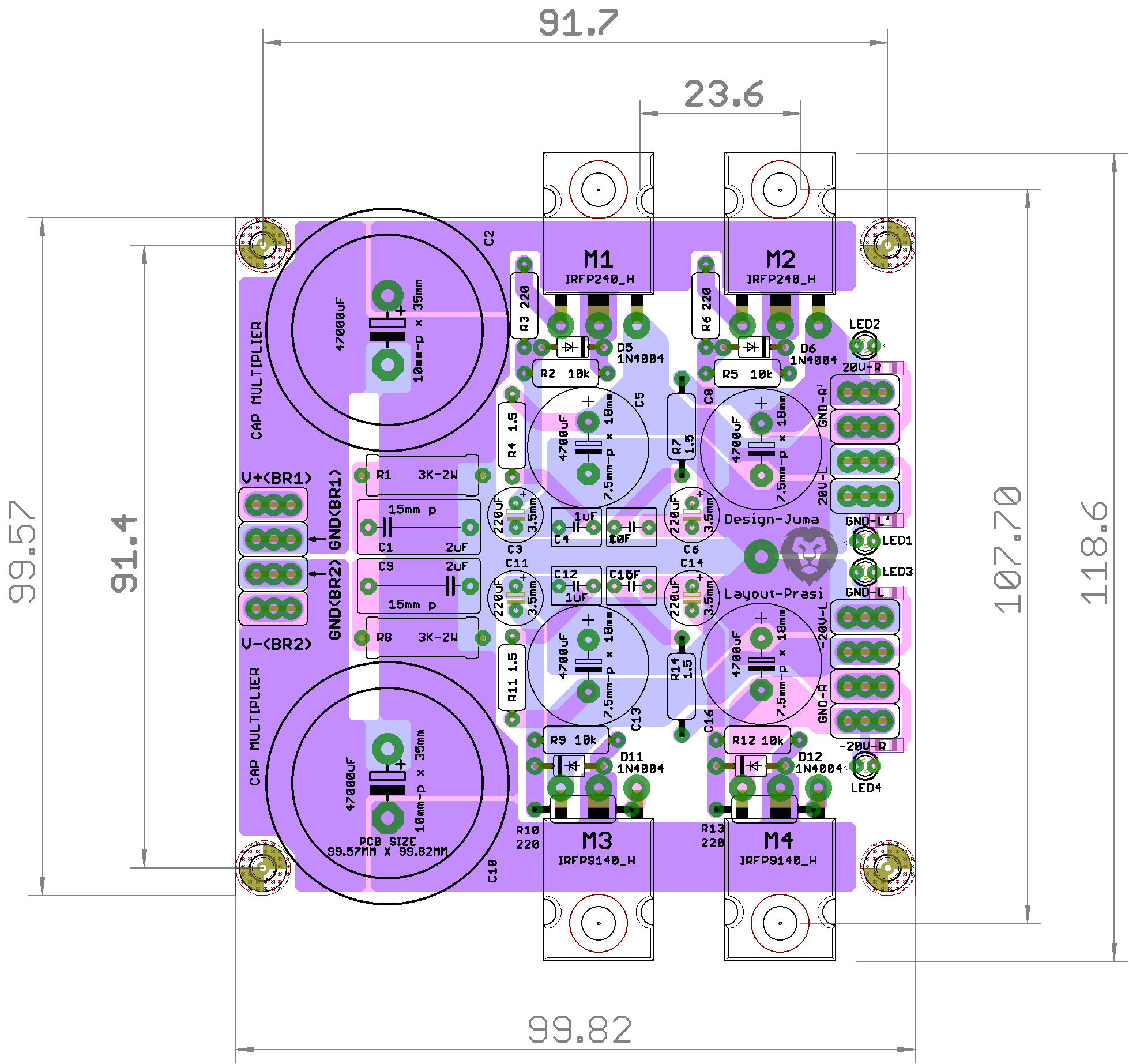

here are the schematic, stuffing guide and gerbers. LED resistors mount from bottom.
