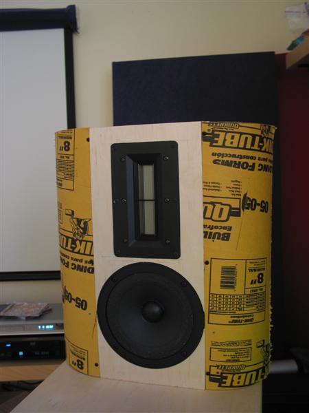

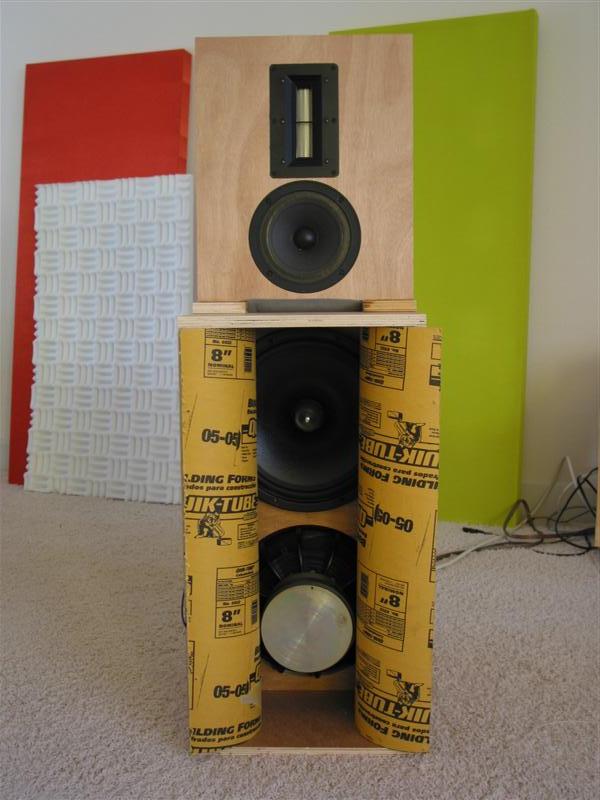

I tried outside measurements about a month ago with my old baffle. It wasn't pretty. I've got lots to learn.
Pic of setup: Here
Measurements
Since then I've moved to an Orion-like setup and used some EQ to fix that 10k hump.
Tried some Speaker Workshop gated measurements. Ouch.
Pic of setup: Here
Measurements
