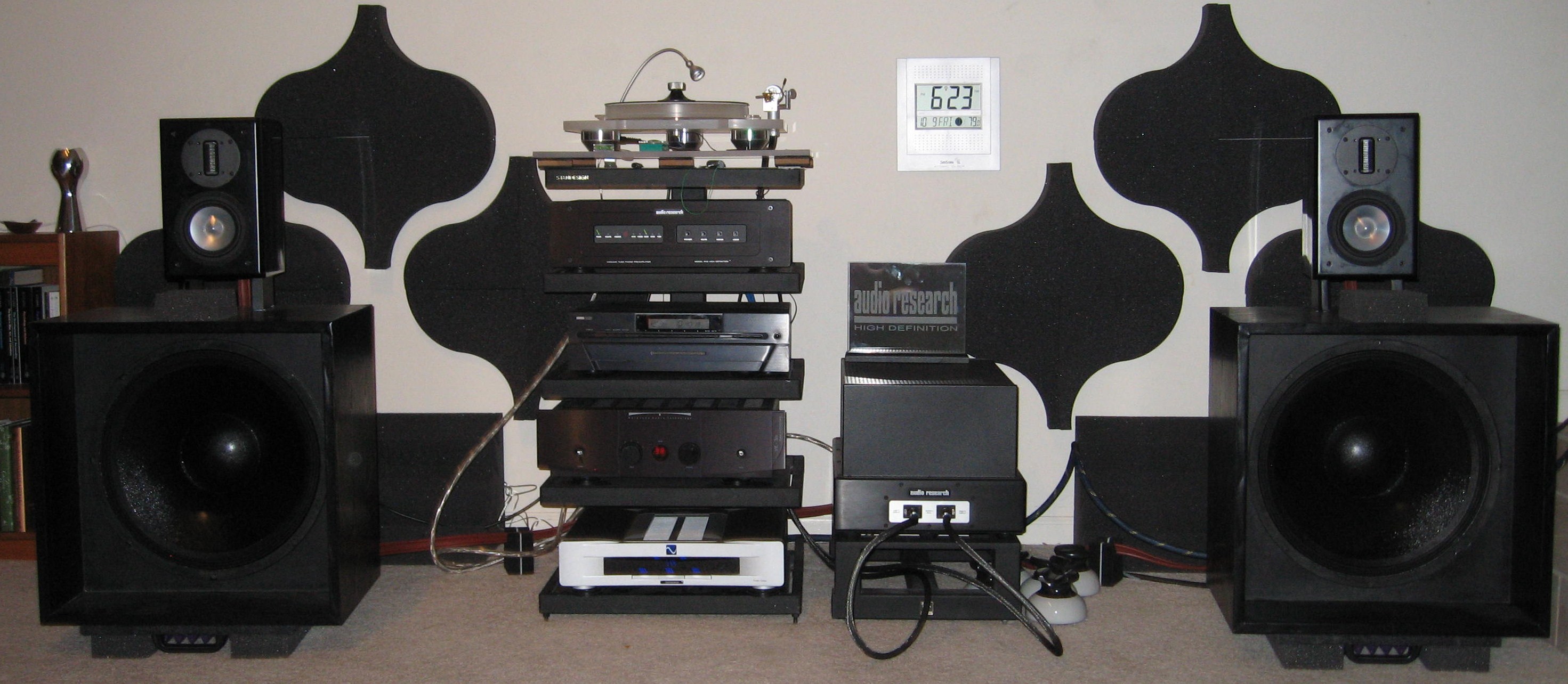

Combined Jordan with Ribbon and H-frame
Since this thread is active again, I decided to try to upload pictures of the combination I have been listening to for some time. This is the Jordan with Ribbon on top of the Goldmund H-Frame from MLK, using the passive crossover configuration. After much fiddling with placement and separation of units, it sounds very nice. In fact, after returning from RMAF last weekend, I am even more pleased with how well it sounds. The H-frames are sitting on Auralex Gammas, which helped, also, and I found the location of the Jordan/Ribbon to be critical with respect to the H-frame. That is the standard Parts Express enclosure for the top speakers. In this case, the Jordan makes a great midrange.
- Full Range
- Jordan with a Ribbon MLTL
