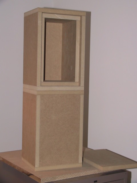

As for size, a .5 ft^2 sized ported box gives and f3 of 45hz, tuned to 45 hz, with a 1.5" diameter, 3.75" long port. You will want a smaller box if you want it sealed. I tried mine with the port sealed and didn't like the result. (.25ft^3 box)
I would not recommend building the speakers by laminating slices together, because I have heard a couple of people say that they had problems with splitting of the mdf/wood, after the enclosure was finished. It would be quite a shame to spend many hours building the enclosure, to have it split and have the scrap it.
As for the combo of mdf and solid wood, this is what I did for my Thor TL speakers, and I strongly advise against it, unless you have solid wood that is already quite dried out or doesn't expand or contract. On the front baffle of my Thor TL speaker, the solid red oak cracked on one part, leaving a ugly looking crack. If filled it in with wood filler, and stained it, but it still visible. Also, where I did the 3/4" roundover on the edges, it is no longer perfectly flush, showing that the wood expanded a bit. There are no problems with the cabinet, since the internal mdf box is perfectly sealed, but it disappointed me to see how the oak expanded/contracted. The wood wasn't fully dried out before I started, which I read can take at least a year to do, if you properly store it.
My Jordan JX92s box was created in a weekend, and not yet painted. It was originally supposed to be a temporary box until I made a larger box. I liked the setup, and got sidetracked by other projects, so I didn't look around for an alternative solution. The sides are double thickness, with double-butt joint construction, making it quite rigid. I like this approach very much. It also was quite inexpensive and not too time consuming.
The picture below shows how the box is constructed, with the front panel removed, and no roundover (1.5" roundover used)
