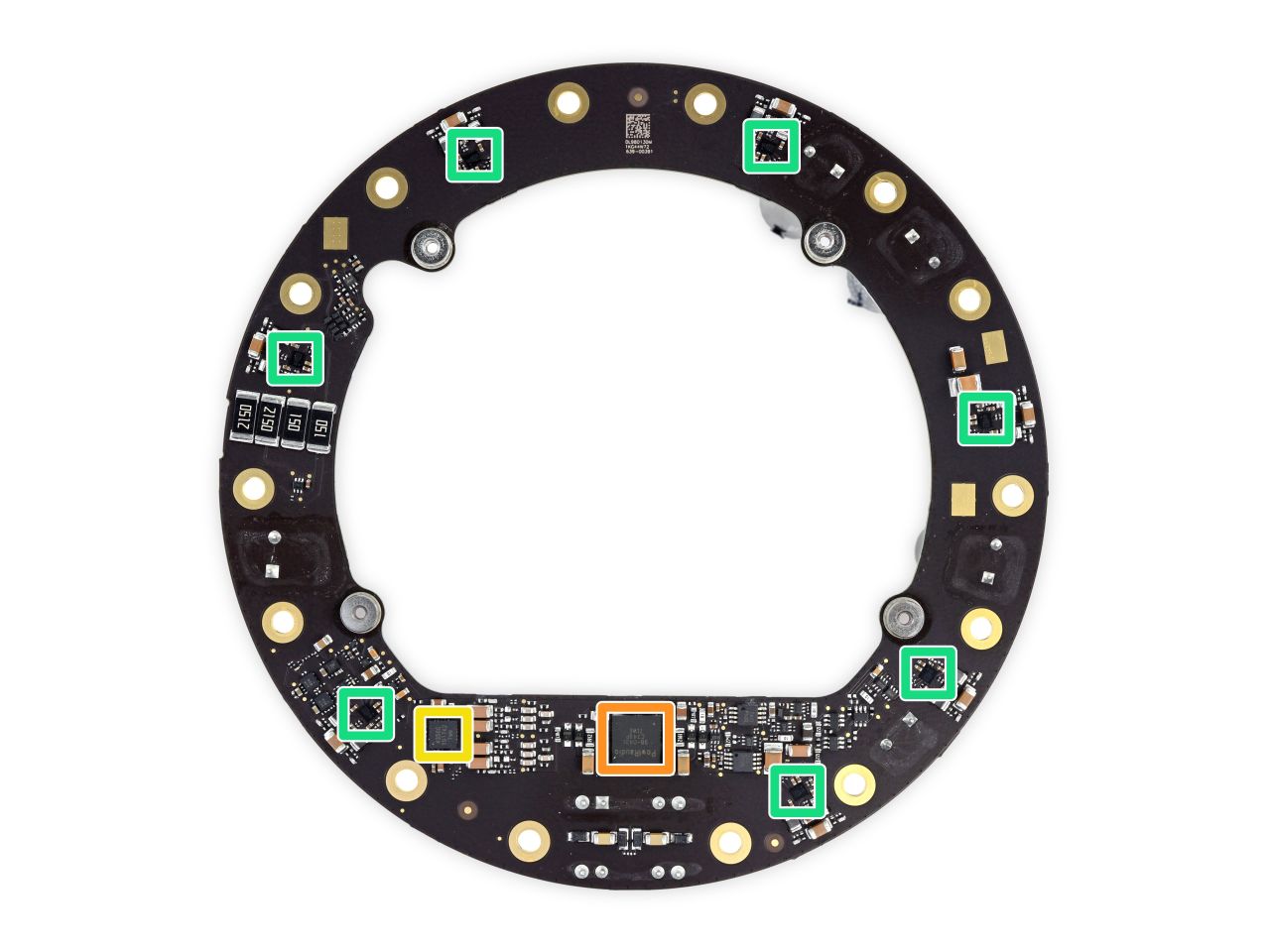

How many DSP channels, DACs, ADCs for the sensing microphones, and amplifiers are we talking about here?
How did they get it all inside that package?
Any idea about the chips used (other than the A8)?
Just a clean power supply for this thing sounds like a challenge.
individually amplified - so 8 amps, DSP channels and so on.

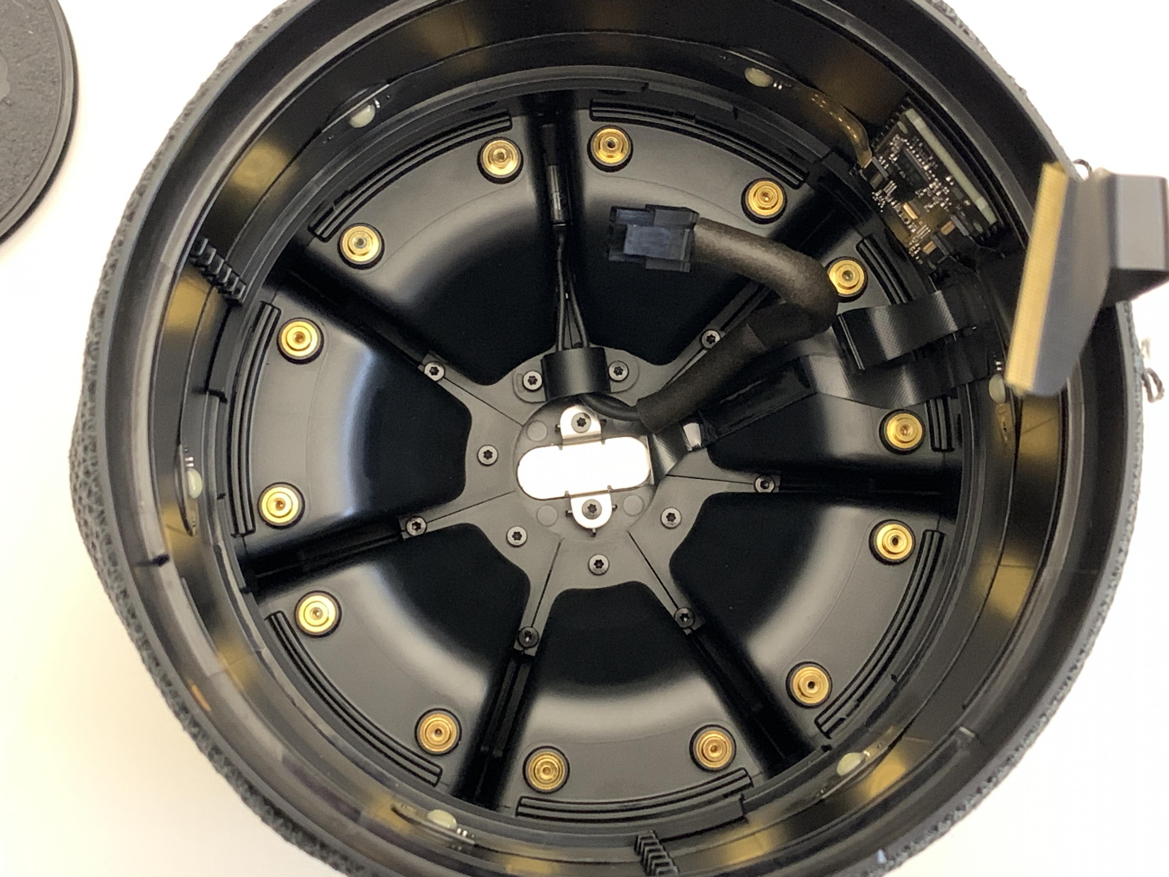

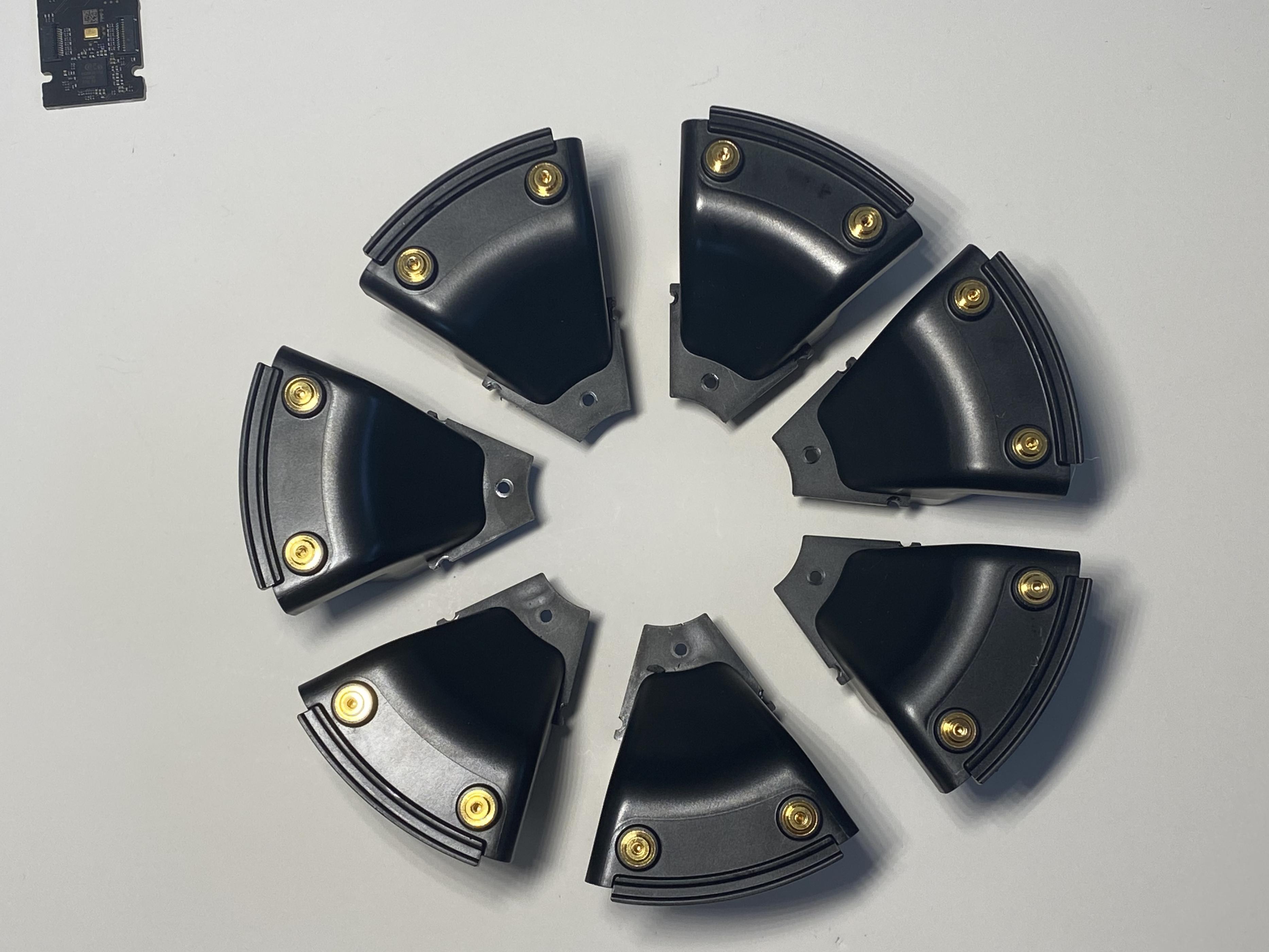

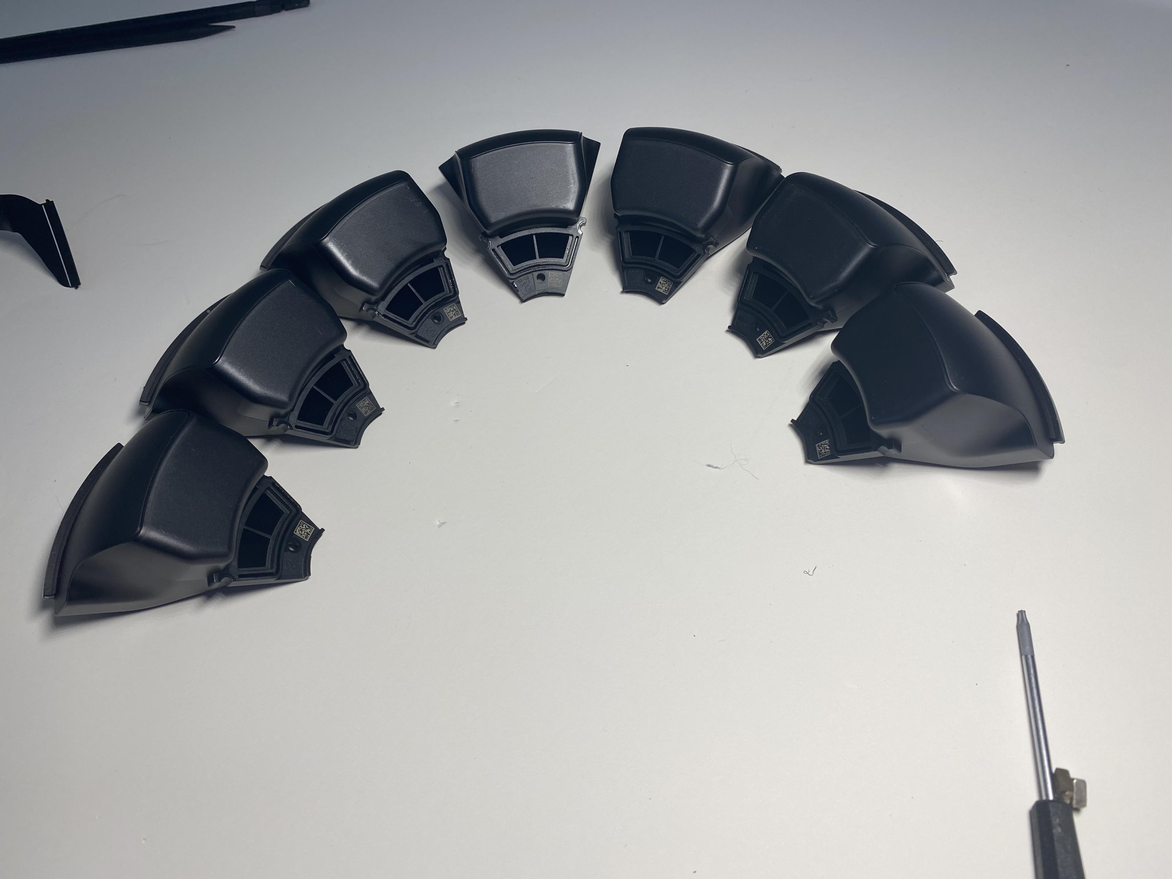

I have 5 of these now. 2 stereo pairs and 1 single unit. Also a stereo pair of HomePod minis. It’s really nifty how 7 tweeter “slices” all join together in a circle and fire downwards through a circular waveguide.. Why hasn’t another speaker maker thought of or produced this? Also each tweeter has its own amplifier. I’ve done a full proper disassembly on MacRumors and iFixit. I also used my old Dayton Audio DATS v2 to measure the T/S parameters of the woofer and tweeter. HomePod doesn’t sound as filling as say my Boston VR-M90 or Ohm C2 or any other large speaker, it does sound larger than what it physically is. I find that I use these more than my regular stereo these days due to confidence and sounding great. Very clever that it used microphones to automatically tune itself. It even has a microphone for the bass to ensure it doesn’t over drive the woofer and distort.
I would have thought that actual speaker manufactures would have thought of Apple’s design first. Imagine making small “bookshelf” speakers the size of HomePod with 7 tweeters and a upwards firing woofer. I have a parts unit that I could mess with.

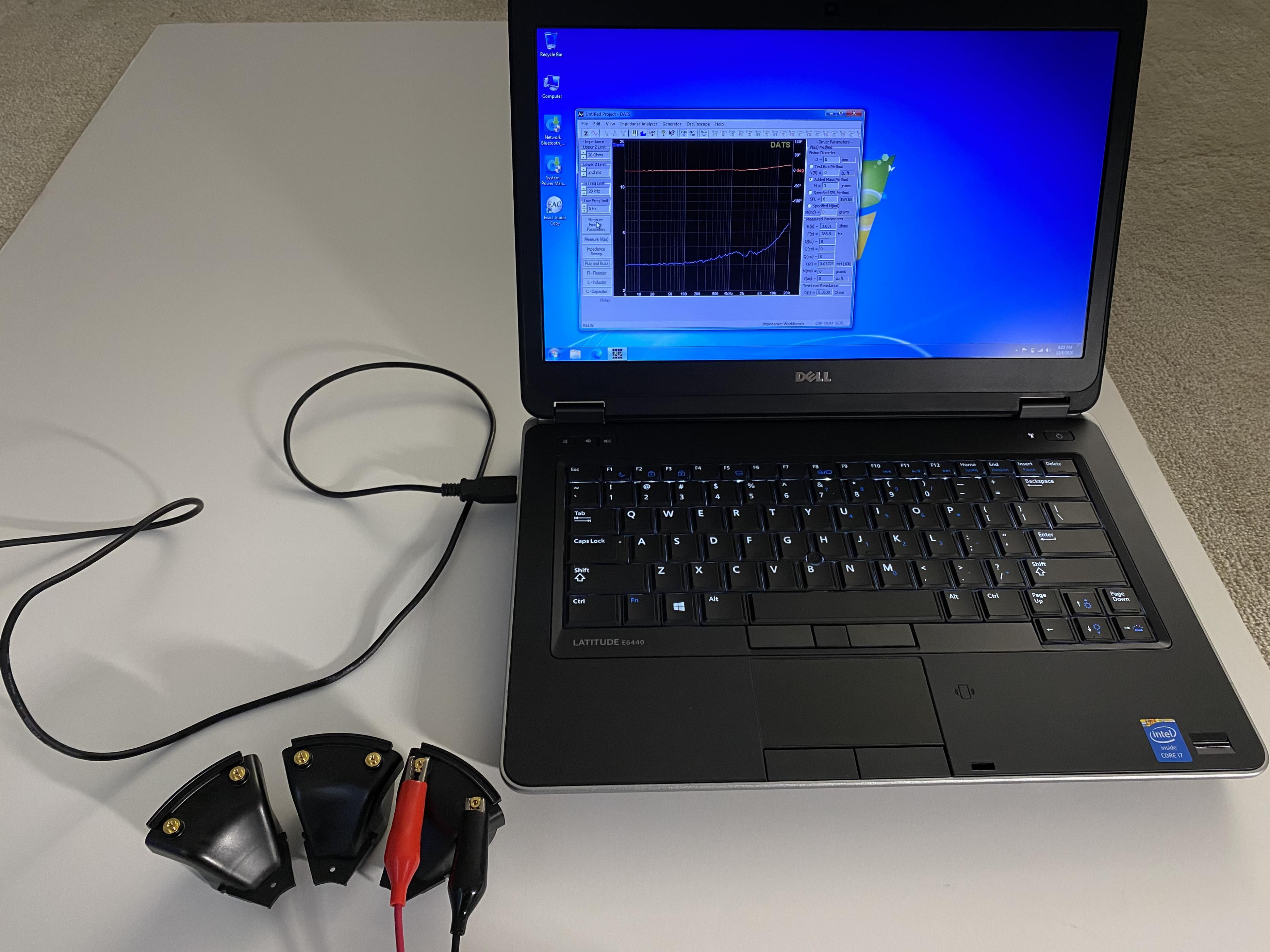

Could those tweeters be wired in series or series-parallel with a proper crossover and used with the woofer (with a crossover) and driven by a regular amp? Pretty much means gutting out the active electronics (power supply, amplifier board, microphones, etc)

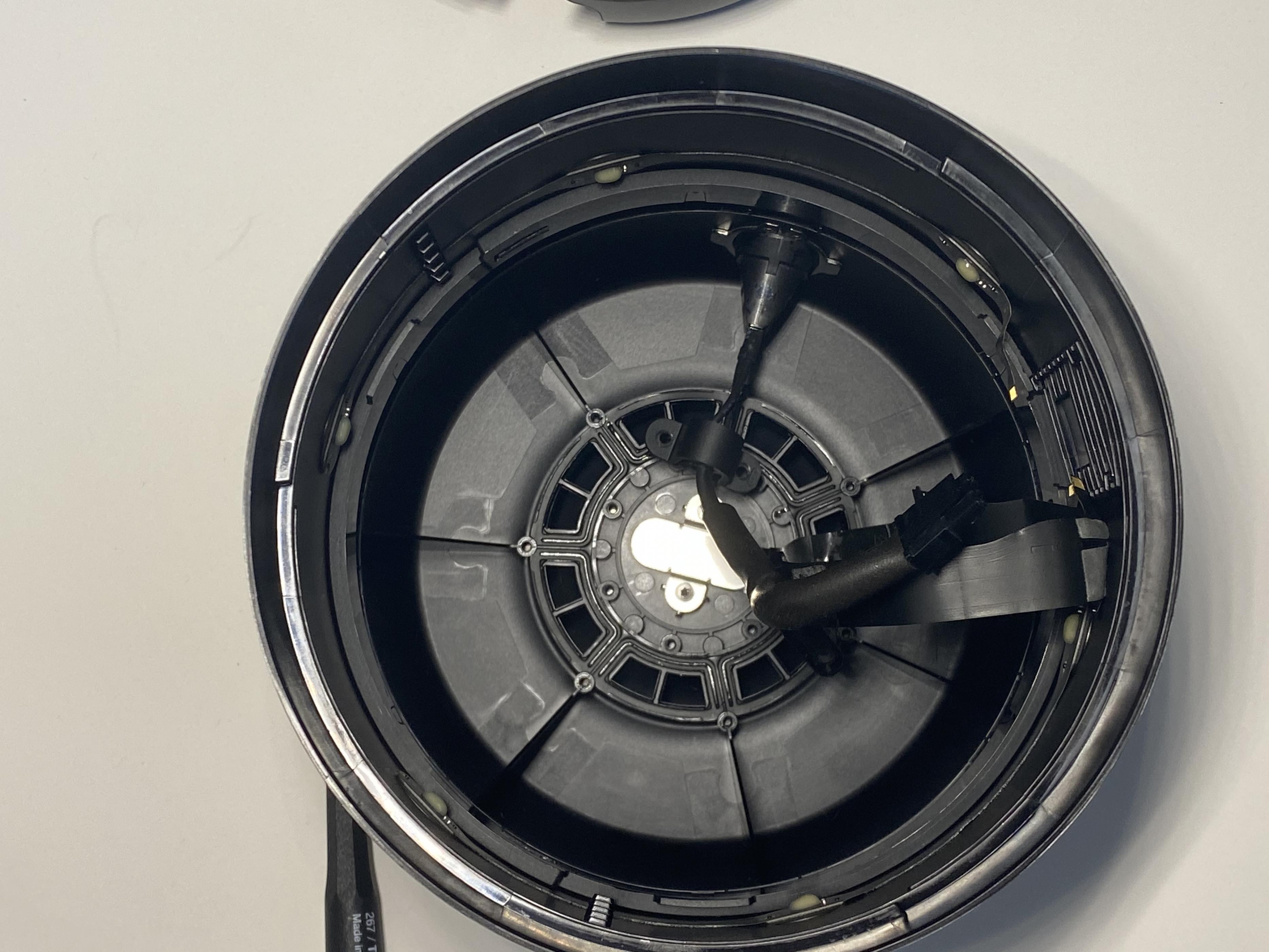

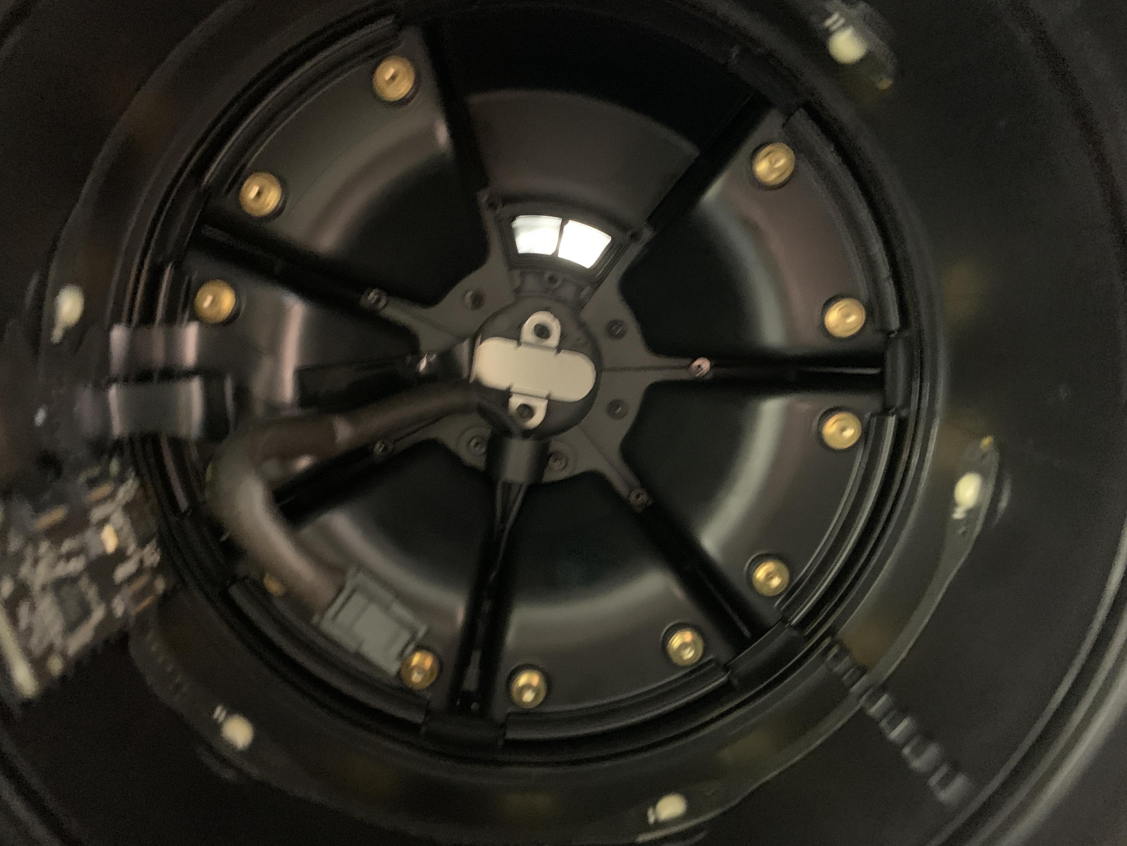

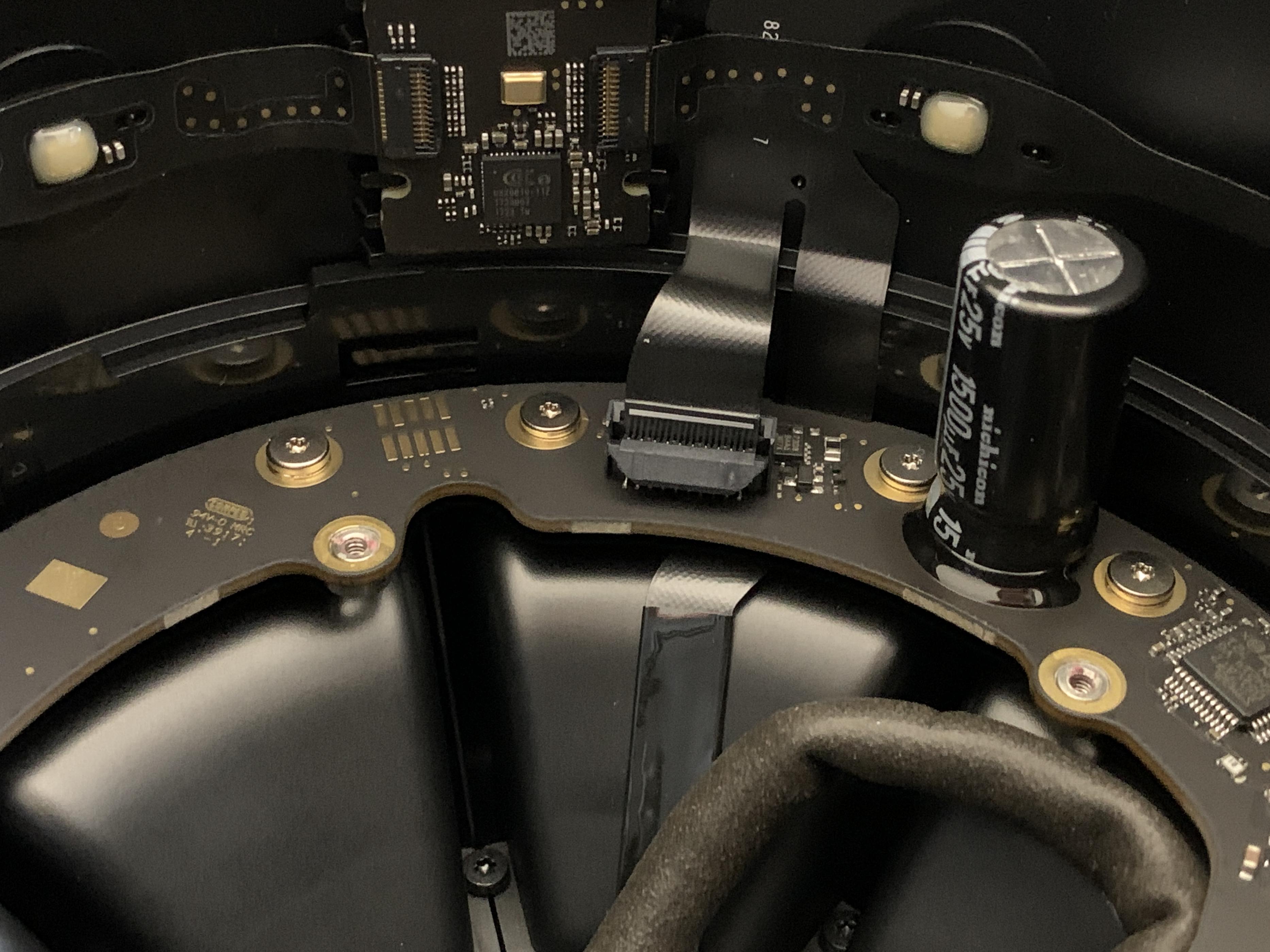

Not sure what happened, but I guess those photo didn't upload.

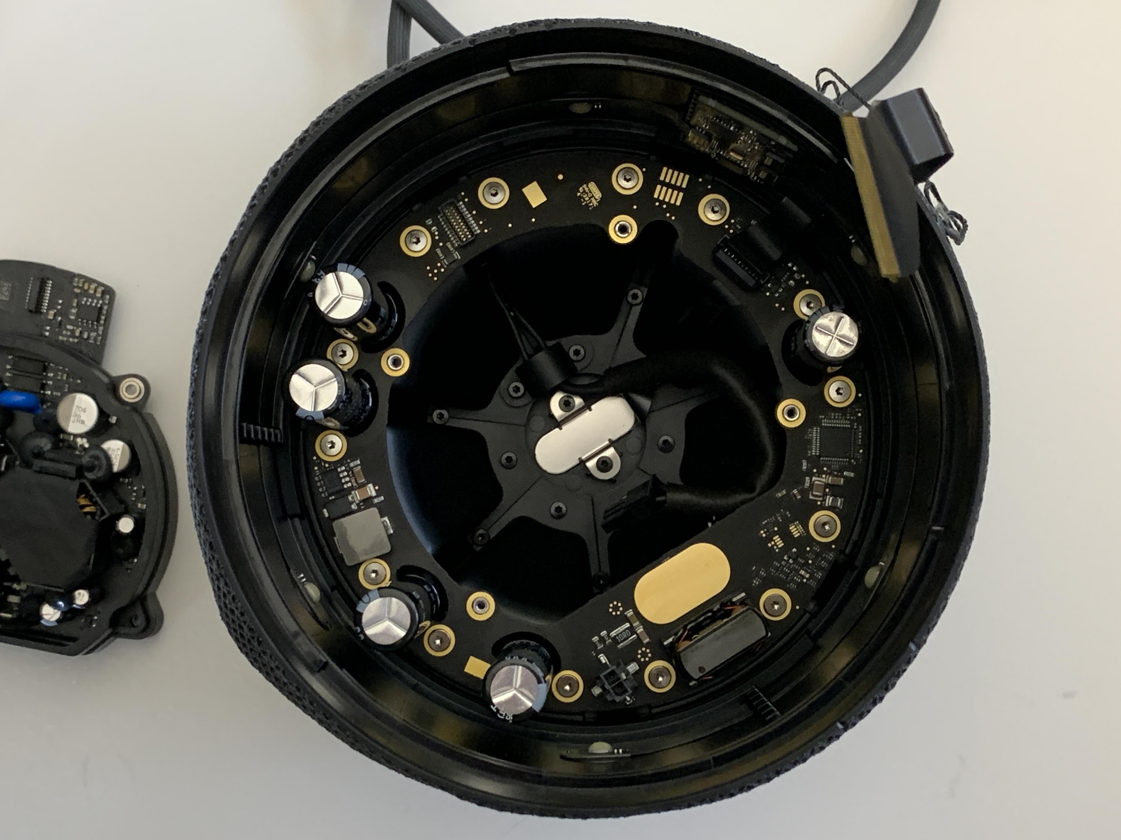

Here we are. Also interesting how the amplifier board (circular board) is screwed directly to the 7 tweeters eliminating the need for wires. Each tweeter has it's own Analog Devices SSM35158 amplifier. The 4" woofer is driven by the International Rectifier PowlRaudio 98-0431

So while I suppose making a crossover and joining the 7 tweeters in series or series-parallel would not yield anything close to what the active electronics accomplish, I’d still be curious. I realize Apple has much more money so sink into these products than Bose or JBL for example, but I am surprised no company has fabricated a custom tweeter horn like how apple has done. Most manufactures stick with conventional designs.
