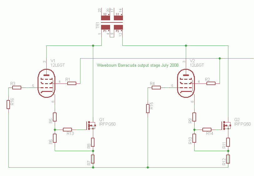

John, what I am talking about, is very practical. There is a big difference between what is practical for short run of precise and expensive devices, and mass production of cheap consumer products. Different technological approaches are practical for them, and if to involve design in this equation there will be different design criteria as well more practical. Like (back to your example), some radio listeners prefer sound of filters of selectivity arrays in Collins R-390/URR shortwave receivers to electro-mechanical filters in Collins R-390A/URR receivers, though both of them are very expensive military receivers, while formers were designed for audio listening, later mostly used for teletypes. In case of FM (though in something different than All American 5 that was AM only) tuned coils would be preferable to ceramic filters for high-end receivers, when for mass production ceramics would be more preferable.

Edit: and ceramic filters were not available yet. Instead, Motorola used tuned filters molded in epoxy resin in their military airborne receivers, they were called "Permakay". I have one, it looks nice, don't need any adjustment in service, and sounds much better than any modern ceramic filter.

A 12V version of 50L6 I use in my latest hybrid amps.
