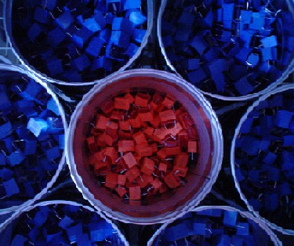

Tell me about it, i still need to swallow at least 6 months of espresso to have enough coffee tin cans.
I've got a blowtorch in the kitchen, but it's from home depot and for making crème brûlée . :clown:
