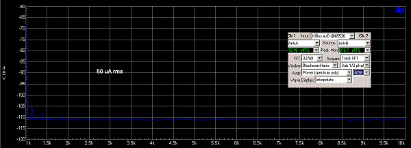

The same relay as before, I put 55dB preamp in front of analyzer, the voltage drop on NC contacts is 1uV rms now
