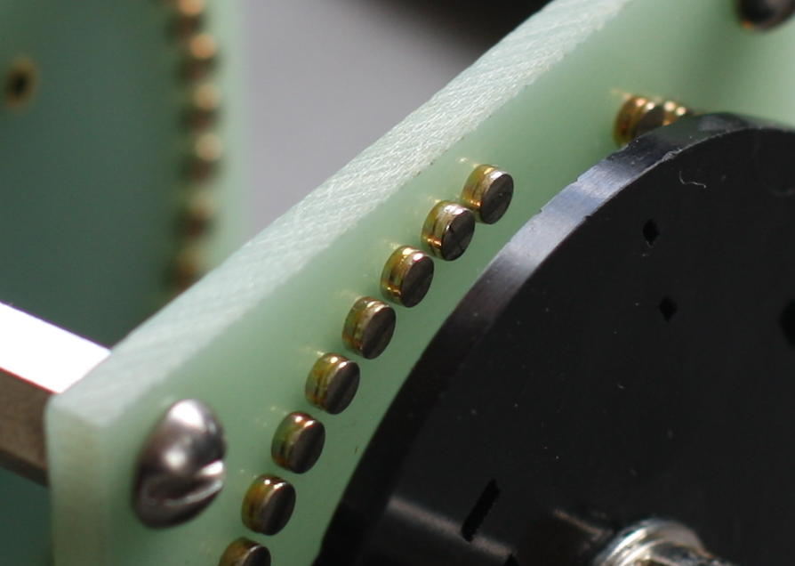

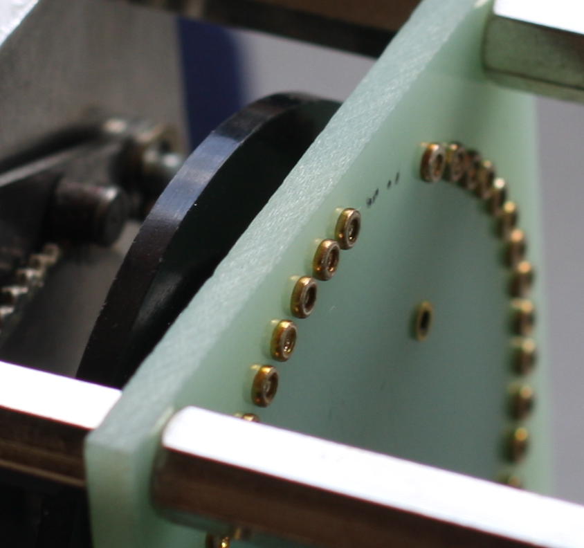

Here is the full text of the reply I got from the lead engineer at Shallco:
I have been here almost 25 years and I have never seen any contacts with
solid silver turrets (posts). At one time, there were solid silver contacts
used on some attenuators, but we only supply silver headed contacts
now. (In order to get solid silver contacts (rivet type), there would have
to be a special run that would be very expensive.
If he has one, I didn't have anything to do with the design which means it
would have to be quite old.
When he says "attenuators", he means the pre-built rotary switches that already have resistors attached and are in an enclosure of some sort. (I've only seen pictures and never one in person.) So either you had an "attenuator" or something really old. But obviously if they used solid silver turrets in their attenuators, they probably also used them at some point in at least some of their rotary switches, so perhaps you have a really old sample that had solid silver turrets.
The good news is that the current switches have very thick silver "caps" welded onto the copper posts, so they will last a very long time. We have have had units in the field for over 10 years come back with only negligible signs of wear. And better yet, they are still incredibly sonically transparent. In my listening tests they were essentially indistinguishable from a bypass.
