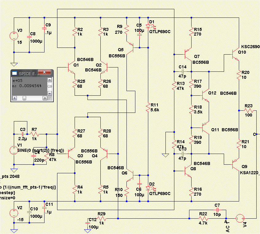

G.Kleinschmidt said:Well that is a pretty lame response I was thinking perhaps something along the lines of a discussion on the bandwidth limitation (of the global loop) imposed by an OPS using its own compensated negative feedback loop.
That would be something to resurrect the Negative Feedback thread for.
Glen
Glen,
Indeed, that was a pretty lame response, sorry. But did I have a choice? Not really, as the only way to make a serious contribution to your project, means that I have to redraw and simulate your design. Regrettably, I don't have all the time of the world, so I can't do that.
Edmond.
PS: In your latest version, the tube has gone. Why?
