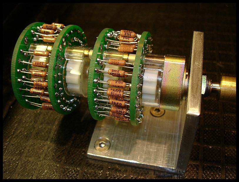

Constant input impedance by using a stepped ladder attenuator with and a 3u Au ELMA rotary switch is a decent solution. Depending on resistor type chosen, it can be low cost or high cost.
Attached is a low cost version I made a few years ago. Takes about one hour to assemble.
Sigurd
Sigurd

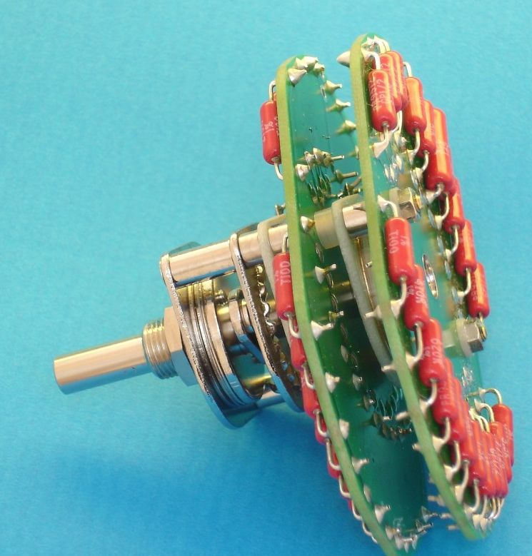

I am using the same balanced attenuator concept. A 5k TX2575 in series with HOT+ and COLD- and then a switched resistor between the nude resistors.
I am using the red PRP resistor in the Seiden switch. Not the perfect solution, but I do want to try some different components.
Sigurd
Sigurd

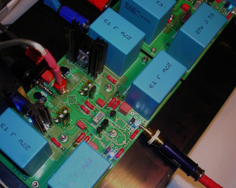

I have used them in my classA poweramp and compared to a TX2352 version a collegue built, and I find that the red PRP:s have less detail and also a softer sound. Bass is not as firm and contoured. Note, that I use a trim pot to adjust the DC offset, and for the PRP version a standard cermet trim pot was used but the the TX2352 version of my collegue, a bulk metal foil trim pot was used.
Sigurd

Sigurd, your attenuators look very nice indeed! Nice to see good work, and this thread IS all about the really good stuff.
And yes, Tek scope front ends are great place to learn about wide band attenuators. I remember with no great fondness a time about 30 years ago, calibrating a vertical plug in for one of my 7000 series Teks that I had purchased used for cheap....Unfortunately, someone had messed with the attenuator bank, and EVERTHING there interacts with everything else. Took me a day of cussing and tuning to get it right, but I never forgot what I leaned hands on about the trimming process...
I live near Tek and still know many of the engineers who designed a lot of that great stuff back in the Tektronix hey-days of the 60s and 70s. Sadly a lot of them are well past retirement and dying off, taking a HUGE mass of some of the very best analog engineering knowledge with them...
Would you mind sharing?...Which PRPs are you using? They have 9 models in metal film thru hole, one model in metal oxide, and 2 in wire wound. ,
http://www.prpinc.com/
The "audio specific" parts are here...http://www.prpinc.com/pdf/Audio_PR9372_Series.pdf
Are the PRPs that you use these 9372s? Just wondering, but who knows why they are 'softer'....Hey, sometimes you REALLY NEED a touch of softness, and it is good to know what to choose if you do. Otherwise the Vishay TX2352s seem to be pretty neutral for me in the lower wattage ratings, and at a tolerable price from Texas Components. I should order up some of those PRPs and give them a listen. I was not joking about the need for a touch of softness once in a while. It is indeed a serious part of component tuning.
Again, good looking attenuators!
Woof!

Thanks!
Yes, it is the PRP 9372 that I use. They are actually co-designed by Charles Hansen of Ayre, who uses them extensively as far as I have seen. I think that CH mentioned that he uses onl one 9372 type that has a given TCR, and that only the 9372 with this special TCR is the best one. Not sure which TCR that is. I use the ones with TCR = 50 when possible.
The PRP:s can be bought at for ex Percy Audio and PartsConnexion.
Nothing out there has yet beaten the TX2352 resistors. But I have not tested the Z201 resistors. The cost of those cross my cost limit.
I have tried the tantalum film SMD resistors in a stepped relay attenuator, but those are not for me. Changing all the resistors in this attenator to TX2352 really lifts sonics. At least if you like highly transparent sound with nothing added nor subtracted.
I found the tantalum film SMD resistors to be a bit lame and mellow.
Sigurd
Sigurd
