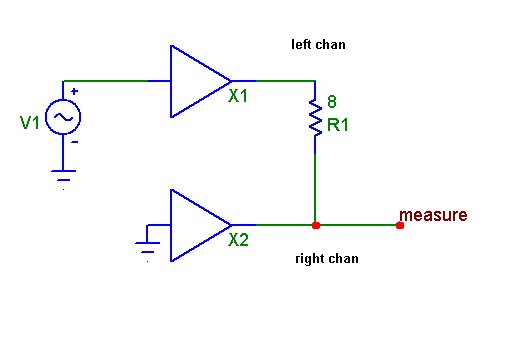

PMA said:I use this method to force output.
Practical, but there is some danger of measuring
crosstalk instead of the residual.
But you surely have yet another amp...

PMA said:Bob,
Pavel
Exactly, same here. A stereo amplifier makes this convenient. There are some tests, however, where the forcing amplifier may want to be a bigger amplifier just to make sure that it is not close to current limiting or under duress in some other way.
Bob
Using a square wave should show how fast
and how good the amplifier corrects output errors.
regards, Gerhard
The back-driving technique is also useful for exposing crossover distortion in a more sensitive way. Take the output of the amplifier under test while being back-driven, amplifiy it if necessary, and put it into a THD analyzer (or a spectrum analyzer). The amplifier under test has already done most of the work of getting rid of the fundamental.
In the same way, one can back-drive a 19+20 kHz CCIF two tone signal into the amplifier under test.
Finally, if you want a real LF torture test that will exercise the SOA space of the output stage, drive the amplifier with 19 Hz in the forward path and with 20 Hz in the back-drive path. You will get a 1 Hz envelope total current signal, where the voltage and current of the output stage are run through their various combinations as the 19Hz signal walks past the 20 Hz signal in time. Of course, this also brutally causes the rail current in the amplifier to go from min to max in accordance with the 1 Hz beat frequency. During this test, one can look for any 1 Hz signal at the output of the AUT. One can of course also look for other combinations of 19 Hz and 20 Hz at the output of the AUT with a spectrum analyzer, just like with the CCIF test.
One can go a step further and put a SMPTE IM 60 Hz & 7kHz signal into the forward path of the amplifier under test and back-feed a 59 Hz signal into the amplifier. One can then look for 1 Hz, 59 Hz, 60 Hz and other modulation artifacts on the 7 kHz carrier.
Bob
