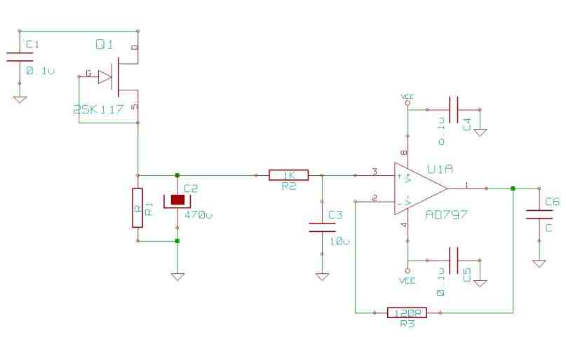

PMA said:
I have not seen the circuit, but I can confirm that the AD797 may be very difficult to keep stable for gains lower than some 20dB. It is possible, but additional components are necessary. I hope nobody trying here to use it like UG feedback circuit or with something difficult to drive inside FB loop.
Below is my suggested circuit.
The opamp part is actually used in a well working DAC DIY kit (IC3):
http://www.twistedpearaudio.com/docs/digital/buffalo_schematic.pdf
And here are the DAC's manufacturer application notes (Figure 3):
http://www.esstech.com/PDF/Application_Note_Component_Selection_and_PCB_Layout.pdf

The Buffalo schematic shows a 1u cap on the output. The DAC data sheet shows a 47u. Big difference. Neither is good with a unity gain 797 (if I am to believe the 797's designers), but oscillation is far more likely with 1u than 47u; the latter value will merely bog down the opamp's output and pretty much negate the advantage of using a high performance opamp in that position. You might be able to get away with it sometimes, but it can't be relied on and is poor engineering practice.
I have seen lots of examples of very skilled digital engineers doing very poor analog design (e.g., the bad I/V converters so often used with the old 1541 Philips DACs). This seems to be yet another case. I'm not sure why you think this is an exemplary design. There are far better ways of getting a stable, low noise supply.
With 47uF, everything is in the hands of God. The result will depend on ESL, ESR, type (SMD/through hole), manufacturer, perhaps even batch.
And then for the price of a Sabre DAC (that is at risk due to possible oscillations) you can get about 100 decent LDO regulators.
Correct points, but I make no definitive comments. The 120 Ohm snubber and large output cap might in fact be always stable. Again no one would have envisioned an application like this.
