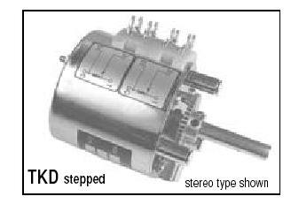

john curl said:...We use the VERY EXPENSIVE TKD pots that are only obtainable from Michael Percy (at least here in the USA). They cost over $160 each! We need two for each preamp. Still, they sound darn good. ...
Hi John:
This is an interesting thread.
What I'd like to know is whether you are using Shallco switches in this preamp of yours? Any particular reason why you chose to use TKDs and not stepped attenuators?
Thanks for sharing,
Milan
Upupa Epops said:Yes Peter, I'm serious and that's just it I need explanation - from you I din't get it...
But why do you need it?
moamps said:Any particular reason why you chose to use TKDs and not stepped attenuators?
They are stepped, regular TKD is only $60/pc
Hi Peter,
-Chris
Where do you buy your controls?They are stepped, regular TKD is only $60/pc
-Chris
Peter, the TKD mono pot (stepped attenuator) that we use in the CTC costs $169.00 each. Please look at the latest catalog. We just bought one last week. There is a cheaper TKD, which we are designing into the Parasound JC-2 in order to REPLACE the Alps pot used previously, and it costs about $60.00

john curl said:Peter, the TKD mono pot (stepped attenuator) that we use in the CTC costs $169.00 each. Please look at the latest catalog. We just bought one last week. There is a cheaper TKD, which we are designing into the Parasound JC-2 in order to REPLACE the Alps pot used previously, and it costs about $60.00
Indeed, mono pots are still available, I was refering to stereo, as I find them more practical. Although my setup for an attenuator was even less practical: http://www.diyaudio.com/forums/showthread.php?postid=863703#post863703
Presently I'm using S&B TX102 line stage with very good results.
