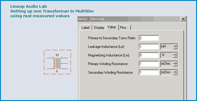

VivaVee said:1audio wrote
1) Manufacturer's SPICE models range in usefulness from reasonably useful to downright misleading
2) Simulations that account for only a portion of the real physical circuit under consideration are no more than pointers to better performance.
1. i really can confirm this from my own spicy experiences
from useless - to be almost identical to datasheet curves
now, datasheet curves are not even those the same as your circuit
2. a portion of the real physical circuit
won't do! .... even how good your component spice models are
- ideal voltage/current sources
- ideal rails ... it really is no rials at all, just ideal network nodes
I want to know this, i have wondered to ask about for a long time:
Are there simulation softwares
where you can specify inductance, resistance and capacitance of your PCB tracks?
By for example enter the dimensions, the geometry & length of your tracks between you components.
Of course i can enter small inductances, resistances & capacitances LCR of every track in my simulated circuit.
But what a job
Better to specify a few types of tracks, by copper dimensions,
and put these between components.
Power supply instead of ideal voltage source. This I have solved already.
Not difficult at all
See my attachment!!!!
First I can't take credit for the quote even if it represents my thoughts as well. Second I believe both Mentor's and Cadences premium product would allow you to build the complete model of the the layout and see what it does, necessary for the EMI/RFI compliance. But those are $50K to $100K per seat plus a year of experience to get value from them. And then all the parts that aren't fully modeled in the way you use them will leave your efforts hanging.
Better to get or make the instrumentation and test setups to see whats happening. I suspect that finding and "fixing" the details, like layout issues, tuning cap resonances etc. will make a big difference and be an enormous amount of work.
If all you are looking for is the linear response of the layout and circuit, you don't have to spend that much for software. At work we use a version of Eagleware Genesys that will do the entire linear simulation. From DC to 10+ GHz, if you like. I've used that software to simulate bypass schemes, including the PC traces, quite successfully - the measured performance of the circuit on the network analyzer was virtually identical to simulation.
There are other RF simulators that do much the same for less than a $1000. You could probably do similar simulations using RFSim99 if you wanted to put in the effort. You might have to use some other free software along with it to get the simulations you want. But, you'd be surprised what you can find on the web if you look. There's the free student versions software from Ansoft, for example.
