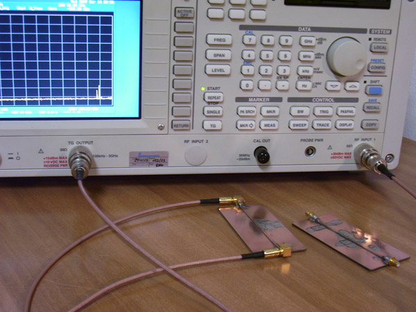

I couldn't find any details on the test conditions or instruments. I would appreciate those details.
Hi Demian,
For the RF plots: Advantest 9kHz-3GHz spectrum analyzer with Tracking generator, all set up is 50 ohm impedance (Rout, Rin, BNC-SMB RG316 cables and microstrip boards)
For the low freq. plots: DDS sweep generator and EMU 1616m soundcard with Spectralab SW. Also using the same cables and microstrip boards as before.

I've just found a photo!
