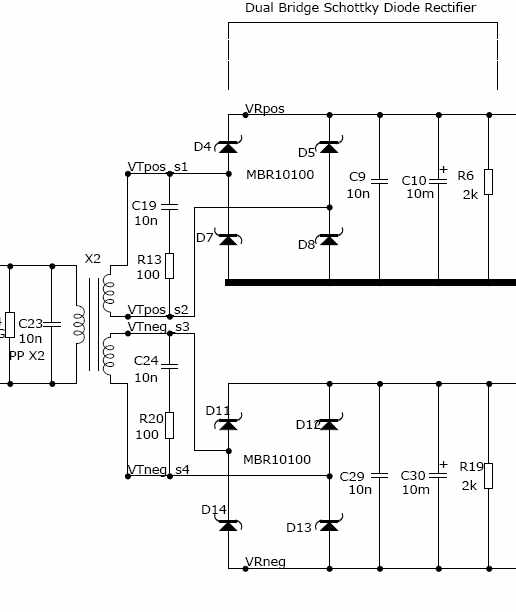

I also like this arrangement pretty much, as it allows for various forms of symmetry and separation, use of lower diode breakdown voltages etc.Sigurd Ruschkow said:John,
the last 5 years I have started to use only dual bridge rectifier schemes (ie 8 discrete diodes to make a dual voltage supply).
I like the way it creates an "active" ground. See attachment.
Any thoughs on this?
There might be one noise penalty, though... (I haven't measured this in detail so far, so it's only armchair reasoning) :
When the diodes don't conduct, most of the cycle in fact, the xformer leakage capacitance is seriesed with the diodes' capacitances, while when the diodes conduct the xformer is connected directly. This represents a "chopped" total leakage capacitance that might further "chop up" GND currents to/from other gear. With the simple bridge the coupling capacitance is always in place and doesn't change that much (but still to some extent), which might give way more benign GND-current spectra.
- Klaus
I also use the dual bridge diode array, also. The A mod for the Vendetta Research phono stage was just this. Later, I also upgraded to high speed, soft recovery diodes, and this was called the D mod. It is not a universal fix however, since the +/- loads must be matched.
