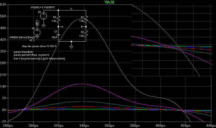

I think I sorted out this type of problems (had the same suspicions). See attached test circuit. Enough testpoints (even in the zoomed area more than 1 per pixel), enough precision (LTspice can do double precision, ".option numdgt=15").
The circuit produces only expanding 3rd harmonic of a 4kHz sine, in high amounts with higher levels. There is no DC offset, and the signal is perfectly symmetric. That signal is fed into the allpass (RC-LP @ 10kHz), which has significantly different group delay shift at the 3rd at 12kHz. The left-shifted (in time, about 60deg) 3rd is very visible, yielding those ZC shifts because its level increases.
Still in the FFT data all steps yield exactly the same results of phase relationships between fundamental and harmonic (and between output and generator), regardless of level, as is the THD data of allpass out vs generator.
So my conclusion from observing such ZC shifts, provided that trivial error sources are absent (DC, even order stuff etc, which is hard to achieve in practise), is not necessarily that there is true phase distortion (signal dependent phase changes). When there is phase shift actually coming from things like shifted pole frequencies from non-linear caps, these seem to add/subtract to the basic effect, making it hard to identify or correlate these ZC shift graphs to anything meaningful. That my 2cts only...
- Klaus
Hi Edmond,Edmond Stuart said:Hi Klaus and Pavel,
Your sims are quite interesting, but I'm not sure how to interpret the results. Are the ZC shifts a result of phase modulation or something else, a DC level shift, for example. To figure that out, you must look at the rising and falling ZC as well. As these shifts may be rather subtle, round-off errors of the simulator might compromise the results, in particular if they are based on only one or two points.
Therefore I prefer to make use of FFT's in order to calculate the phase shift more accuratly. As a FFT uses at least 1024 points, it's quite obvious that this method (due to averaging) is far less prone to round-off errors.
- Klaus
Hi Klaus,
Thanks for input. I'm glad you came to the same conclusion. This also explains why I got a complete different outcome when a I looked at the true phase modulation (only femtoseconds)
Only one remark about the number of data points. I didn't mean the number of points available, rather used for calculation. So in case of looking only at the ZC, this is just one data point. That my 1ct only...
Edmond.
Edmond.
