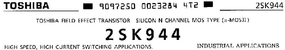

Whenever you're ready, 944 talk will also do.
