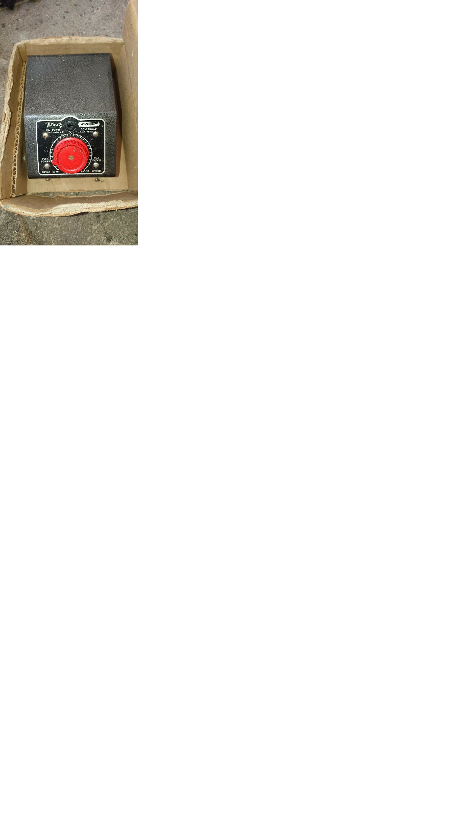

That would have been gold to a 3yo learning control theory lol.When I was 3 yr. old (1953) my father brought home a Variac to run my Lionel train rather than the rheostats that they usually used.
When I was around 7 I had one like this...
With this I learned lot's of things about lamps and motors and voltage and current and power etc and........and dissipation limits and failure modes of items and materials etc lol.
I can still hear the scratchy contact sound of the rheostat and the smells of things cooking, a Variac would have been choice.
Dan.
