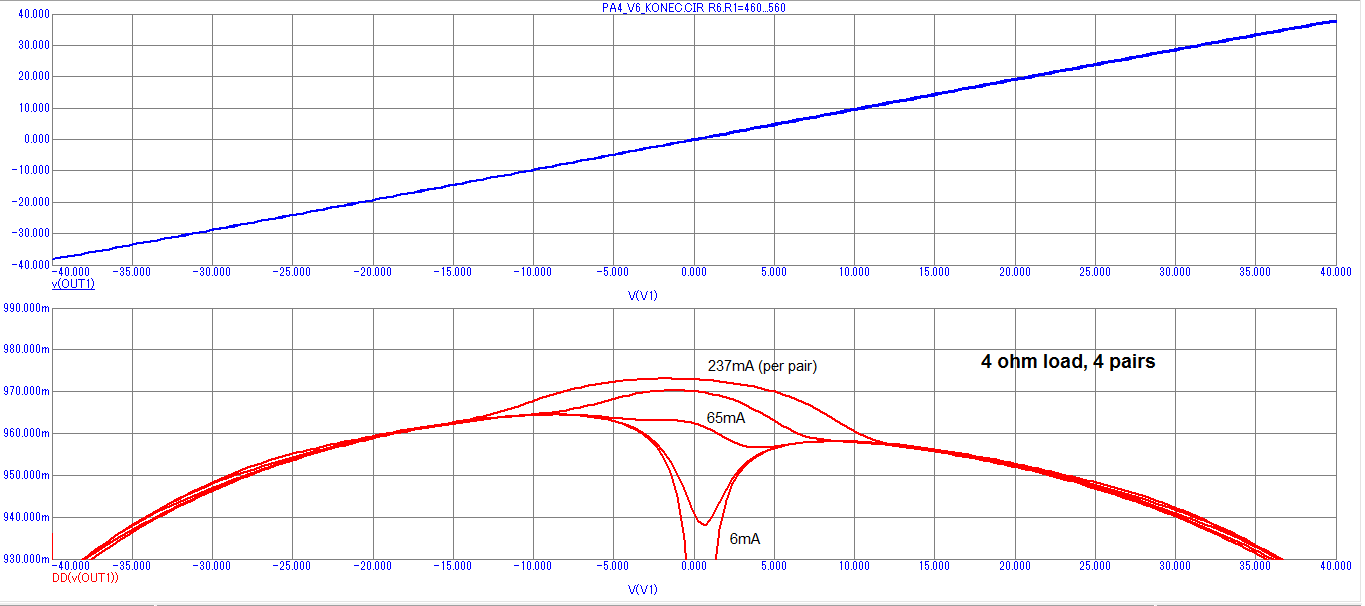

Numbers are not very interesting itself. I think you (and few others) are smart enough to decipher the attached plots. Bias current per pair 6, 23, 65, 143, 237mA. And please do not analyze 8ohms (I did so as well to be on same track), no speaker is that light load.

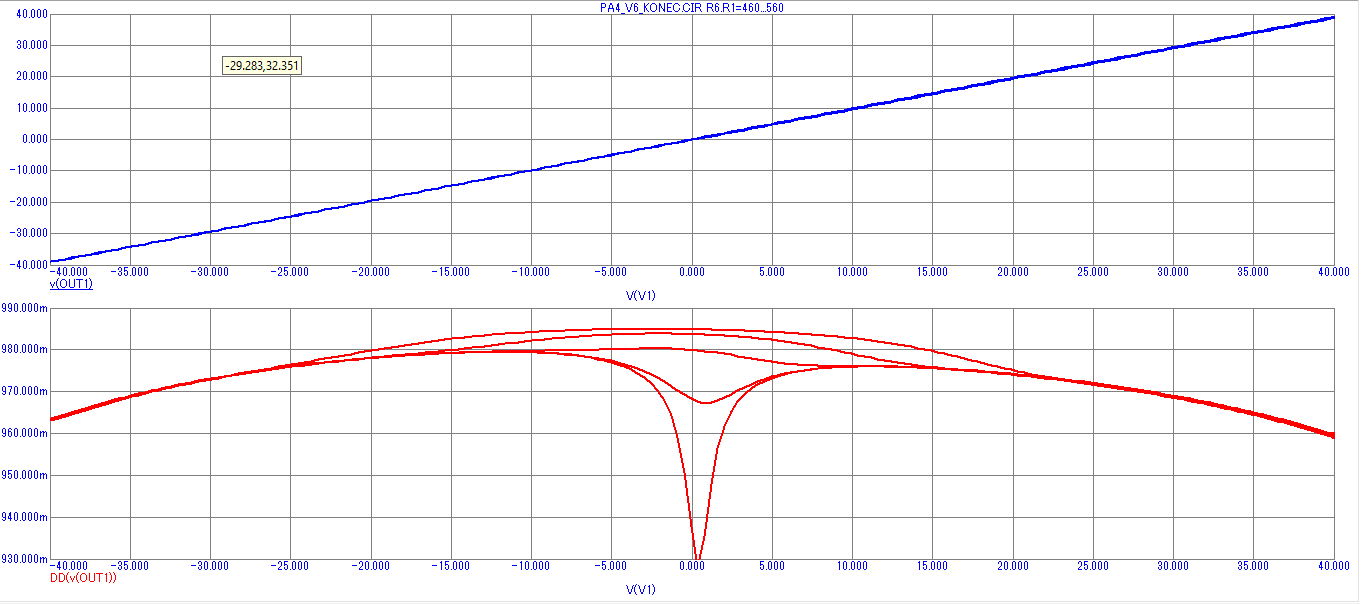

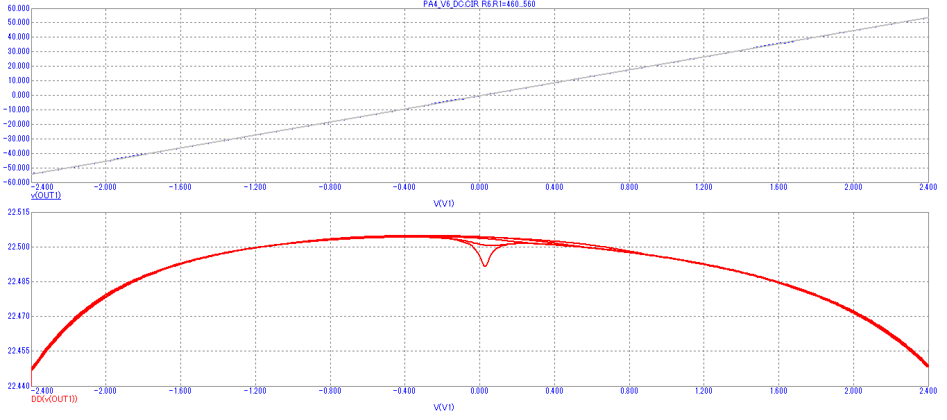

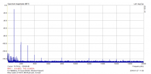

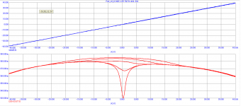

4 pairs, 4 ohm load (realistic load!). This is what counts in creating high harmonics, not numbers. That's why there was a tail. 0R22 per one Re.

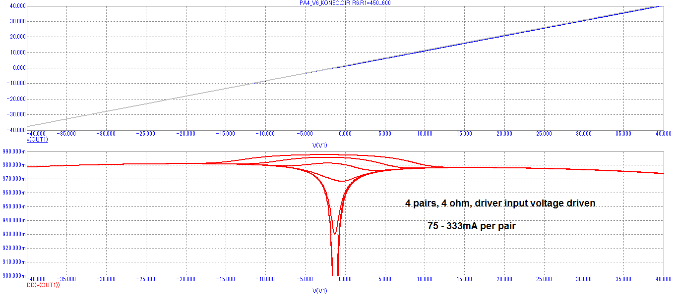

The next one shows output stage transfer function in case that the driver transistors are voltage driven (previous examples were through 3k to imitate VAS output impedance). What would be better sounding, the deep notch, or mild hill? I think we know what spectra belong to them. The only tool that fights against the underbiased output is the strong feedback. Analyze transfer functions and output impedance nonlinearity, even with the feedback, residuals are still there. That's why class A is the best.
Complete amp transfer function. THD numbers almost do not differ, spectra are from fast decay of high order harmonics to the long tailed, forest of harmonics. This is re idea "low bias, just behind the point where crossover distortion disappears". In no setting of those used there will be any visible crossover distortion.
Do a bias vs thd plot.
THx-RNMarsh
Your request is undefined.

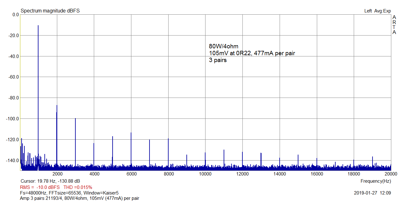

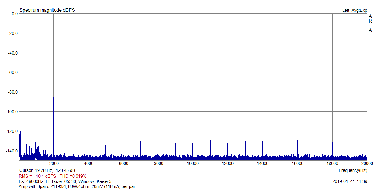

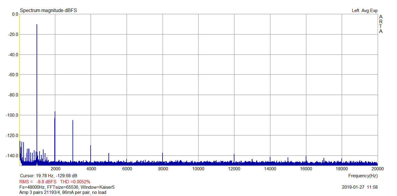

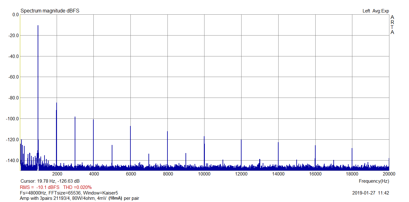

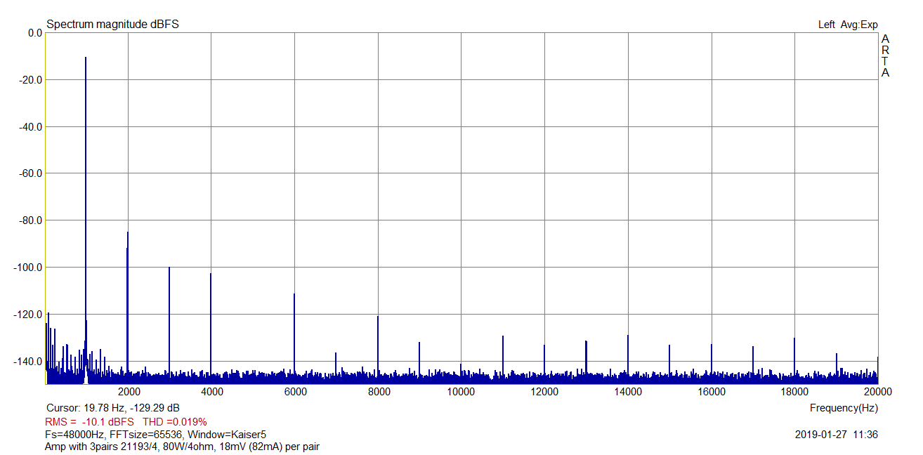

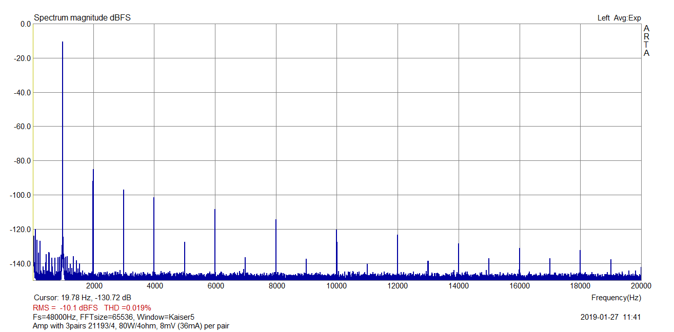

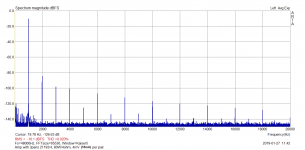

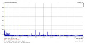

Real amplifier, measurements (not simulation), 80W/4ohm test power
- 3 pairs 21193/4
- 0R22 Re resistors
- 18mA, 36mA, 82mA and 112mA idle current per pair
See that THD number is always almost the same, however spectra do differ, the lower bias, the higher amplitude of high order harmonics. The 112mA is about optimum, but in the wide range starting from 80mA the result is OK. High order harmonics are below -120dBr to the fundamental.. No problem to keep the idle current.

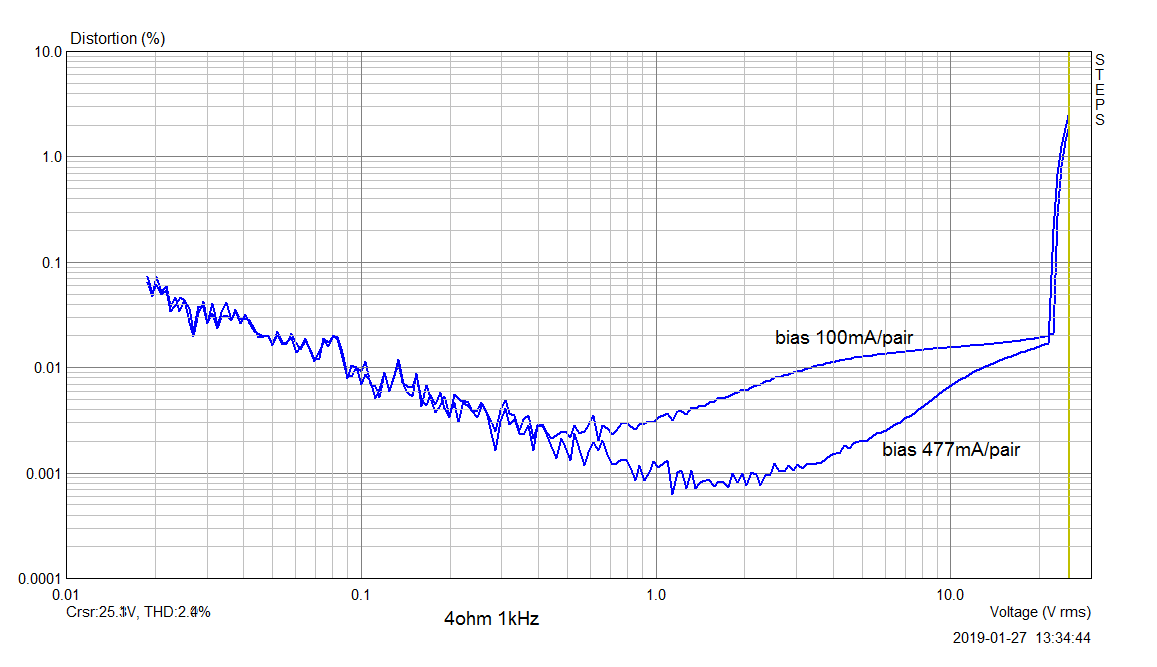

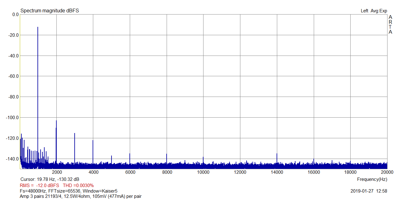

477mA/pair vs. 100mA/pair
Thanks for all the work Pavel. Many of your plots show dominant seconds which has nothing to do with optimum bias but PNP/NPN match. I only wanted to show that turning up the bias gave "First Watt" behavior at low power, very low THD that monotonically decreases from 10W to 0 where most of the (unmasked) listening occurs. The ripples in THD vs level that you get when you tune up the optimum point, if you examine carefully, both go up and down but also flip harmonic structure around.
THD at full power is not very interesting, neither are plots of THD+noise since all useful information at low power is obscured. After all this is how everyone hid their crossover distortion for decades.
