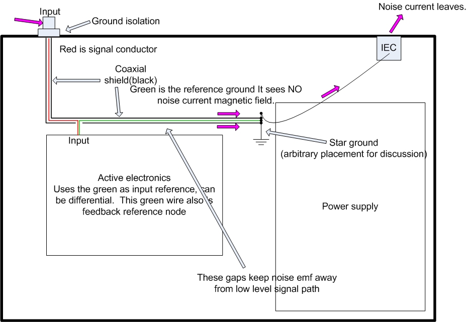

Personally I find safety ground and chassis are all about controlling RF. It seems to be detrimental. So I'm not sold on JN's clearly very good way of reducing audio currents. Maybe I'm cooky, but I like the things I do that are audibly better. While matching potentials is nice, so you have an ultimate reference at no volume, what we hear seems more consistent with the changes in volume that don't seem that respective towards ground so long as the appliance is consistent to itself.
http://www.diyaudio.com/forums/atta...ch-preamplifier-iii-input_noise_isolation-jpg
Recipe for disaster in my experience, and EMC giants like H.W.Ott would certainly agree. To work it needs the small signal part fully shielded because the whole inside of the outer chassis is polluted with radiated RF from the incoming cable shield. Relying on some distance as indicated in the drawing isn't enough with today's levels of GHz-ish RF.

I think I will keep posting this image for as long as anyone is willing to discuss it.

Let's start with the Neil Muncy (RIP) 1994-95 AES paper, later referred to as "the pin 1 problem". Basically it's all external cable shields need to be connected to the chassis at their connectors. The exception being for multi-conductor cables when the shield does not carry a signal (like XLR balanced interconnects). Then the shield may remain open or be connected to the chassis thru a small RF capacitor.
With an external RCA unbalanced interconnect cable the shield is also the return signal conductor so it needs to follow the shield connection rule.
While inside the chassis a wire that carries a signal from one part of the circuit to another part may have a shield with only one connection because the return signal is part of the circuit common (aka Ground).
Moving on to the schematic.
That long internal wire from the audio interconnect will act as a noise/interference antenna and be "the pin 1 problem".
The input connector has two signal conductors.
The idea of the noise just going away thru the IEC connection is an oversimplification and it seldom works that way.
So what to do?
  • connect the Safety Ground/Protective Earth to the chassis near the IEC connector
  • connect all the signal interconnect shields to the chassis (at their connectors)
  • connect the DC supply common (aka Ground) to the chassis at a single point
  • connect the audio circuit common (aka Ground) to the chassis at a single point
  • the above two commons connect to the same single point and it should connect to the chassis near the input connectors (this connection may have a series resistor)

My focus in that set of drawings was two fold..
1. With all components bonded, the low frequency currents of the signal from the pre to the amp will take the path of lowest impedance, which would not be the IC shields, but rather the bonding grounds. That rears the ugly head of coupling between the amp haversine draw and the input signals. With no signal, all is quiet. But with major power, the input may be compromised due to coupling.
How one measures this coupling without disturbing the system is a big question, the coupling depends on the low resistances.
2. The loops allow field coupling of external sources. Big loops, big coupling. Big enough, near strikes will toast the equipment.. Sadly, been there, replaced that..:(
I am more than happy to be proven incorrect, that is familiar territory (anyone with kids knows this position).

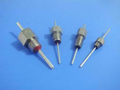

Just a question in general. The attached doohickey is std fare in RF design for getting power in and out of ones hogged from solid boxes. Some neat little SMT ones these days. Not sure I've ever seen them in audio, which is a shame as they would seem ideal for what we are discussing, which is herding the RF into the chassis and not to your amplifier. Anyone had a play?
But to use them you almost have to double box your unit, not unlike LNAs which need 2 or 3 boxes to get 50/60Hz out of the way.
Going balanced really does make some of this easier....

I use the SMD versions of those. VERY handy for increasing the PSRR of (discrete) voltage regulators for (discrete) line stage / DAC / phonostage applications. If I'm remembering correctly my first choice vendor is TDK/Epcos. Just channel Walt Jung and you'll instantly get three or four ideas about where these little babies might be helpful.
Warning to people whose job is to design to a price point: the good ones cost a dollar. Oh the humanity.
