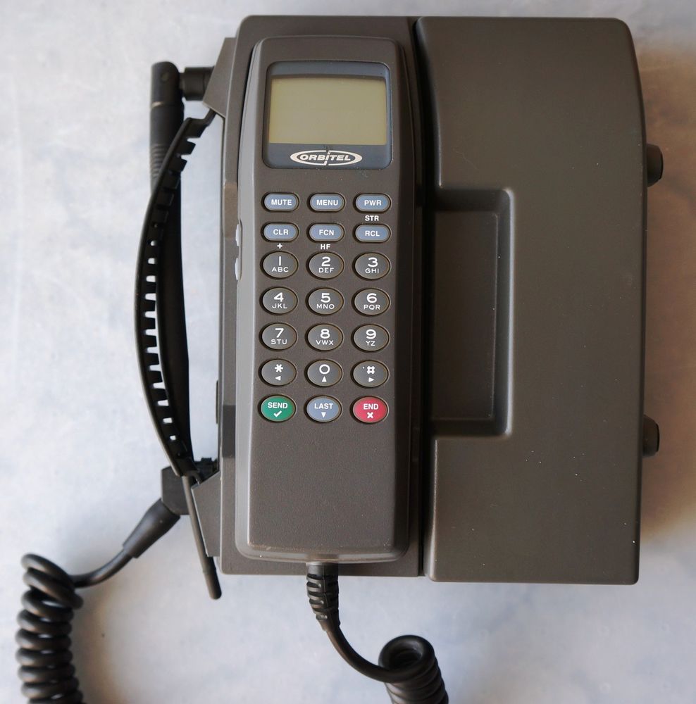

Just imagine if Bob Pease designed the iPhone top to bottom.
Would have great reception from the middle of the Saharan Desert and look like this:
No way. That is way too neat 'looking' for a Pease prototype.
I actually have one of these. Proper hairy chested 8W manly phone. Note 15 years from this to the iphone. Pretty good progress!
