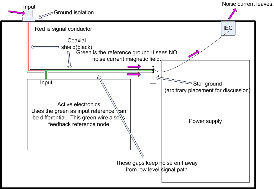

Attached is one of the diagrams linked earlier from the 2013 discussion on loop areas. The bit that raised my eyebrow on this was 'can be differential'. This just got a bit heavy as it is saying that AES48 is not optimal and there is a better way than pin 1 to chassis, only to chassis, do not pass go, do not collect $200. For a diff and balanced input into an INA this is causing some head hurting.
I then realised that my soon to be (at least as soon as they are boxed) amplifiers use a very similar setup. In this case because it uses the Whitlock THAT input receivers with the full data sheet EMC diodes, so the shield link was necessary.
It still feels wrong though to increase the impedance from shield to ground in a balanced connection. So why is that good and how does that scale when you have >1 input and an output?
I take advantage of the fact that a cylindrical shield has no internal magnetic field caused by the shield current. So, I kept the shield grounding connection to IEC chassis, but figured out how to prevent that current from getting into the signal.
I am not familiar with the Whitlock thing you mention, but had passed this drawing to him in my discussions with him about errors in his presentations, so he may have adopted something I said..who knows,
Ps. In the past, he was always concerned with IR drop and current, but never with current vs loop area induction. It was that coupling I stressed to him.
Jn

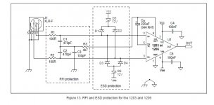

The Whitlock thing is this http://www.thatcorp.com/datashts/THAT_1200-Series_Datasheet.pdf in particular the attached RFI and ESD protection. In the power amps I have this is on the amplifier board for practical reasons.

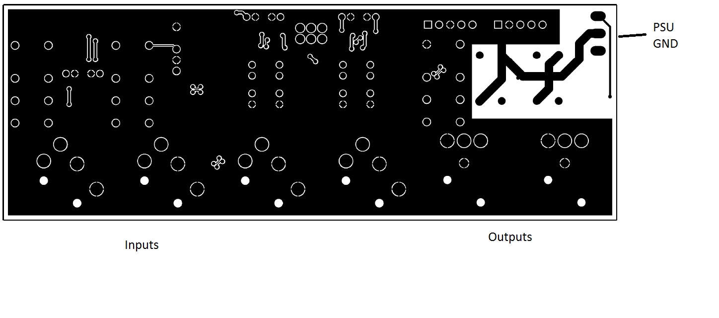

Also attached is the gnd plane from the balanced demo project Bruno Putzys did for his 'G-word' article. This is quite popular with the DIY crowd and seems to work well, plus the design, reasoning and gerbers are all available. In this case all pin 1s are on the ground plane and any direct ground connection is back through the input from the transformer. BUT the XLR used do have a seperate shell connection, so if you have a metal panel then you have a connection there as well. (NC3FAH2 - Neutrik).
So for the case of inputs and outputs is this the optimal method or is there better?
Hey, it's from one of the best, how can it be bad??
My area of concern would be how the shield currents couple to either of the differential lines, or to any circuitry within the amp.
It's great to simply draw a symbol to get the shield currents taken care of, but the devil is in the details of how those currents get from that input connector to the IEC ground . If those currents flow within the chassis metal, does it go past sensitive circuits? As the shield current goes up in frequency, how does the chassis current path constrict? Does it get closer to sensitive stuff or farther?
jn
