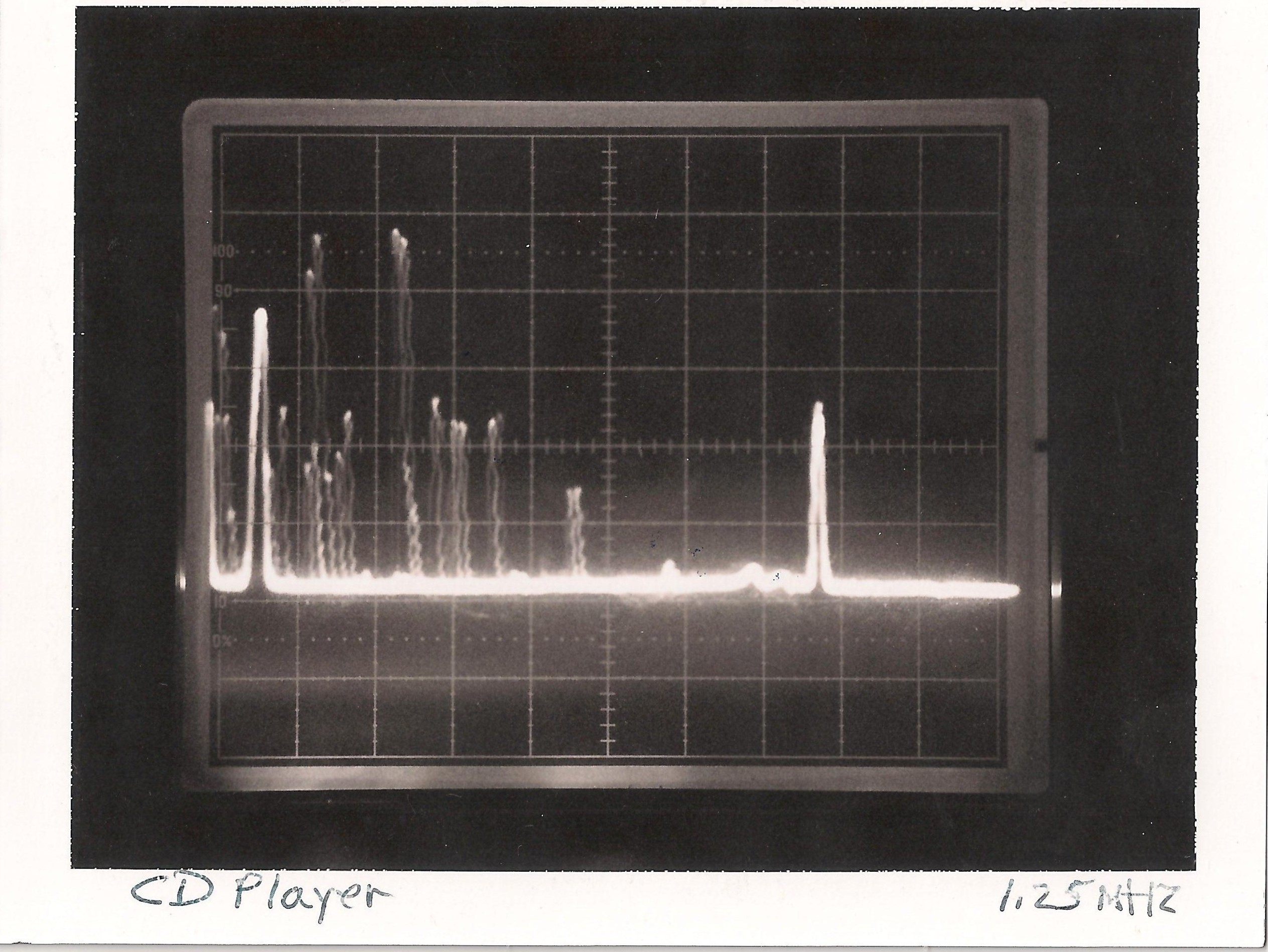

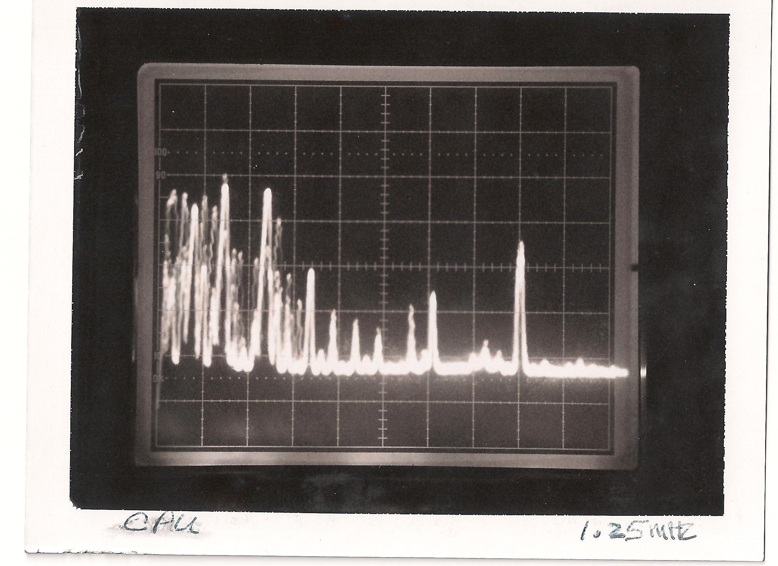

OK. Here are two examples: A Computer and CD player. When you monitor the power cord with a spectrum analyzer you get these freqs (to 1.25MHz) and 100uv at base and 10db per division.
When Computer is OFF, there is no signal.. base line. Turn the Computer ON and you get this junk. Some strong idle tones.
Here is a CD player --> not playing... just ON.

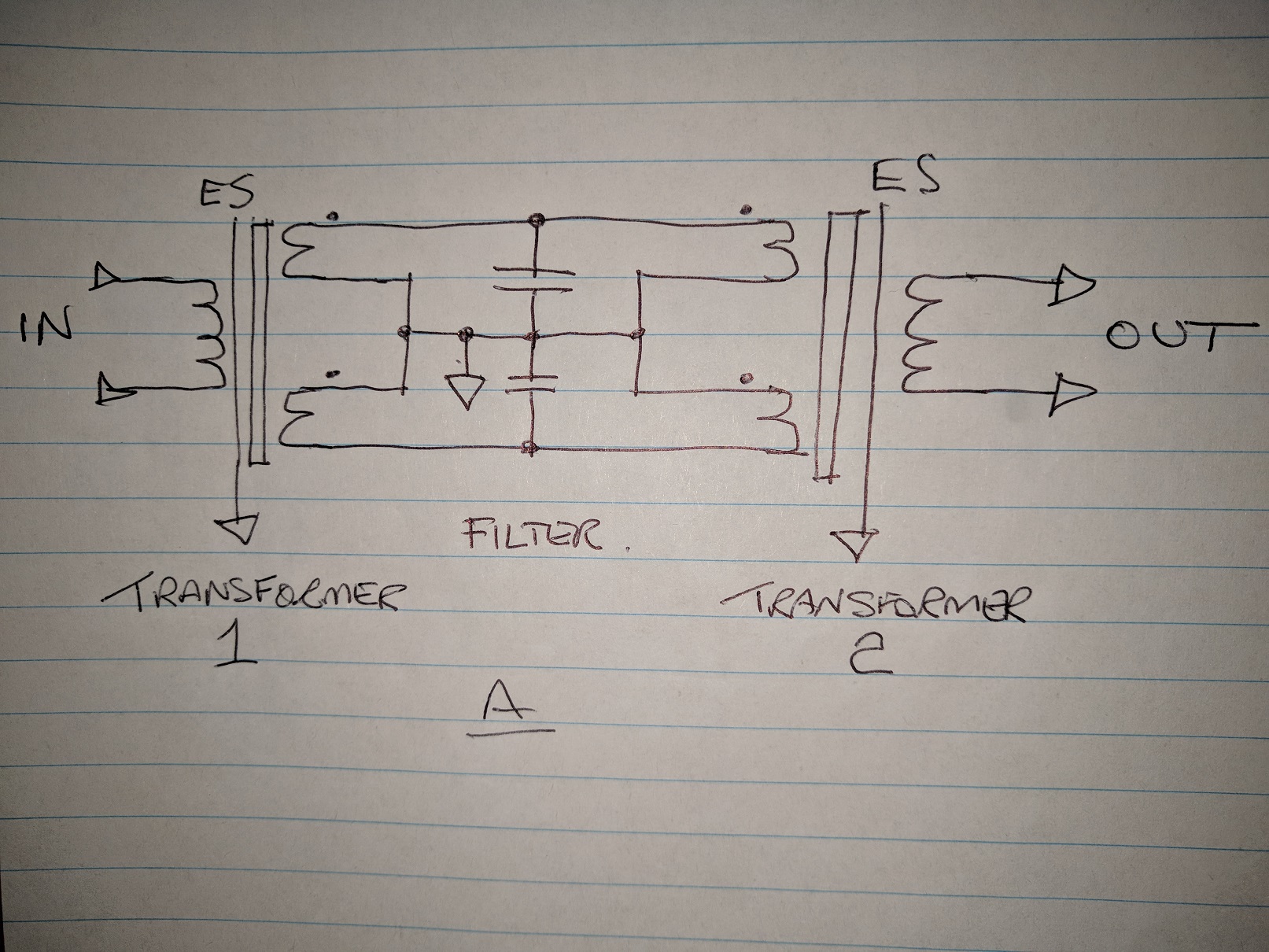

If you do not use the exact type of transformer I said, you wont get any where near the DM and CM numbers I get. But, yes, there is another ingredient which improves the rejection and isolation a lot and to higher freq. No, I'm not telling. But, as told, you will get very good results especially with the filter included in between.
One reason I rarely suggest doing something in detail is because HERE one only gets arm chair critism without trying it... without listening.
THx-RNMarsh
There are certainly a few ways to implement this arrangement of back to back connected transformers. Below is one way that would net good results. The interconnection is balanced as is the filtering. It might also be worth using an RC snubber in there.
The best transformers from a noise isolation POV are split bobbin = low P->S capacitance. You can go further with electrostatic shielding and even further with full Farady shielding. I've actually made these on split bobbin transformers as I used to work at a specialist transformer manufacturer.
If you do ES or Farady cage on split bobbin watch out for shorted turn. There needs to be small slit in the shield / cage.
T
Yes, that has potential, also. I also stated the split bobbin like I show and said is needed.

What are the axes on those measurements? And how did you couple to the power cord?
Thanks...
Wide band Inductive probe coupled to network/spectrum analyzer.
