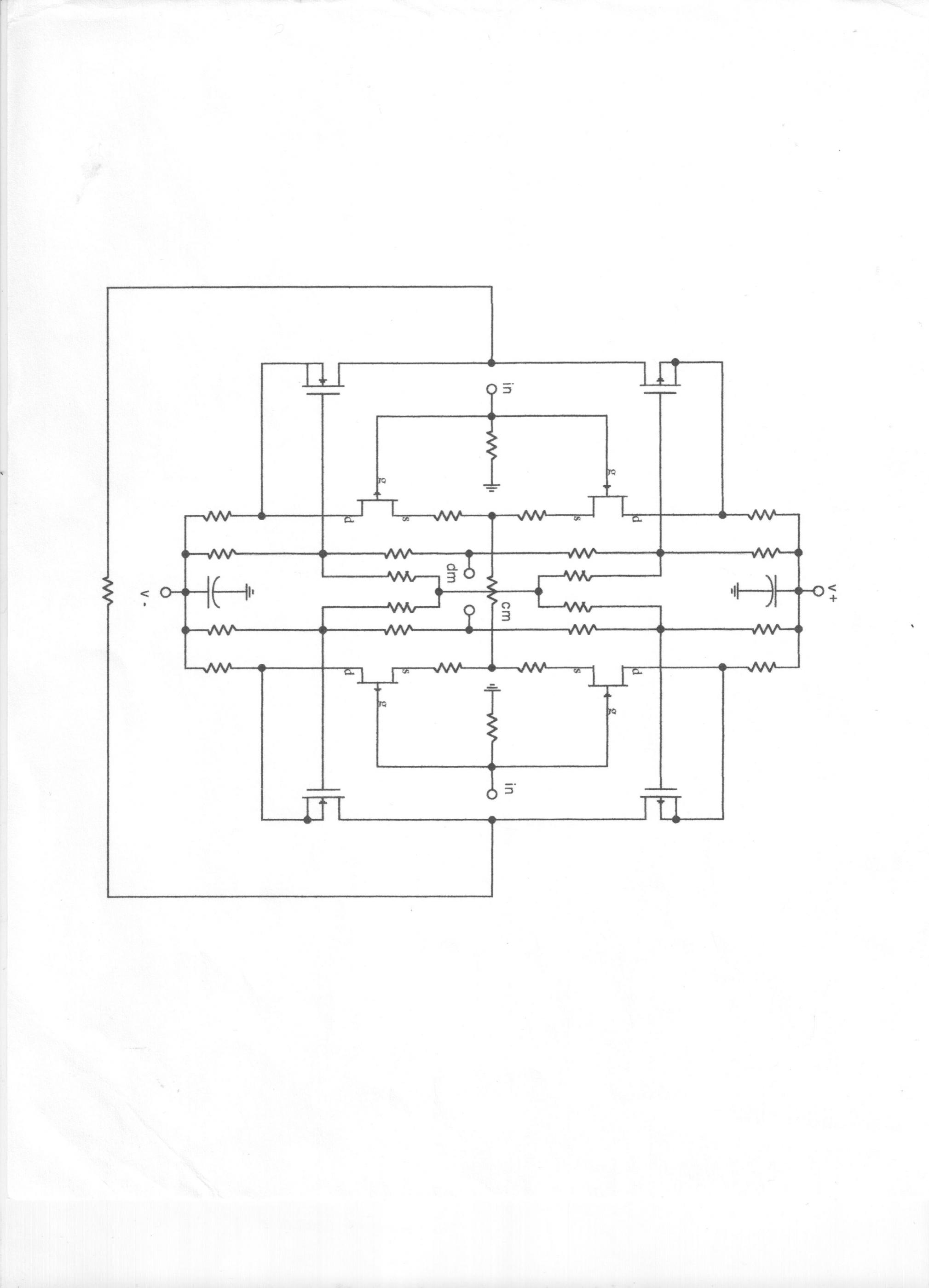

I personally made a break-thru today as well in achieving good enough open loop performance in a modified Blowtorch line amp configured to be an I-V converter. My problem, as always in these cases, is trying to achieve acceptably low distortion without using a serious feedback loop. I do add a little loop feedback, but the open loop bandwidth remains very very high, which is equally important to me. Now for listening tests. I am not the first to do this, of course, the late Charles Hansen did it with his digital-analog circuitry as well. I will try a modified OPPO105 first, then use the OPPO as a transport and use an evaluation board made by ESS using a 9038 and a conventional IC based I-V converter, then I will splice in my open loop 4Q design that should be as simple as a tube stage in thru-put , but made of fets only. If I cannot hear any difference, I will not bother to go forward with the project. We shall see (or should I say, hear). '-)

I use Borbely’s modified all discrete jfet/fet line amp as the IV converter with 75 ma output stage bias current. Direct coupled with DC servo, bettter quality resistors, shunt regulators. Oppo as a transport. Big, big différence over any op amp tried in the IV stage, you will go farther................
I glad to see that several of you are serious about discrete I-V converters for the OPPO, etc. Most everyone, except for the tube guys seem to be stuck with IC's, except us! '-)
I am using something more close to the schematic that I put up recently, and finally got the distortion below 0.01% nearly pure third harmonic at full output digitally.
