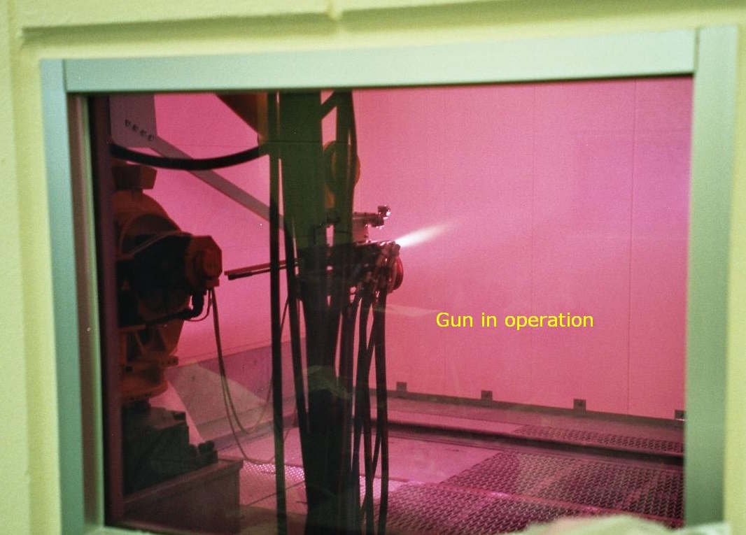

I have seen a plasma gun used to spray aluminum to metalize a whole bunch of capacitors ends simultaneously. It is really loud ! Makes a terrible racket.
-RNM
We are spraying ceramic trays, which is a kind of kiln furniture, used for firing MLCC's.
