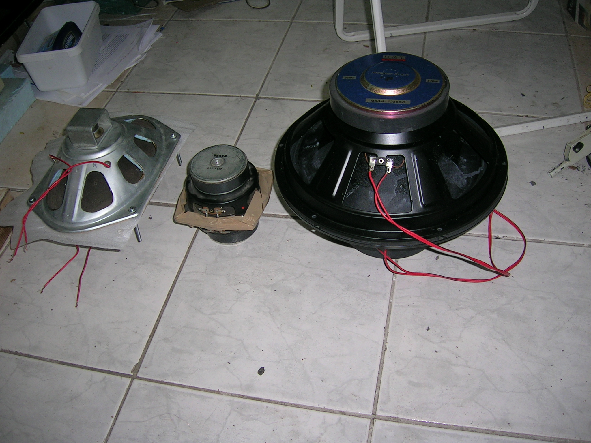

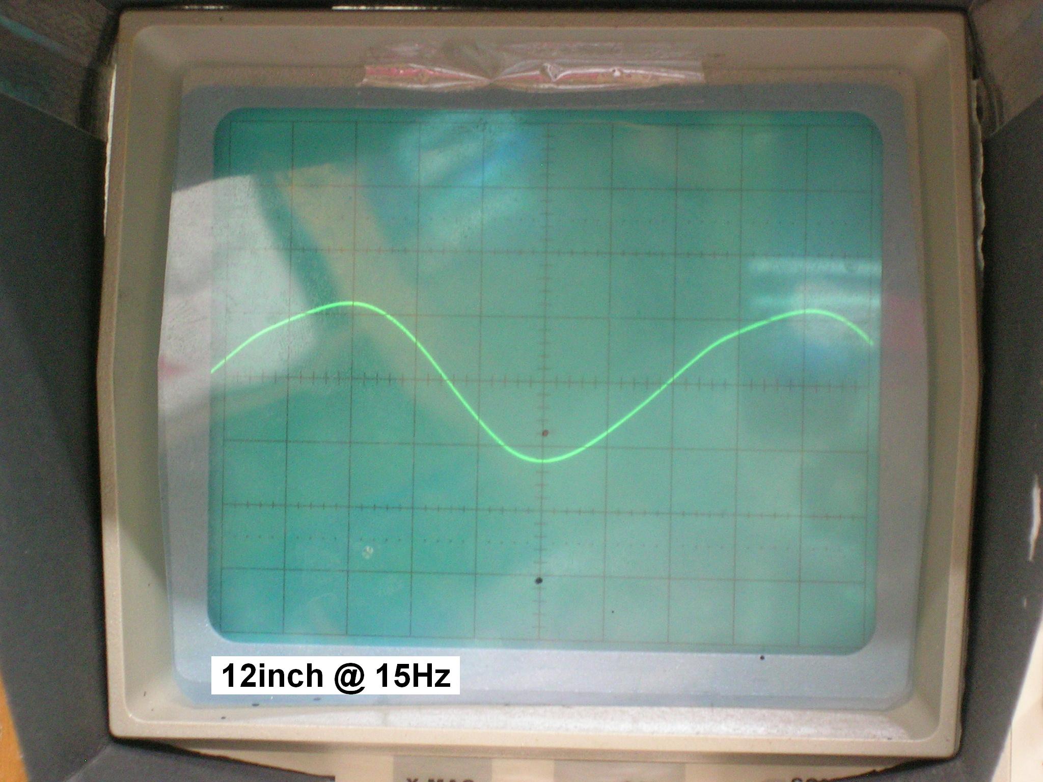

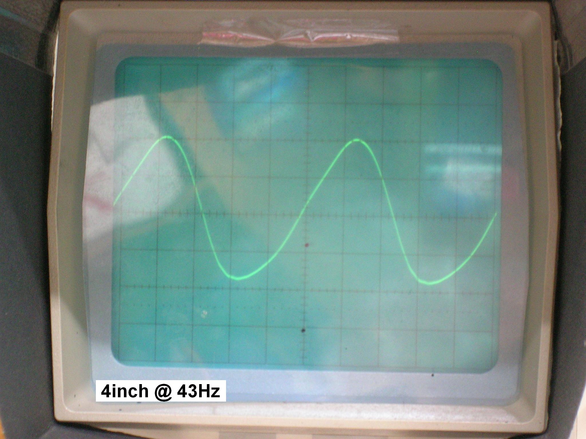

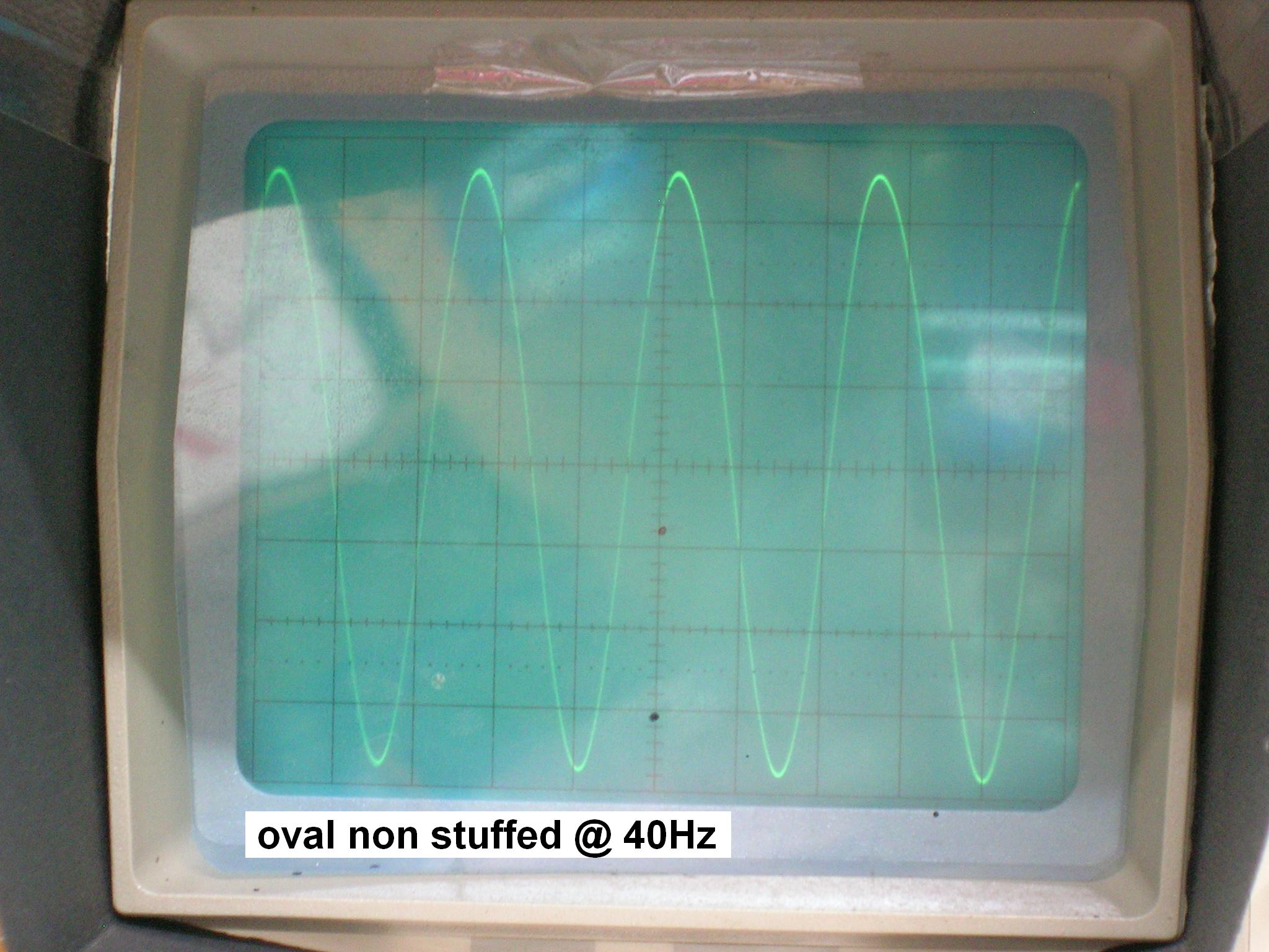

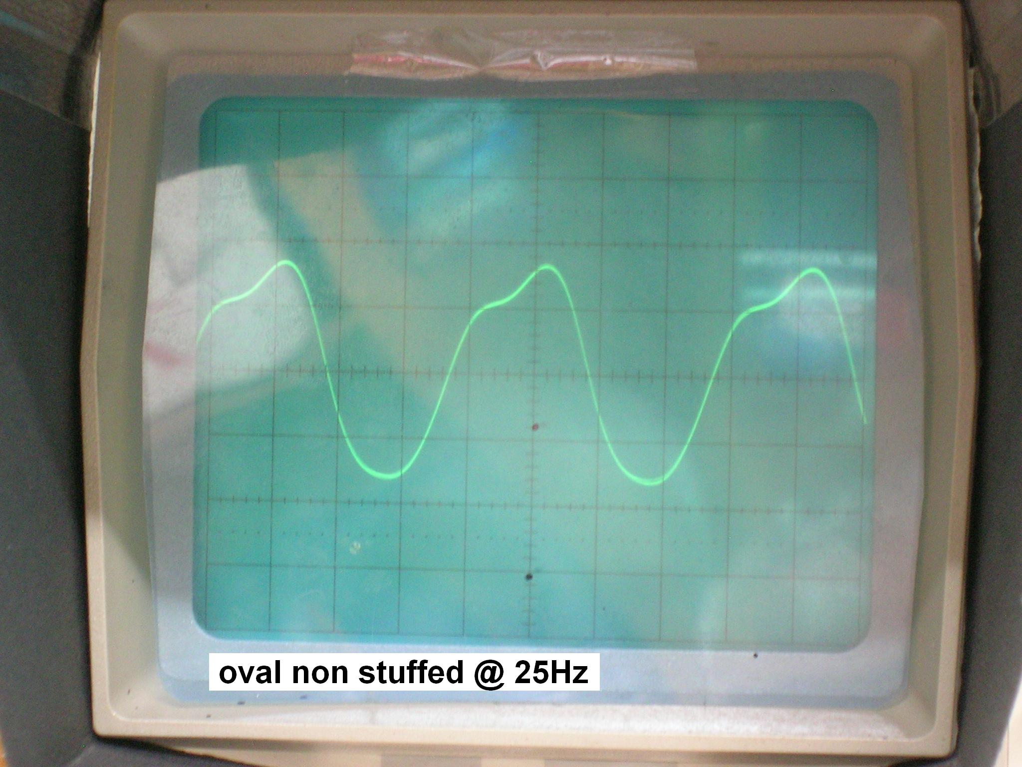

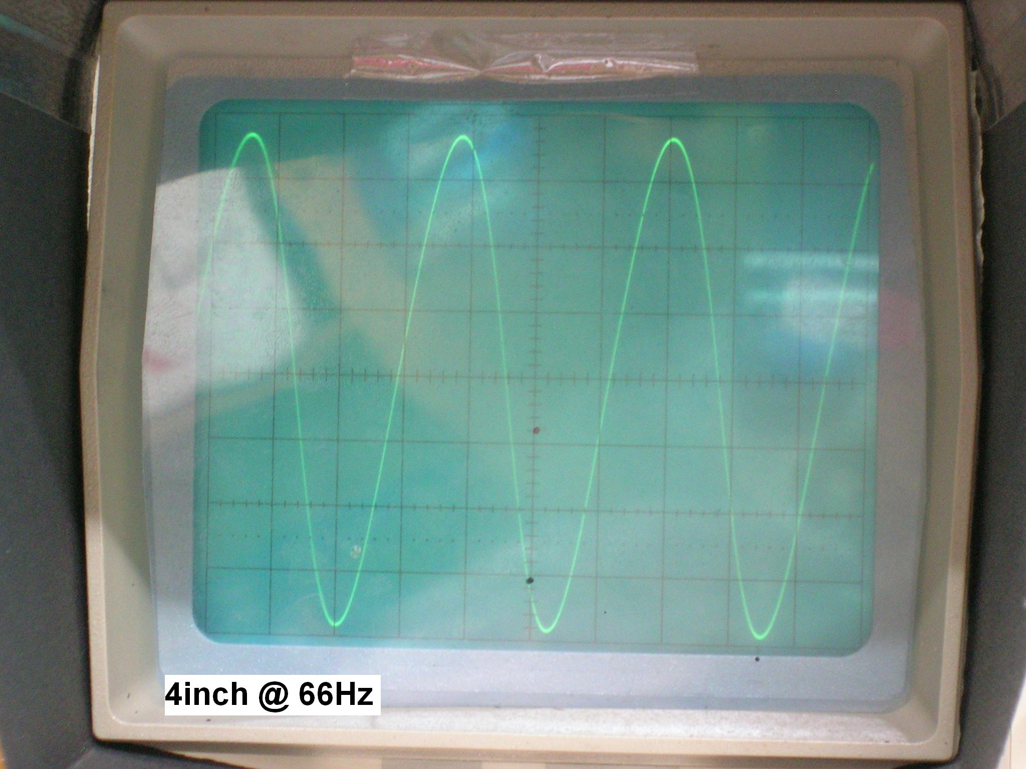

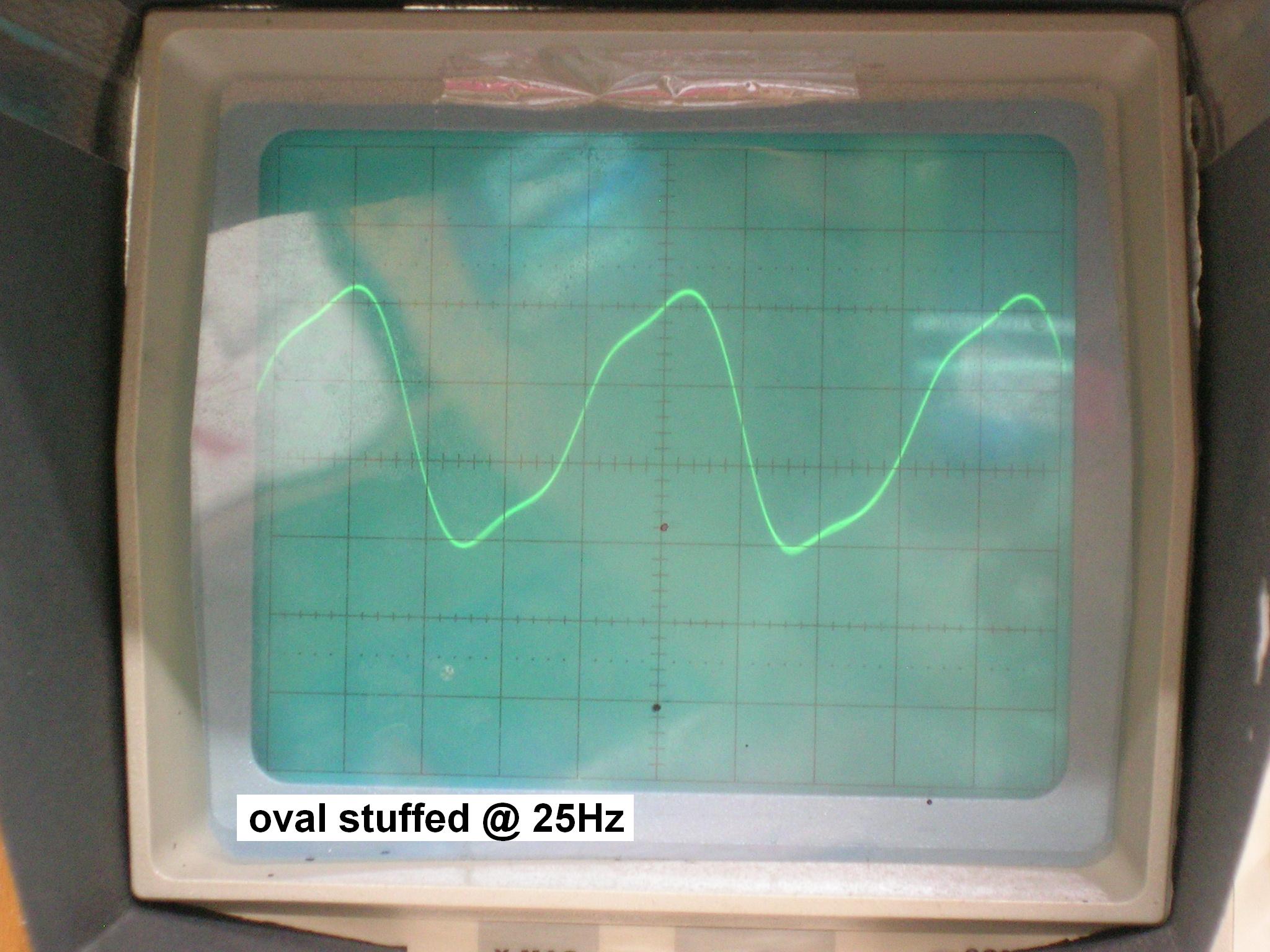

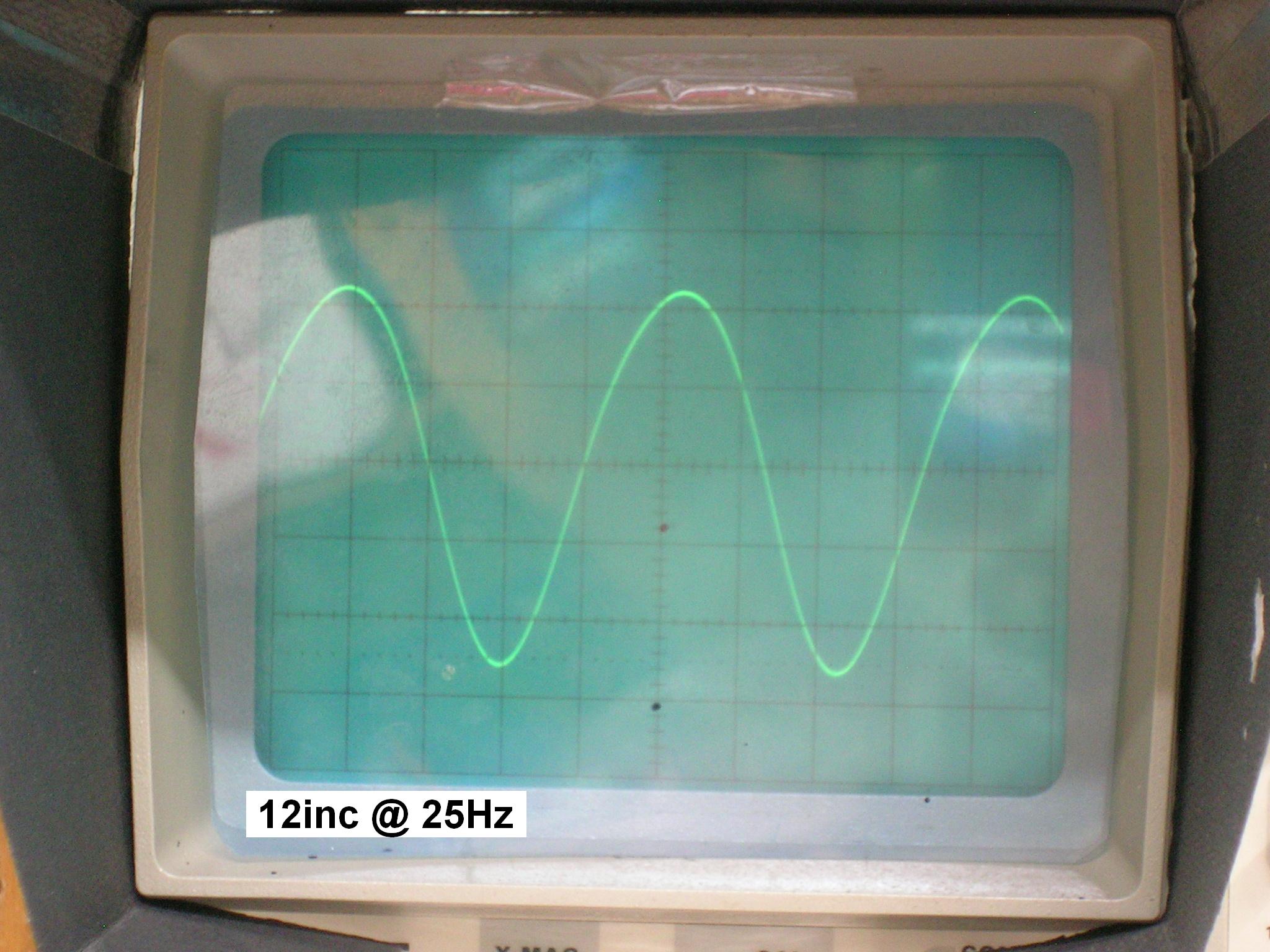

I tried to estimate the excursion by monitoring with an oscilloscope the EMF of the driven speaker.
At low frequencies, approx 1/2 Fs and below, the waveform produced by the EMF is distorted.
I checked it with three different speaker pairs, the oval (Fs 73Hz) , a 4inch mid woofer (Fs~100Hz) and a 12inch mid woofer (Fs~50Hz)
The compression – rarefaction of the air enclosed btn the two cones is not symmetric at these low frequencies.
Exciting like a novel ...The compression – rarefaction of the air enclosed btn the two cones is not symmetric at these low frequencies.
Why such a dissymmetry with such a small change of pression ? Asymmetric deformations of the speaker's suspensions ?

Any time the magnitude or phase of one cone is different from the other, the pressure and volume between the cones experiences changes. This modulates the compliance of the air cushion, generating distortion.
I don't know how much of a factor cone deflection is in the nonlinearity. However if both cones are moving in phase then the distortion would be minimized. Then you could simply decrease excursion to reduce the contribution from the suspension and cone deflection.
The compression and rarefaction of a gas enclosed in a variable volume is symmetric only if the state change is reversible, i.e. lossless.The compression – rarefaction of the air enclosed btn the two cones is not symmetric at these low frequencies.
If waves are generated, the compression and rarefaction ones always have different shapes, and their superposition can generate all sorts of waveforms.
