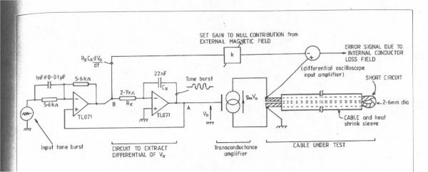

Actually, he used the planar wave equation to calculate the depth penetration of an em wave into a planar surface. He did not do so for a cylindrical conductor carrying current.Dr. Hawksford developed an elaborate theory on wires based on Maxwell's Equations.
He built a test setup, and used a scope to look at the current. What he did not consider was the severe problems associated with very low impedance circuits and high dI/dt. Since he had no experience with such demanding tests, he was unaware of what he actually got as a waveform.In the end, he found a 'glitch' that could be created under some circumstances that would normally be ignored.
He modeled his theory of wires with Mat Lab or some such professional program and got the equivalent picture of what might look like an oscilloscope photo.
As I stated, I have encountered such a waveform myself using a 250 micro-ohm CVR, and detailed how to remove the field collapse generated voltage by way of symmetry.
problem?? no problemo...Then he proceeded to make an ELABORATE physical experiment that would MAGNIFY the 'glitch' to the point where it could actually be seen on an oscilloscope screen, AND he got virtually similar results as predicted by his theory and emulation.
What is the problem then? [we will leave that for further discussion]
1. Use of a planar wave equation to calculate the amount of energy returned to the system when the current is turned off INSTEAD of the calculation of the system inductance is incorrect. He attributed the inductive kick at the end to a storage mechanism within the wires as a result of a planar e/m wave equation. His more serious detractors stated that wave penetration into a conductor ends as losses, not energy that ends up kicking back like an inductor.
2. Use of a wire with a permeability of 100 instead of the copper wire alluded to in the article means that he neglected the internal inductance of the wire, that is 15 nH per foot times 100, or 1.5 uH per foot, 3 uH per foot for a wire pair as he described testing. For a meter long run, he will neglect about 10 uH of inductance. Fast turn-off of a sine will result in an inductive final kick EXACTLY as he showed on his scope photo. You know, the one with no indicators as to amplitude or timebase.
3. Measuring any high rate of change current in a very low impedance circuit requires attention to details. The most important aspect of a current viewing resistor is the field storage of the resistor, and whether or not the v taps see the field ala Faraday's law of induction. When the reactance of the viewed circuit at a slew rate swamps the resistive drop of the current, and is ignored, the results MUST be suspect.
It also doesn't help that the article was published in 1985, immediately duplicated by the magazine's owner (I believe this was JA's statement) with results which in NO way supported Malcolm's results. To this day, his poorly documented results have never been confirmed by any human.
It's what, 26 years now?
Cheers, jn

ps. I have attached the test setup provided by Malcolm in the original article. Note where the difference is being taken from. Note the statement "external magnetic field".. and note that if there is 10 uH of inductance within the loop that is neglected, the output will not be null.
