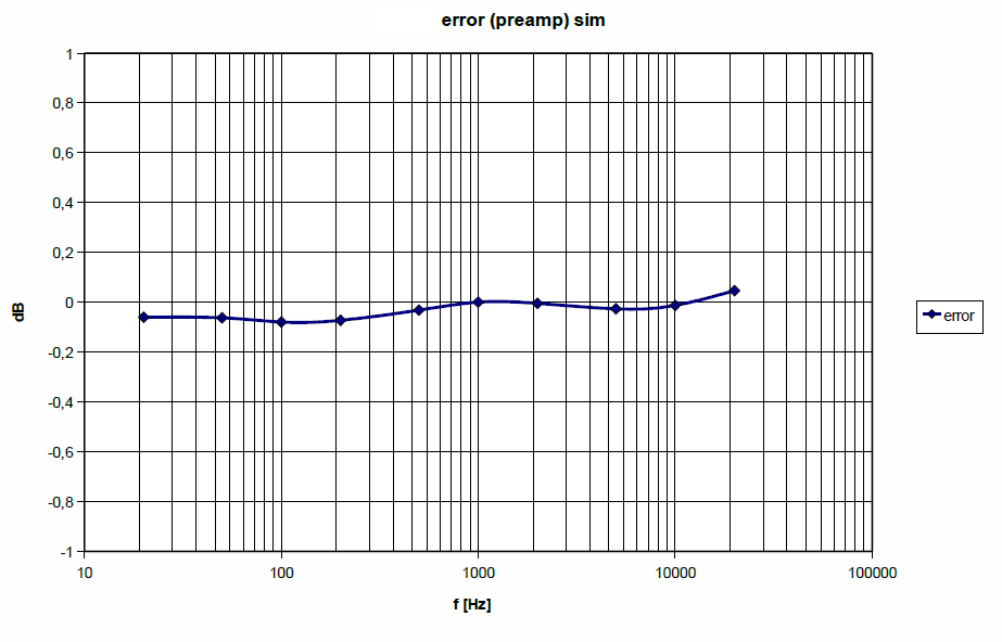

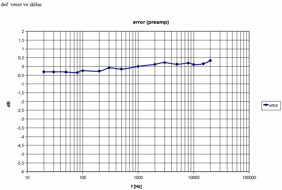

Still, it is not 'easy' to build a very accurate RIAA. It takes 1% caps and resistors, and a certain amount of 'cut and try' for final adjustment. It also takes really good test equipment, AP is good, but not the only reference.
I use an HP 3563, that can resolve to better than .01 dB to do final selection of the 1% or better (0.5% for Vendetta for example), to get it as close as possible. Just an engineering tweak, because I doubt that anyone could hear even a .2dB difference with real sound reproduction.
It depends on how wide a bandwidth is covered, John. I was once testing a speaker where the tweeter level could be adjusted in 0.5dB steps. In single-blind listening, the optimal HF balance fell between two of the settings, one being just a little too hot, the other being just a little too dull. A difference of just 0.25dB covering the tweeter's passband therefore appeared to be significant.
