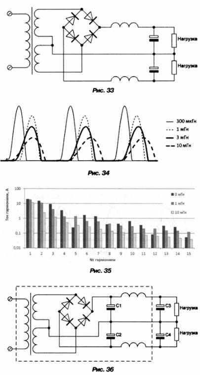

I would like to attract attention once again to chokes in power supplies of AB amps. Maybe some substractions from a textbook (its in russian) could help me to explain the point: chokes (10mH and more) help a bit to have more favorable spectrum of charging pulses, but they do increase voltage drops at filter capacitors during current consumption peaks and affect negatively sound dynamics.
As a conclusion, chokes are not recommended for AB amps, except for maybe configuration shown in fig.36, with external or well screened part of PS, and with abnormally big C3 and C4 (in order to compensate negative effects of chokes)

Pavel, I do not intend to teach anybody, this could have sence for persons like John and some others.
I share my subjective listening estimates of some conceptual solutions, concerning using chokes in power supplies of AB class amps. And my conclusion supported by many independent persons, including conclusions in textbooks. If one insist in using chokes, and achieves low voltage drops at transients, than L value is quite a small and one looses an initial target - suppression of HF PS voltage components.
Some people do accept bigger voltage drops during transients, they realize that sound dynamics can get worse, but they compensate it by positive effects of high L chokes, sound benefits in mid and high frequencies ranges.
Other than citing a number of Russian audiophiles (and clearly not the crowd formed around the Russian Sound Practices (Vestnika Ara) you have nothing supportive.
In fact both real circuits and simulations illustrate the reverse of your claim.
Now it is entirely possible that all of this started with someone who had little electronic understanding and was told "choke input supplies are better than capacitor input", then willy nilly stuck in some chokes and produced a mess that in essence did not work correctly. There are stories like that. They get repeated and become audiophile axiom's. I cannot comment on these in any reliable way, as they are all just chinese whispers.
I can only repeat, a correctly designed choke input supply offers better regulation (less voltage drop for a given change in current draw) than a capacitor input one, however the mains transformer windings need around 1.5 times the voltage used for capacitor input and the current drawn must not fall below the critical value.
Realistically, decent input chokes for 300B Amplifier are really big chunks of iron to work, the ones for a really high power class AB Amp would be humongous. But that says nothing about the underlying principles, only about implementation difficulties.
This is incorrect, one needs quit large (in the context) values (sizes too) of chokes for choke input supplies in order to achieve low voltage drops at transients, lowering the choke values increases supply line drop during periods of increased current draw.
This is EXPLICITLY NOT why Choke input supplies are used! Choke filters, using a suitably designed filter choke are what is used for this. Input chokes behave as exact analog to a PSU Capacitor, namely as means of energy storage. Energy may be stored in chokes or capacitors, both approaches are valid.
This is a highly subjective description. I have noticed that often when audiophile speak of "good dynamics" they actually mean "more compression" in terms of what is actually is happening.
To tie such subjective comments back to any technical features of choke input supplies (or any particular design feature) is rather difficult. It normally needs a combination of highly experienced and unbiased listeners who have an agreed descriptive vocabulary (so they describe compression as compression and not as "good dynamics") and extensive listening tests.

One experienced designer wrote the following about the chokes in power supplies:
"When simulating power supply in the spice, I usually consider the behavior at the three kinds of varying loads:
1. Step, up and down. Gives the pulse response.
2. Sine over the constant level. Allows to estimate cross-modulation and dynamic nonlinearity.
3. Smooth ramping of current consumption from the minimum to maximum. Gives information on the linearity of the static characteristics.
The result of the first test should be aperiodic and preferably similar to the steps up and down.
The results of tests 2 and 3 are considered together. If the static and dynamic characteristics do not match, there are inertial-harmonic distortion. In this case, bass dynamics suffers and its legibility. This applies more to amplifiers with high modulation of current consumption. For these amplifiers, the most satisfactory result is obtained with the optimized CLC filter, it can be the best way to link together the static and dynamic load parameters.
LC or LCLC filter is better suited for amplifiers with low modulation of current consumption in the amplifier, where there is an active device loaded by current source at the output stage.
LC and LCLC filters have worse dynamic characteristics than static, which will be evident in the reduction of fidelity in the bass, and treated only with a significant increase in filter capacity (like Makarov), which brings the problem to infrasonic range."
Thorsten, I can can not manage to find any minor confirmation that LC filter could be good solution for AB amps (at the same time, it's the best solution for SE class A amps).
