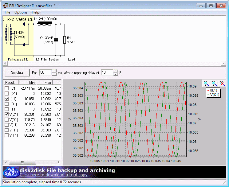

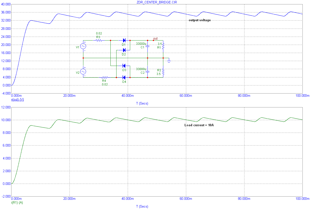

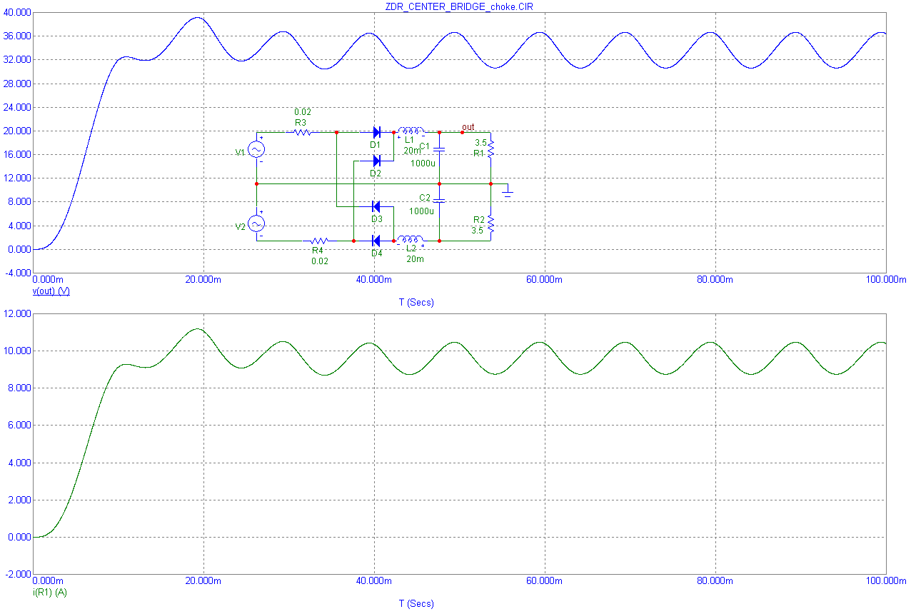

They are 100x per second charged by the rectifier.
Correct, and every charging pulse must deliver 0,1 Coulomb, what can be hardly achievable with typically 2H choke standing just after diode bridge. This is clear, that voltage drops at the capacitor will be larger with choke than without it.

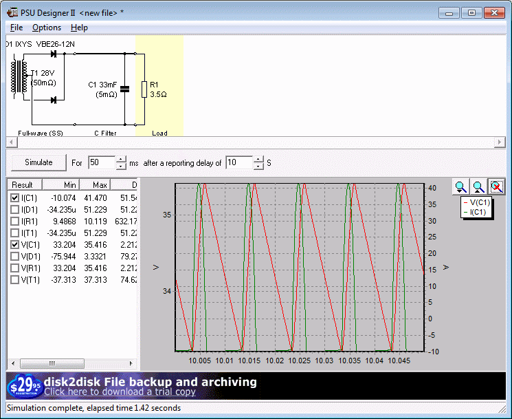

I think you need to read up on the theory of choke input supplies. The 2H choke can supply as much current as you want (limited by DC resistance of course). It can still provide current going forward even when the choke itself is reversed biassed, so it holds the rectifier on for longer. Choke input supplies do not have the narrow charging pulses of a cap input supply.

Actually, IF you had a 2H that would not saturate at 10A it would do that splendidly. Pavel showed one supply, allow me to up the primary voltage, add 2H inductance and use Duncanamps PSUD for simulation.
Attached is one PSU like Pavel's Sim, showing the charging pulses through the capacitor and another with the 2H Choke added, which shows the current through the choke. The ripple is mostly a sinewave and the charge current is mostly DC. If you looked at the current through the Diode you would see that each diode conducts a constant current through it's halve of the mains cycle...
It is also worthy of note that the ripple of the capacitor input version is around 2V Peak-Peak, while the choke input supply has a ripple of a few mV peak-peak.
The reason is that the energy storage in the supply has effectively moved to the Choke, from the capacitors, who now have not much of a job. In fact, if you have a constant current draw circuit to supply, you can completely dispense with capacitors and use only inductors and shunt regulators and get a perfectly working supply!
Yes, it will be, because the output from a Choke input supply is around 0.9 * VRMS while a capacitor input supply is 1.41 * VRMS, approximately.
However, if resistive losses in the choke are contained the choke input supply will hold it's 0.9 * VRMS output by far stiffer (less variation in Volt for a given current variation) than the capacitor input supply holds it's output voltage.
