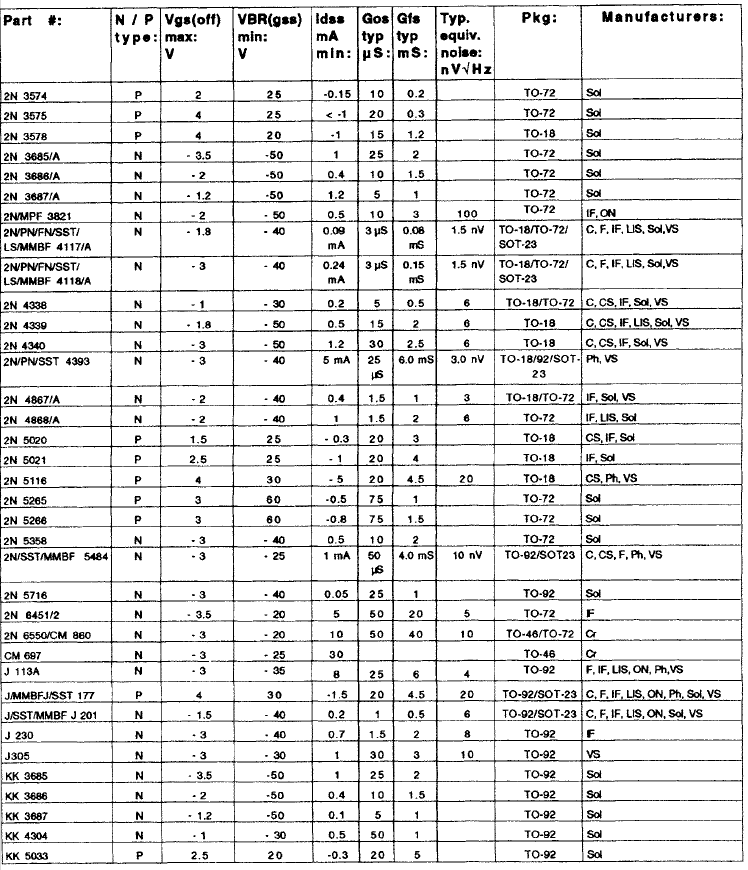

Recommended jfets to use as current sources, from the same book. (For those who prefer this solution.)
