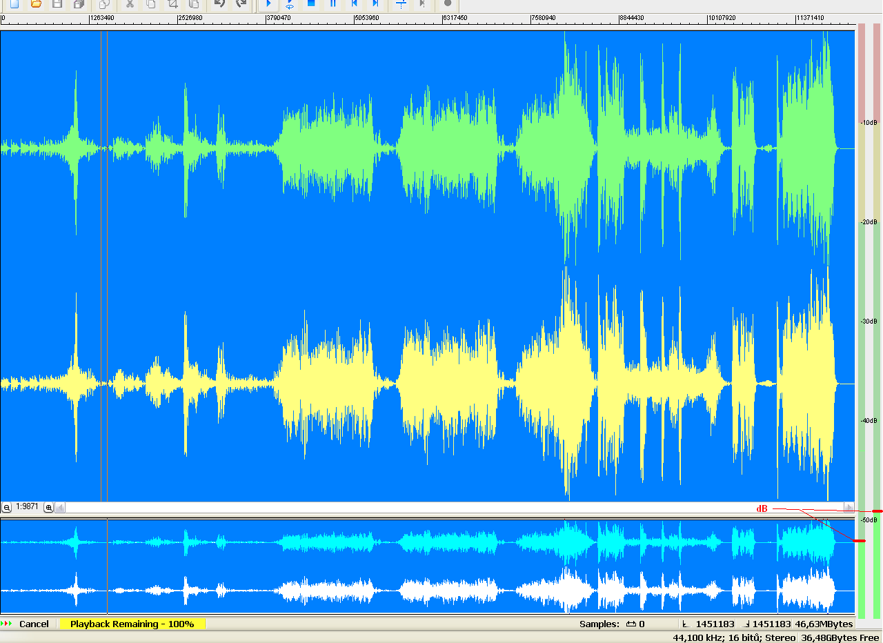

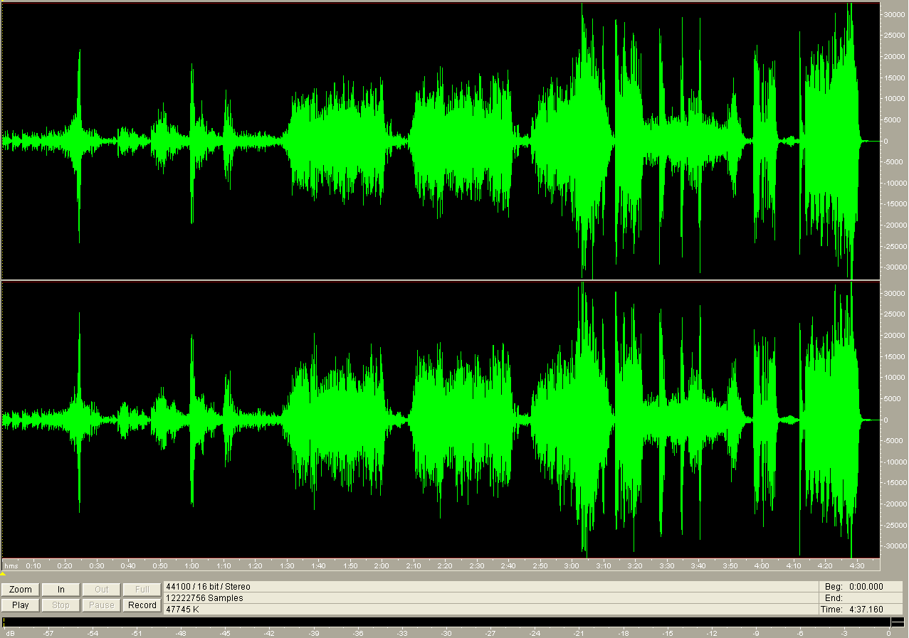

Ed what do you use as a rule of thumb for crest factor? 12dB is pretty wimpy that puts us at a peak power of 2600W, 15 dB and our PA is 5200W.
So you folks like the sound of clipping?
10 db is bus station paging, and rock concerts
20 db is almost everything from churches to college level performing spaces
30 db is live symphonies, past that I don't hear a difference.
The caveat is places such as NFL stadiums require 105 db "A" maximum SPL but 10 db headroom for announcements and 15 for music during the game and 20 for pregame. (Subtract 10 for colleges and minor leagues.)
Now those numbers are for live performances from pros. Amateurs may suddenly eat the mic and require operator gain control. Recorded music is 20 db for analog sources and 0 for digital, but digital 0 is often equal to analog -12.
Normal home listening is 75 db with 20 db of headroom. Headbangers may want 95 and 15. Then there is the fellow on this site who wants to hit 140.
The use of digital has really reduced the need for headroom in reproduction systems. It really is hard to duplicate a stylus drop or record warp power requirements.
Hi Ed,
it is more than 30 dB, even for recorded symphonies. Much more. Depends.
