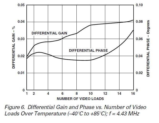

Yes, Joachim, Video is VERY sensitive to it, so it is measured and on the spec. sheet. Guess what, the AD825 is measured and put on the spec. sheet, but it is fairly lousy compared to many other video amps. The AD797 does not have this measurement on the spec. sheet. Perhaps Scott can give us the measurement value. This is the heart of the matter. It is a standard test (video).
Yes at 3.58 MHz and has little to do with audio. BTW you can rig up a network analyser to do this measurement directly to far better resolution than anything but the best Tek video test gear.
AD8010 is the best, that's 16-150 Ohm video loads at once (9.375 Ohms) in an 8 pin DIP 0n +-5V. :)
