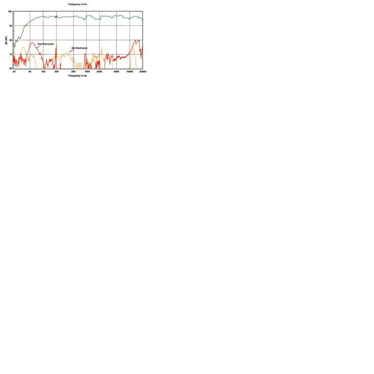

Right on Chris. As Nelson Pass likes to say: The first watt is what really matters.
He is right, but there is absolutely no problem to make the "first watt" absolutely clean, speaking about non-linear distortion. And again, even at low power levels the speaker will distort 30 dB and more above good amplifier, at any distortion frequency component.
Here is a really lousy image I got from JBL. The distortion levels are raised by 20 db to make it easier to see them. Second and third are shown. They are around 45 db down from the test level of 2.83 volts input, nominal 1 watt. Measurement is at 1 meter. Level is calibrated or around 96 db spl.
Distortion is down by about 45 db re power. As amplifier distortion is often given as % of output voltage, be sure to include that! (.00316% voltage distortion would be -45 db power distortion.)

I have mentioned before that an enlightening test is to use one channel of an amplifier to drive a real loudspeaker and have a second channel drive a resistor. Looking at the difference on music with a digital scope set to trigger on transients shows a whole lot of difference on amplifiers with similar THD or IM plots.
This test is a good one, but it is VERY important to measure the small-signal frequency response of each path first. If the damping factor of the amplifier allows the speaker load to influence frequency response by much, then the resulting difference seen in this test may just be due to frequency response as opposed to some kind of nonlinear behavior.
Although frequency response is important, it is very important to be able to distinguish between listening results that are due to frequency response differences and those that are influenced by other differences. I wish reviewers would measure in-situ system frequency response AT THE LOUDSPEAKER TERMINALS after their review.
Ed, these calculations don't look right.
By -45dB power distortion, do you mean 1 watt / 178 = 0.06 watts ?
