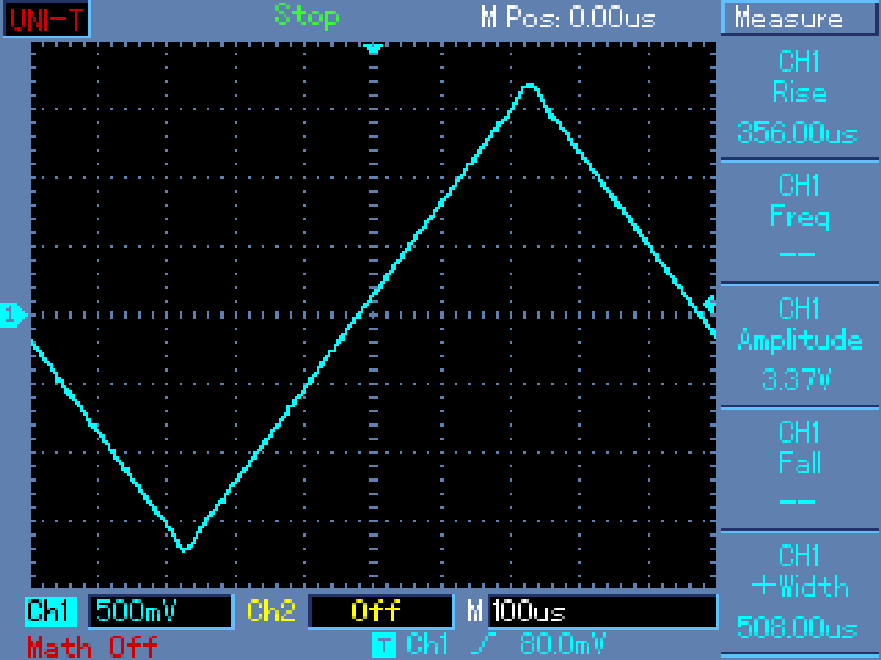

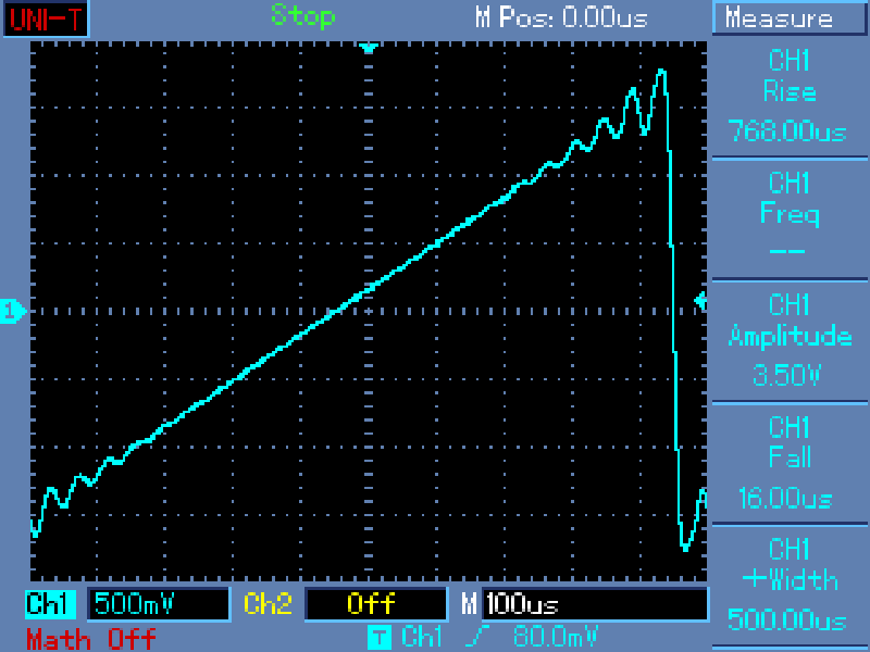

What is the provenance of your triangle? Since you started with D/A before A/D, it's worth asking whether you just generated a triangle as data without consideration for aliasing. Instead, if you created the triangle as a sum of sine waves, all below Nyquist, then your tests were valid. I haven't actually seen the results of your test, but I still wonder whether your initial waveform data was valid.The result will be horrible (regardless we forget corners/peaks). My example of 1kHz D/A - A/D triangle was with the AKMs, 48kHz/24bit mode.
You can't anti-alias filter after the fact - it simply isn't mathematically possible.
Hard for me to accept that a small linear ramp portion of a 1KHz triangular waveform is not a valid input.
But I'm sure I'll find out now...
-Antonio
Not so much the ramp as the right angle turn at the top and bottom. Those are infinite in bandwidth, although the magnitudes of the harmonics are only 1/(N*N). If you create the triangle as a linear ramp, you'll have aliasing that cannot be filtered out.Hard for me to accept that a small linear ramp portion of a 1KHz triangular waveform is not a valid input.
-Antonio
It's fairly easy to sum sine wave harmonics until you have the best triangle wave that is possible at any particular sample rate. Higher sample rates will be 'better' of course.
Would the sine sum generated 1kHz triangle be linear even in its middle third?
The 22kHz brickwall filtering is unacceptable for highest fidelity music reproduction. No one has ever proven that this sharp frequency cut-off has no influence to music perception and sound quality. If the roll-off were slow, then there would be no big problem. As the slow roll-off is impossible for the reason of aliases, we get what we get and we can complain to eternity. "We" means probably 0.00000000001% of population, and of course the rest counts for the consumer music industry.
They are generated "properly".
'Properly' here meaning with linear phase filter, evinced by the pre-ringing. But how would they look using a minimum phase filter?

Digitally generated triangle and sawtooth. They are generated "properly". But there is nothing "proper", IMO, in the Nyquist limited 22kHz (or 24kHz) audio.
This is resurrecting ancient nonsense, IMO.
The main problem is that 44.1kHz sampling violates conditions of high quality sound reproduction. It is simply unacceptable to cut everything above 22kHz.
This is a disaster of purely engineering approach. They got an order to digitalize the sound in 20Hz-20kHz band, so they cut everything above cca 20kHz and they said they done the job. Oh yes they did, regarding Nyquist. Regarding music reproduction, we have had horrible digital for 30 years at least.
