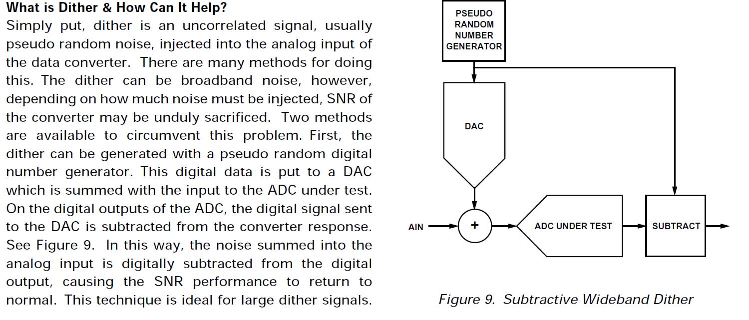

Sorry I'm done with this. As John points out the concept of subtractive dither is over 50yr. old in image coding etc.

BTW, how about you show instead the simulation of a real system, instead of making up stuff that we still have not even a feasibility analysis for. I mean someone may mistake what you posted for an actual illustration of what actual dither does in an actual 16 Bit System...
It is actually already quite obvious in your pictures...
I missed the return to the condecending tone. What I presented was text book stuff. I would think converters used to master CD's are a bit better than off the shelf and their INL and DNL are pretty close to ideal, in any case things are much better now. If you sent a complete map of the INL and DNL of your particular A/D or D/A it could be simulated, but no I don't have time.
As for the harping on FFT's, ideal TPDF dither produces uniformly distributed white noise as a residual, the spectra are not interesting on any scale. Text book stuff again.
No need to use real DAC's, all this can be done using "idealised" converters and in something like Mathlab. I lack the time to set this up.
Why am I not surprised? It's either that or someone else paid for it so it's proprietary. Gee when I use "idealized" converters it's not OK.

Scott,
What you presented had NIL to do with how things are applied in reality. Of course you DO NOT HAVE TO show things that bear any relation to reality.
I would think I personally would look up some of the real stuff and check my assumptions in the harsh light of reality, but that's just me... Others prefer to simply AssUMe...
No need to that. Instead show the Dither that is USUALLY applied and not you arguably clever and "a good idea" subtractive version. No need to include the converters as "non-ideal", it is not required for the demonstration.
A squid eating dough in a polyethylene bag is fast and bulbous. Got me?
Ciao T
Ciao T

Of course, most so-called "32 Bit" Dac's and Adc's are actually 8-12 Bit parts with dither and noiseshaping giving at best around 21 Bits ENOB with A-weighting and looking non too closely, only one current part manages actually 22Bit ENOB as DAC. But it still says "32 Bit" on the package...
