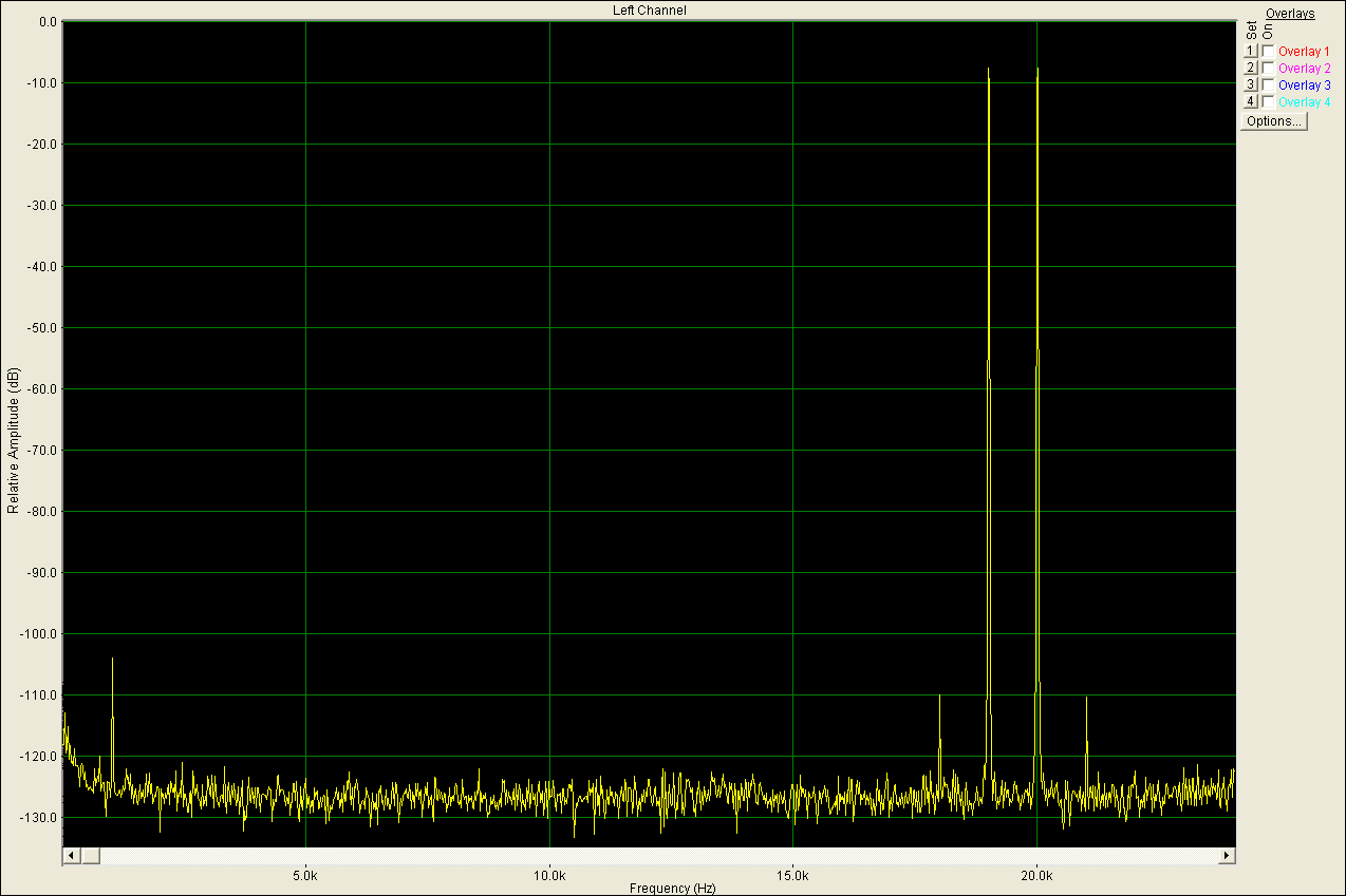

What length of acquisition window? How many bins FFT?
65536 samples per record, 96kHz sampling. 0.68s, 1.46Hz bin width. 100x averaged.
Thanks, that's almost 7 million samples shoehorned into a single jpg
Any variation in the (averaged) noise floor during the course of the test won't show up. Which I believe was Thorsten's point too. Our ears can detect noise variations over considerably shorter timescales than 68s.
With 1x averaging the result is not very different. Do you want for me to re-setup and repeat the test?
Difficult for me to take Thorsten serious. TDA1541, which he prefers, has the most of artifacts and aliases in the audio band of all D/A converters I had on my test bench.
No because 1X averaging only gives us a 0.68s window. Again its too long to see noise modulation effects. Thanks for the offer though

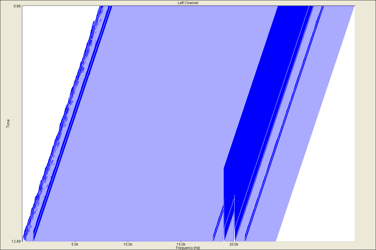

same measurement with 1x averaging. Any problem seen?
I refer you again to post #16713.
