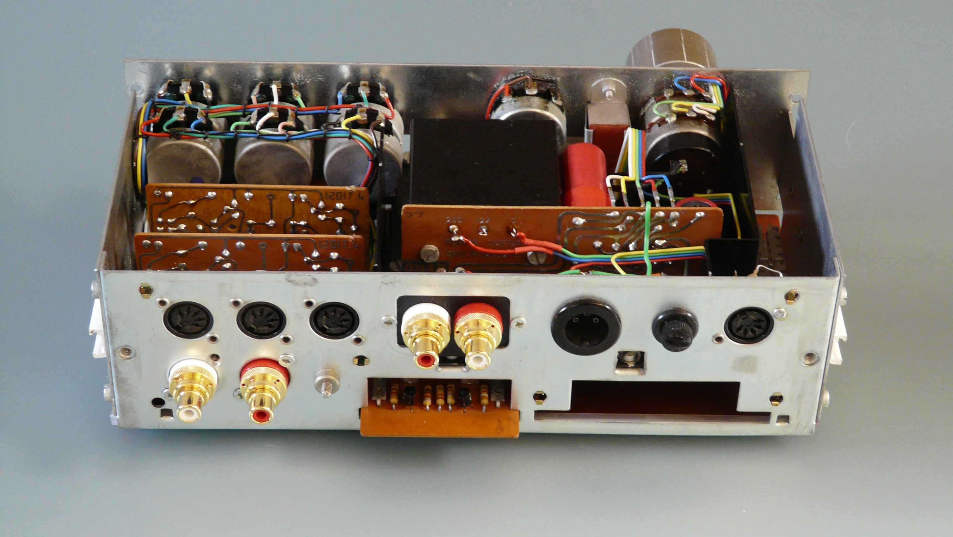

I recently acquired a vintage QUAD 33 preamp because I wanted to experiment with its particular tone control system.
But it is a nice surprise that this preamp, which uses just a couple of transistors, with a single-ended, zener-stabilised 12VDC supply, sounds so very good! Phenolic PCBs, tinned (no trace of gold!) plug-in PCB connectors, that sort of thing. Still pretty good!
I DID replace some of those unobtainium 5-pole DIN jacks with RCAs though...

Shortly I had this model for service and by perform a soundcheck I agree with you. BTW - great work concerning refitting the thick WBT's.I recently acquired a vintage QUAD 33 preamp because I wanted to experiment with its particular tone control system.
jan

I have one spare 4-pin DIN that takes max 6mm OD cable. If you want it, just send me a snail mail address.
Edit: I removed the remote main output jacks and put the output RCAs there.
Then I removed the superfluous output DIN jack, as well as the Radio 2 DIN jack, and put two Radio 2 input RCAs in those holes.
jan
