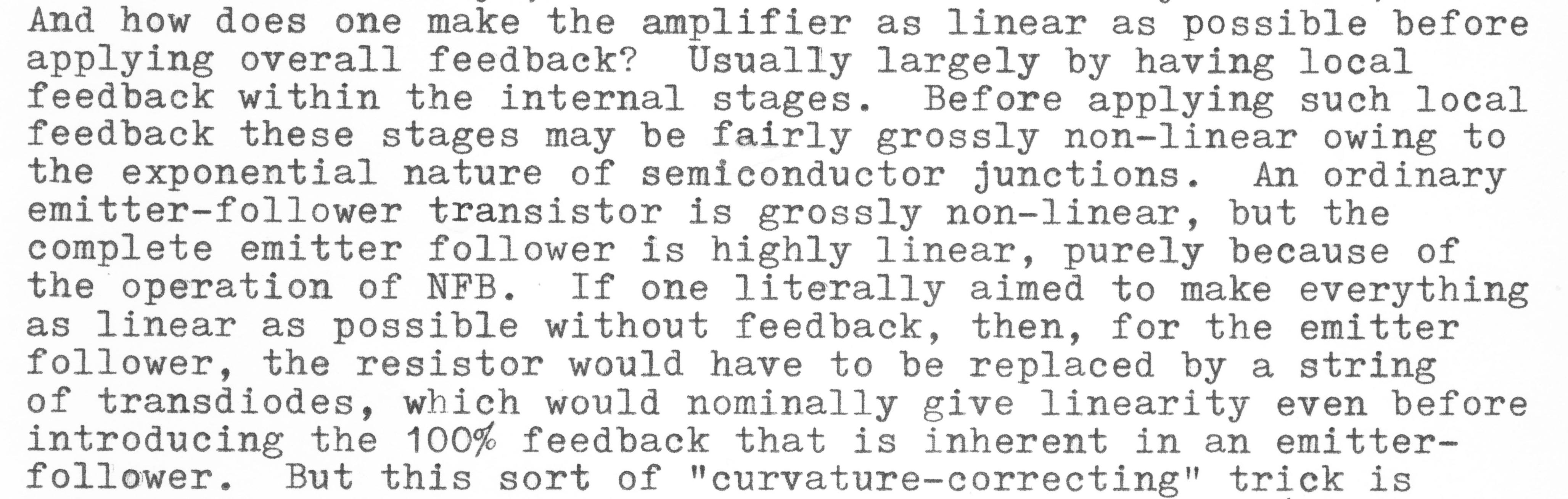

Gosh Jan, that's swell of you. But there's a dozen other guys on this thread that are willing to hit you over the head with gold-standard textbooks and meter-long equations who will disagree with you to the death.
Funny thing is that I never have the fortune to see these books and equations. I just have to *assume* they do exist.
Maybe I should show good faith and start with some 'gold standards' myself.
The name Peter Baxandall ring a bell?
(This is a small excerpt from "Baxandall and Self on Audio Power", Linear Audio Classic/collected papers, to be published).
jan.

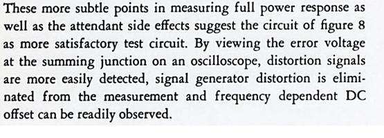

Several popular early audio power amps were just that, big power op-amps. The app note discussed slew rate in the context of full power BW and distortion. The amount of stretch is a matter of opinion.
Gee Scott,
Like I said we disagree. But to be clear I assume we are talking about http://www.analog.com/library/analogdialogue/cd/vol1n3.pdf#page=1 This is a very good article about op amps in general.
The discussion of full power response is very good and applicable to the op amps of the time. It discusses slew rate limiting primarily due to the output transistors' limits.
That certainly was a problem in very early solid state audio amplifiers. But the issue with earlier stages being the limit was to my way of thinking an evolutionary development and credit for broadcasting that belongs to others.
So we will just disagree.
ES

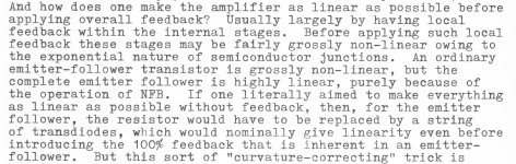

jan.
Jan,
Then the issue is strictly over wording. Today it is more common to have multiple discrete feedback on stages of the over all system. If we call the cathode resistor style local feedback, then what do we call the stage by stage discrete feedback?
I like Nelsons term of degenerative feedback. It really is more accurate. The reduction in gain is done by changing the way that stage behaves in more than just gain.
But you are free to use what ever labels you like. Of course my pending article on feedback will get confusing without clear labels.
ES

Ed please allow for the sematics of these early papers. It is clear to me what they are talking about, the output of the Vas. If you read on distortion at the input summing is directly mentioned which is the key idea in input stage non-linearity and the ideas that followed over the years.
Scott,
We really do see things differently. I read that same material as meaning the inverting input of the op amp is the summing point as shown in figure 8!
But I think it is a really good paper... are you going to argue with that?
ES

Scott,
ES
Jeez Ed what do think I mean?? You're losing me again, that's exactly what I meant. You make the op-amp reproduce a triangle wave and you see a square wave at the inverting input, etc., etc. This is a direct observation of what you are making the input stage do i.e. for slew constant current into Cdom, so you tilt the input with a "DC" voltage.
EDIT - I did edit for clarity before you replied. Now that you made the same observation, I don't see how you don't see it. Just put a divider to the error voltage and you get Bob Pease's proof the the low THD of Nationals latest op-amps. Old ideas never die.
