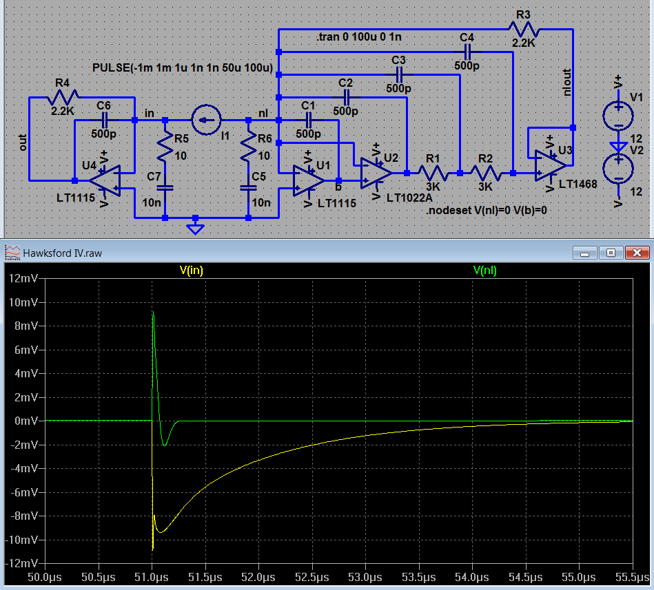

the amplitude and area of the switching transient Verror at the op amp input driving the diff pair into nonlinear operation is the fundamental mechanism Malcom models as the error source for feedback I/V
smaller steps, working into the tanh, ~3rd order BJT diff pair nonnlinearity give ~ 8^2 = 64x less distortion with 8x OS
we can also use ~10x faster op amps today than a unity compensated 5532
fet input op amps with their more linear inputs are available too at these faster speeds - but the audio noise performance isn't so good
and I can't understand Analog Devices "hiding" the new input linearization - not crowing about it, linking the patent, showing the input gm linearization for the AD8099, ada4898 families - could be today's best DAC I/V single op amps as I read the specs
Hawksford even proposed much higher feedback multiloop DAC I/V in his paper (my op amp choices in the sim - Malcolm used TL074)

but the adequately linear, somewhat recent ladder DACs support reasonable 8x -16x oversampling - which directly reduces step size for CD band limited music by the ~OS factor
http://www.essex.ac.uk/csee/researc...Current steering transimpedance amplifier.pdf

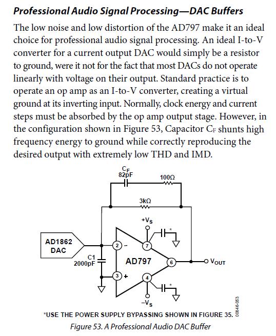

Here's one option, maybe a bit long in the tooth...

I might be in need of a little education here.
Looking at the schematic, I would say C1 shunts high frequency input to ground. Cf is a shelving high pass in the feedback loop, so that would translate into a shelving low pass for the unit.
However, the text says that Cf shunts high frequency to ground. To me, Cf would seem to filter out some high frequency; not by tying it to ground, but because of its place in the feedback loop. Me no comprendo.

Try Google for PIM distortion. Jargon is just a method to confuse the uninitiated.
Bob Cordell does a very nice job particularly in his book of presenting a lot of good basic information. Sometimes verifying or going beyond it is useful.
Perhaps you could say it shunts to virtual ground.

Scott,
vac
It's called a "typo". Happens to even the best companies.
