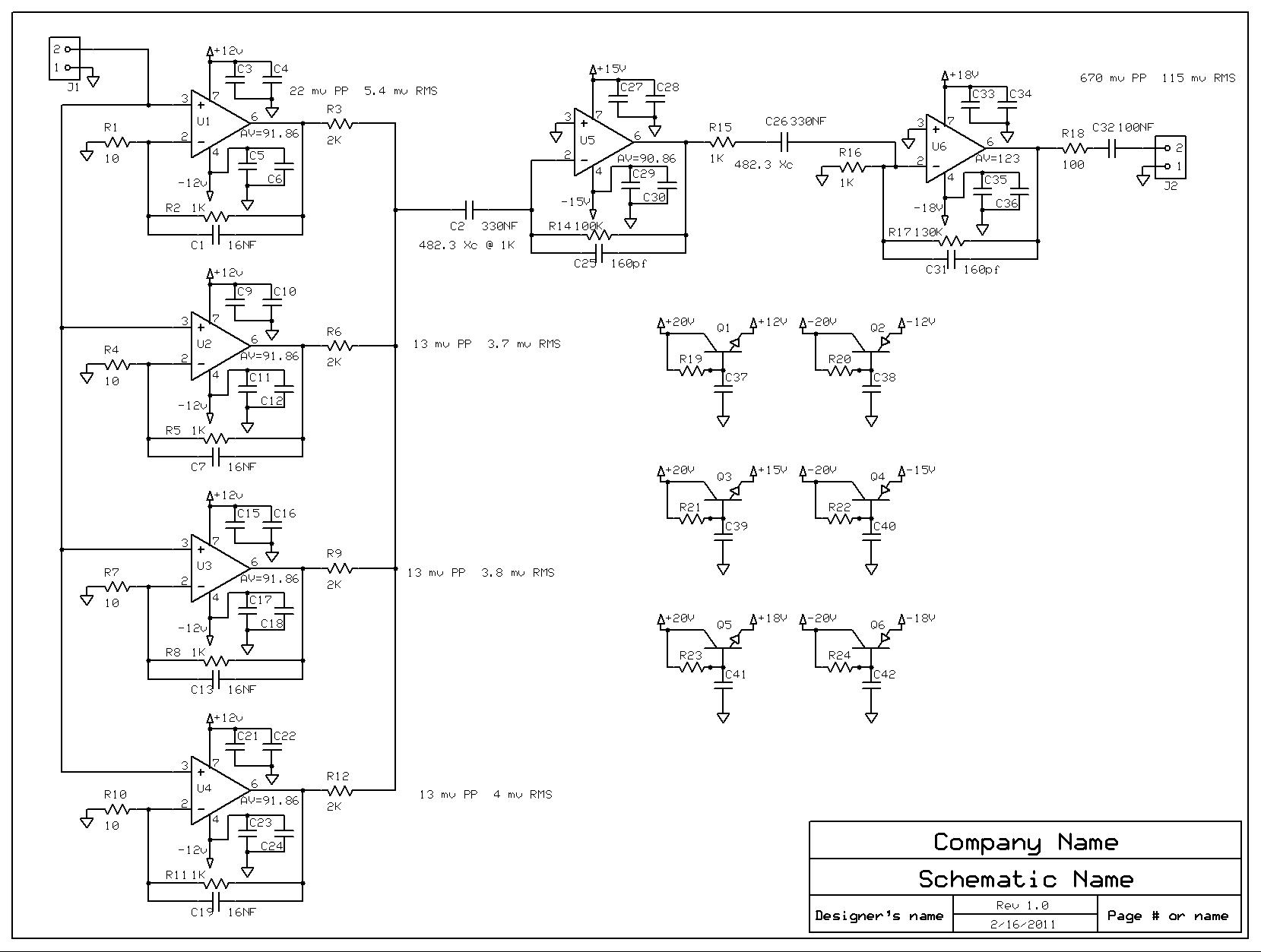

And I decided to build a high gain preamp using IC's. I paralleled four for the input stage, but when I checked one of then was noisy so I removed the resistor that added it to the mix. I had soldered all of the low level IC's to the board as I wanted to avoid possible socket noise issues. Noise values are shown.
Not narrowing of bandwidth as I did not want to look at LF and Flicker noise and too much HF is just as bad.

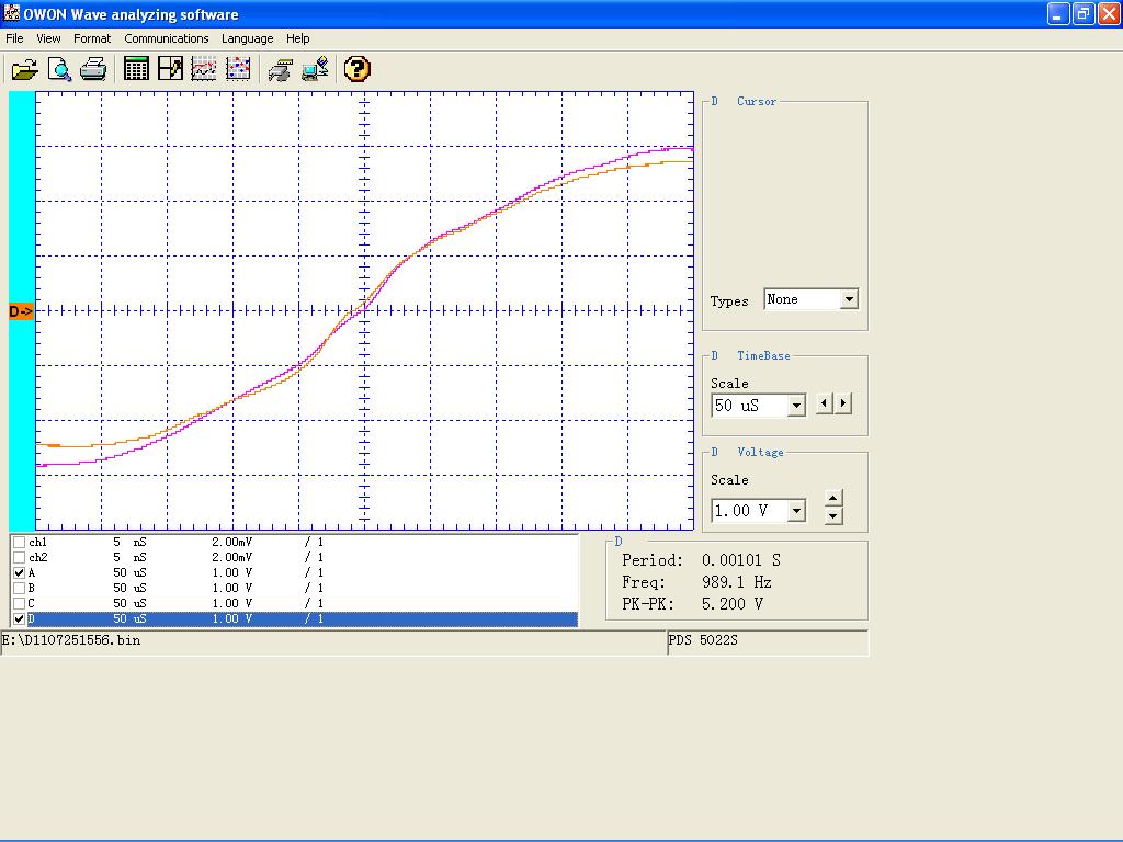

Well I soldered a jumper from the out put of the AP attenuator to the input of the preamp. I averaged 128 samples on my scope and then tried the same with a Sprague 1000/16 electrolytic (Large Axial Can) capacitor.
Anyone can interpret this however they want to. The curve with the lower peak is the signal after being passed through the capacitor.

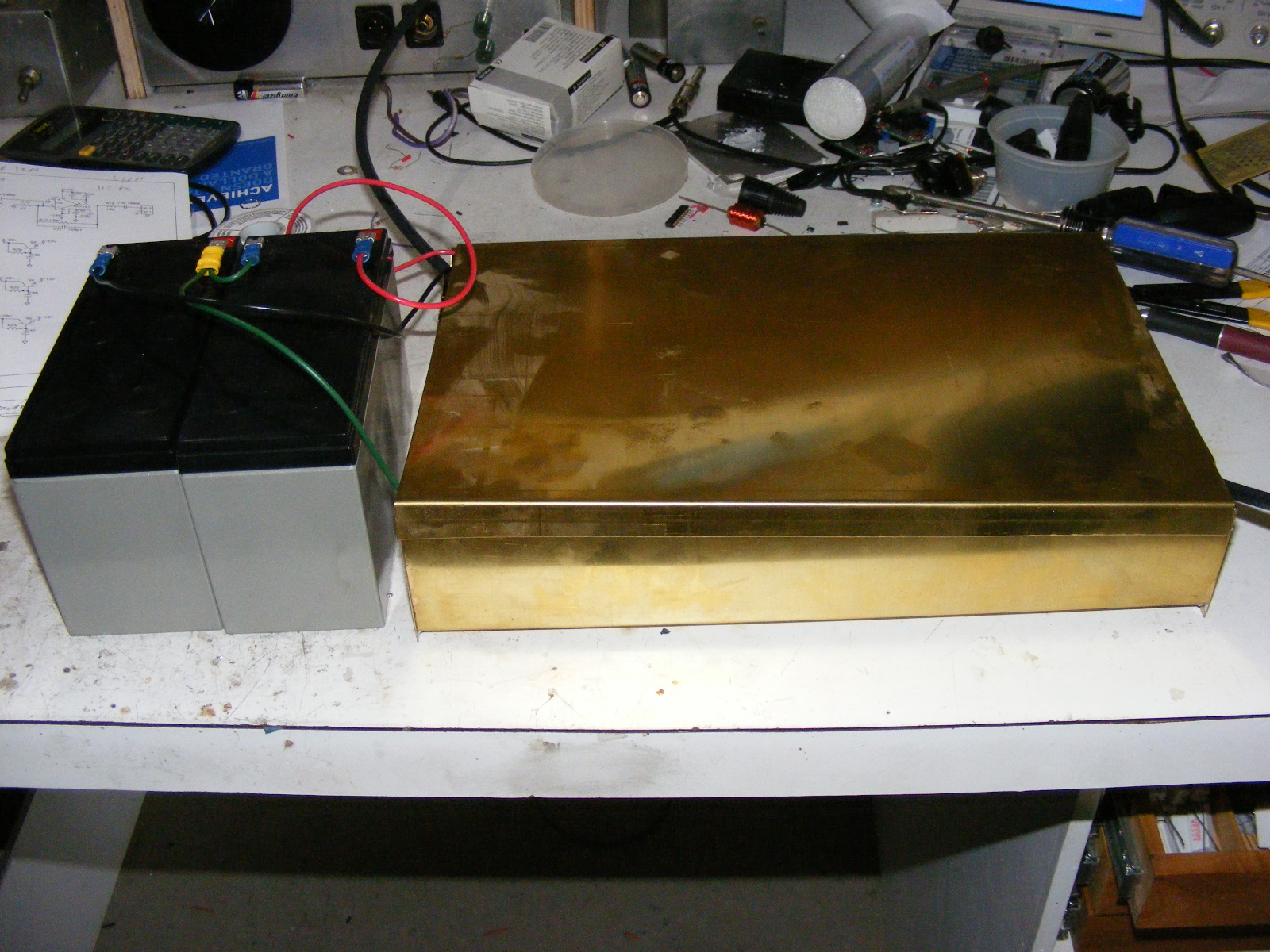

As a note the preamp is powered by batteries and the scope is feed through an isolation transformer.
The sub chassis inside the big box are also isolated.

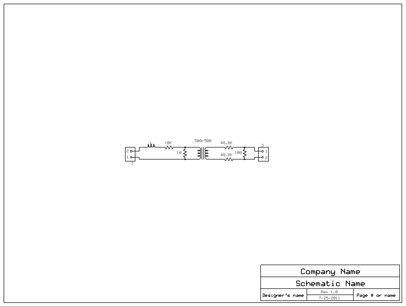

Well to drive the high gain preamp I needed a very small signal, so I just made an attenuator to take the output of my AP System 2 and drop the level and provide isolation. I also added a small LC (forgot to show the .01 C)

I interpret it as "both traces look like followers of the Caliph Ali", one seems to look a little worse and shows extra attenuation.
I'd like to see the result of a multitone test looped back into the AP2...

Both traces do show issues. Keep in mind 1 volt on the scope is really a bit less than 1 uv.
The source resistance is 100 ohms so the noise from that should be around 100nv.
The level is well below the AP's resolution. I did check it after the transformer and if I find the data I will post it.
The transformer distortion is not showing up as a significant issue.

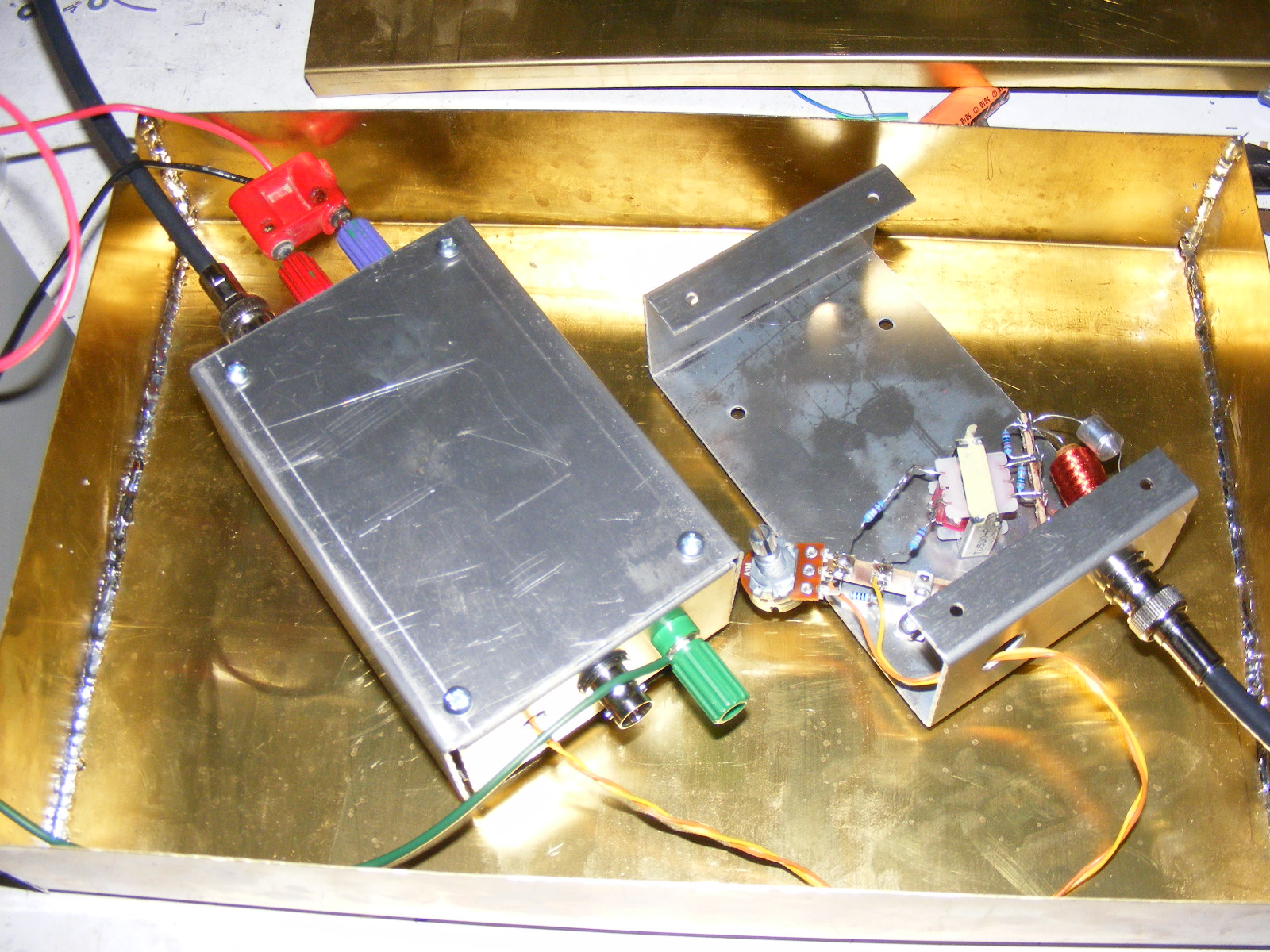

Hmmm, seeing your unshielded transformers I am uncomfortable about using the setup. I only ever use mu-mel laminated and mumetal shielded transformers in my Jigs, even so noise pickup by the transformers remains a problem...
That would depend on the precise transformer and the levels involved... It can be quite significant, hence I raise it.
I made a preamp recently, for my 'scope, so I could add resolution below 1mV/div. I used a single 2SK369 and a 9V battery, two resistors and three caps in a metal can internally shielded with Mu Metal. No transformers.

I keep Jensen SSM... around just for isolation, their mu metal and my 3.2 mm mild steel case. I will flip one of those in and the cheapie out for my next experiments. But I did look at the stages as I built things.
Next up is a slowly rising sine sweep of the Devices Under Test. But I do have to play with a few connectors etc at this test level.

Hi Simon,
Glanced over your schematic and my eye got caught by U5. I might be missing something, but should inverting input of U5 not be also connected to ground through resistor, like R16 in the case of U6?
