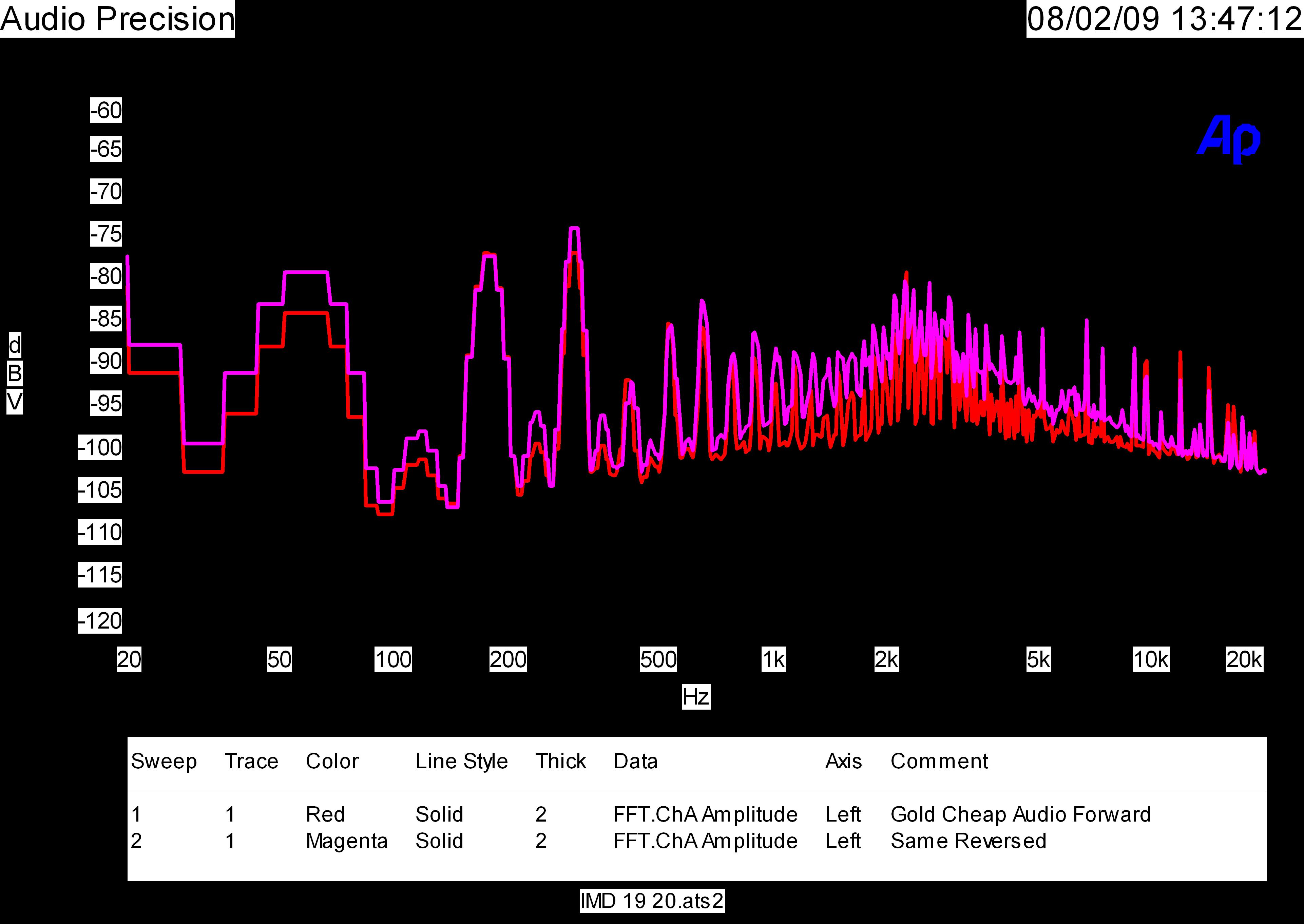

I really didn't want to show this again, but here is a different measurement and technique. The 60hz also shows up even though there is a BPF around the 2.3K of interest.
All of the interesting stuff is below the limit of the AP by itself!

If everything is testing the same then your test probably is not sensitive enough!
Your opinion of course 🙂. JC is claiming levels far above what you show here also the more sensitive the measurement the more subtle the unknowns become i.e. even the AP2 will fail at some point and you end up with just the same situation at 20 or 30dB lower levels.
You would do well to repeat the above graph with a couple of instrument grade oscillators.
Scott,
My original goal was to see if lead free solder had more distortion than the 63/37 that I was using. I spent quite some time on it. Prepared samples of 200+ joints of four solder types and was able to determine that there was no significant difference. In developing my measurement instrument I did try conventional oscillators using the dbx vca as my feedback control element. I could get very nice low distortion but keeping everything working was a real pain. I could get the same results on the samples I tested but it was not as reliable.
I then tried re-soldering all the connections on an audio PC card and found that did result in significant and measurable differences. I attributed that to filling in the vias.
It was an interesting side effect that different audio cables showed different results. It was completely unexpected that reversing cables showed consistent but sometimes different results. I presented my method for making the measurements along with some brief examples of results so that anyone interested could pursue it.
I have also presented the spectrum of the transversal filter oscillators that I used. The results I got on solder and cables do differ and do not show what I would expect from oscillator issues. That is OPINION and yours may differ, that to me is not an issue worth pursuing at the moment.
However my quest was for solder information. I have that. I have also measured resistors and capacitors. I am currently working on contacts and how feedback influences distortion.
The second plot shown is roughly 60 db below the first data plot. (0db is approx .38 VRMS) My design goal for audio is 160 db S/N. So audio interconnects properly used will meet that design goal. I can pick resistors that meet the goal. I can pretty much avoid capacitors, so they are not as important. In my OPINION that is audio engineering, not science research. Confirming the results and determining the mechanism is to me worthy of a PHD, anyone who would like to pursue it is free to do so.
I have not examined J.C.s setup or determined his actual operating or measured levels. He is looking at THD I look at IM. He is entitled to his OPINION and to do things his way for his work.
