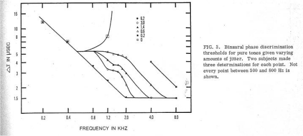

Nordmark actually measured the impact time dither had on lateralization resolution on human subjects. Attached is one of his graphs. Note the dither is actually in microseconds.

ITD ???
not too relevant as far as I can see - the ITD tests define "jitter" as the advance/delay applied to an entire bandpass filtered pulse, changing values only for the next pulse at up to high single digit hundreds of pulses per second
additive amplitude dither changes value randomly every sample, for the ms time scale pulses of the ITD tests there is no net shift from TPF amplitude dither
noise shaped additive amplitude dither has even less spectral energy sub/low KHz
in fact a later ITD paper adds ~ -60 dB amplitude noise to mask the possible time delay filtering amplitude/offset error correlations
Yo, dude!! He wrote about jitter, honestly I don't know how he obtained it.
I figured it was consistent with the discussion, so don't shoot me...
edit..oh sorry, I forgot the context.. I've read some research which seemed to indicate humans used zero crossing for timing information..adding a dither signal would cause jitter in the zero crossing..so I therefore considered Nordmark as consistent with the discussion..
