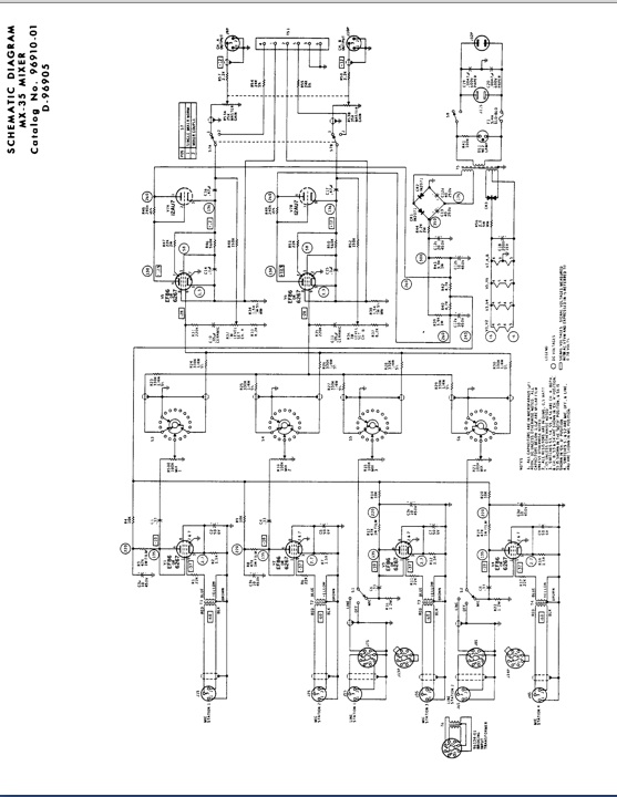

What are you talking about? You have never heard of an Ampex MX-10 mixer? Before your time, and mine, even, but they sound pretty good.
My experience with live rock music is not hi-fidelity formost. We hosted an early Aerosmith concert, 11+.
The GD, with Ron Wickersham and Bear (Owsley) used the MX-10's, bypassing the second stage in some way. This is how they mixed the vocals for a few years. My job was to replace the MX-10's with something, solid state, that sounded just as good, yet was more reliable on the road, the tubes being sensitive to vibration damage. We did our master recording direct, from a splitter in the mike lines, and direct boxes.
