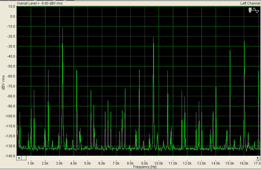

Jan, it was YOU who jumped the gun, WITHOUT making the calculations, and put in the WRONG notations on the disputed figures. Where is 2F2-8F1 for example? Where, oh where can it be? It calculates to 4.56KHz, does it not?
Where is it? Please tell me, or I will have to keep you 'after school' for insubordination to a person who is only trying to teach something here.

Jan, it was YOU who jumped the gun, WITHOUT making the calculations, and put in the WRONG notations on the disputed figures. Where is 2F2-8F1 for example? Where, oh where can it be? It calculates to 4.56KHz, does it not?[snip]
Its in post 971: 2F2-8F1 4k56. Just turn your head 90 degrees and you can read it.
jd
Please look again, Jan. What you thought was 4.56K is really 4.99K. Just look at the graph, not just Jan, but everybody! Can't you see that it is NOT 4.56K? You made an oversight, Jan. Look again, blow up the graph, if necessary, look at Gerhard's work for comparison. However, please realize that an error has been made in where these frequencies come from.

I'll give you a hand, if we speak about this image:
The circled blips seem to be:
|2f2-9f1|=1380
|2f2-11f1|=4980
|2f2-7f1|=7740
|2f2-13f1|=11340
|2f2-5f1|=14100
which is to be expected since f1 is a square wave (odd harmonics). 2f2-8f1 is below range.
